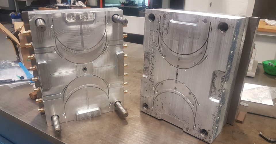

Rutland Plastics’ Technical Manager Carl Martin says they were originally asked to 3D print a number of headbands for the shields, but decided it would be more cost effective to manufacture a mould tool using their VISI software package, and then injection mould the plastic product from it.
“We received the initial design for the 3D printed product, and modified it in VISI to make it injection mouldable. Once that was completed and approved, we designed the tool in VISI using a Meusburger bolster with aluminium bolster plates.”
The design then went into the toolroom and was milled on their Mazak VCN 530C CNC machine with toolpaths created through VISI’s extensive CAM functionality. The process from taking in the initial 3D design, through turning it into a mouldable product, and finalising the mould tool, took less than a week.
When the two-impression mould was setup on their 80-tonne Engel moulding machine, both parts of the headband were formed from a medically-accredited polypropylene every 24 seconds during the production run of 25,000.
