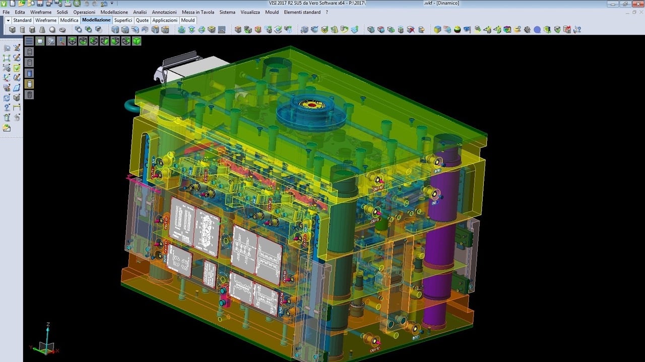

VISI Mould is used to carry out the design, while electrodes are modelled and machined with VISI Machining 3D, which is also used for cutting plates and moulding parts, along with Machining Strategist and VISI Wire.
“Our in-house team follow the mould design, adopting various solutions for mould movements, conditioning circuits, injection and extraction systems,” he says. “In order to optimise the final product and the moulding activity, we pay precise attention to the analysis, proposing possible improvements.”
He says VISI is used in the preliminary stage, before the design process begins, to analyse details such as drafts, undercuts and thicknesses, and to draw up possible dimensions of the finished moulds. “We import customer STEP, IGES or Parasolid files and analyse the geometry in depth, to define the quality of the mathematical model, while correcting incomplete or inaccurate geometries.”
They move on to create the mould basement and define details, before sending the component parts to the different CAM stations for milling, wire cutting, and electrode modelling and construction.

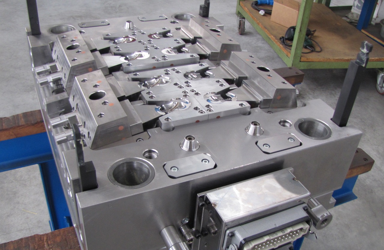

He cites an example of a stainless steel mould that Mecca TP have developed to replace an existing mould used by a medical sector client. “The mould was to produce a small circular component with a diameter of approximately 40 mm. The part had to be moulded in a white chamber on eight impressions, in a complete discharge cycle of less than 20 seconds.”

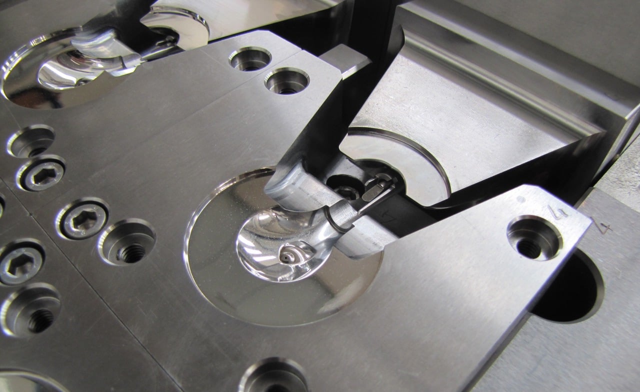

The product is described as being complex, with irregular surfaces and a different front and back finish, and a shiny, mirrored surface on one side. “We created a completely new movement, very different from the mould originally being used by the customer.
“Our proposal optimised the intrinsic characteristics of the impressions, and the operational flexibility, ensuring the highest level of productivity. Each imprint has a completely interchangeable matrix and punch, which are fixed to the mould by screws. This means we can replace them when they are worn out, without changing the entire mould, even if the mould is inside the machine. It also means we can produce different products using the same mould.”
He says the main challenge was to find a way to free undercuts; also, to create the movements necessary to obtain a high quality piece – moulded from soft adhesive PVC – in the correct way, avoiding possible wastage.
The team used VISI Analysis to import, prepare and validate what was required. “Being able to identify complex mathematics in advance let us discover critical areas at an early stage of the project, and greatly simplified our work. It also leads to a significant reduction in both design and production times.”
Pointing out that VISI Mould handles the entire design process, he says it provides them with specific automation that guides the operator throughout the project’s development. “It’s a simple procedure, with the help of numerous catalogues of main suppliers’ components, that facilitates everything we need.”
VISI gives them the capability of managing and graphically displaying mould creation and any required changes in real time. “This means we can check the results immediately and effectively, giving us maximum design freedom with the complexity we have to face in order to satisfy our customers’ ever-changing needs.”
