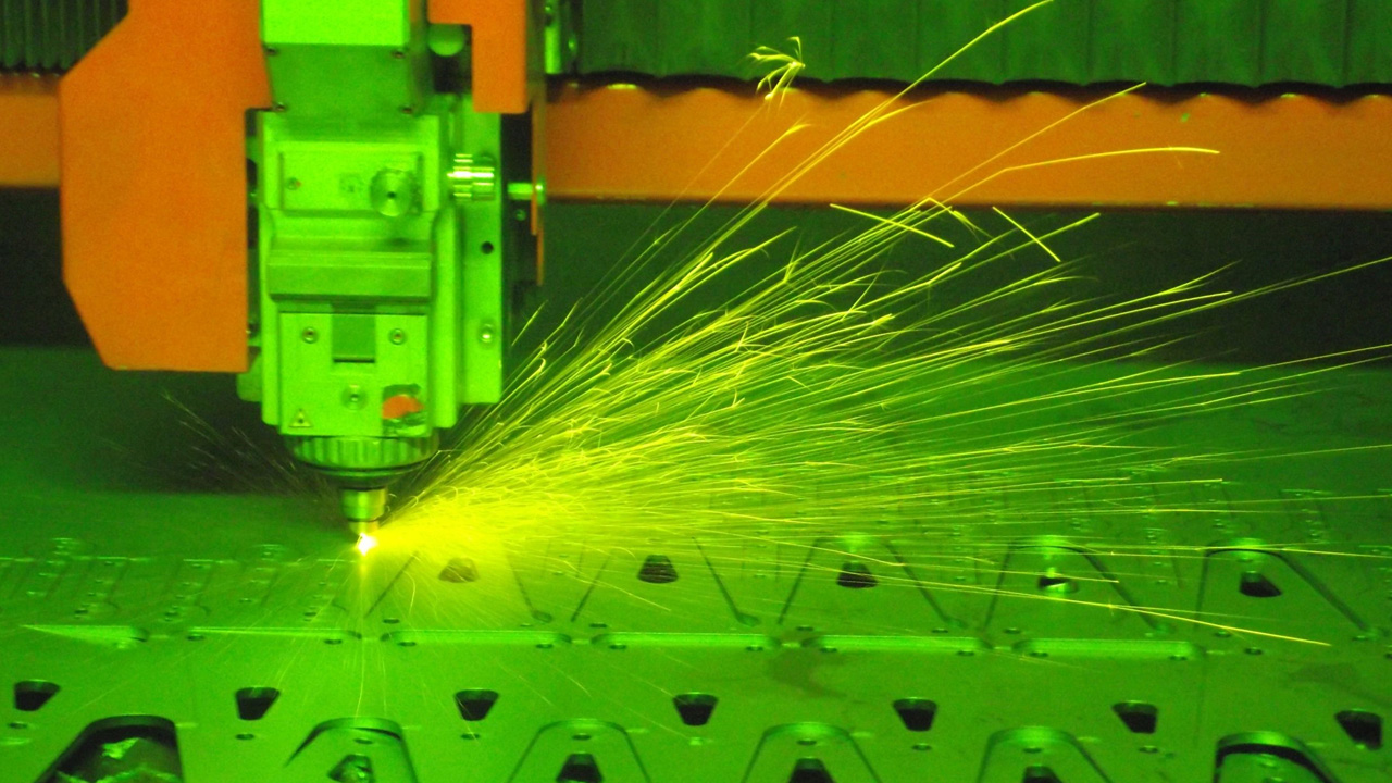

They also log the reason for every scrapped part, and he says poor sequencing was the biggest single cause under the old system, which wasn’t producing the high standard they require. “With the large number of parts we produce, it’s impossible to go through each nest and manually select the cutting sequence…we have to rely on automation. We ran the same job through RADAN – and I even tried to trick it, but it was much better at getting out of areas without crashing the head.
“RADAN’s not just about speeding our processes up, it’s all about accuracy, both in terms of the cutting sequence, and the finished component.”
Another test involved a production job of 400+ runs of 3mm aluminium parts in RADAN. “This particular job had ‘head collision’ written all over it. But RADAN cut each sheet 52 minutes quicker than the old system, and with no collisions. When I looked at the code I saw this was because RADAN was able to cut at full speed, while the other software applied slower cutting conditions for small features. This could save us considerable time.”

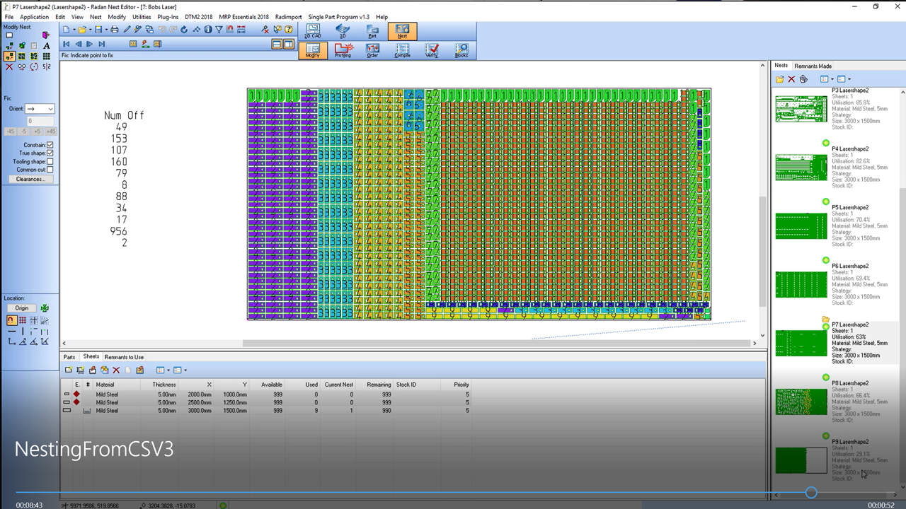

Jason George has also created a Part Editor application to mass edit components. “It automates RADAN’s powerful functionality to work on multiple parts at the same time, and means we can mass import DXF files and edit the data quickly. This is particularly important as we work on around 20,000 live items every month, and have nearly 200,000 repeat parts in the system.”
Their first task when an inquiry comes in, is to add a quote in Epicor. “We’ve got a button in Epicor that says ‘Prepare RADAN.’ This generates a quotation folder for us, a standard project template ready for the nester to nest in, and sub directories for the parts. Then we’re ready to start drawing the part in RADAN 2D. The parts are imported and saved in the Quote Directory, which means quoted parts don’t touch our Master Part Library. With the previous CAD/CAM system we had a bulging part library containing parts for jobs we didn’t win, and never cut. So this is a huge improvement.”
After that, they use the Part Editor app to set customers, materials and machining operations including any required countersinking and folding. This is followed by another customised operation, running what they call The Migrator, which scans the entire project, calculates how long each part is going to take, and the exact per centage of a sheet it will use. “Migrator then populates all relevant fields within Epicor. When we win the job, it’s converted to an order, and Epicor tells RADAN which customer the parts are for, creating directories for the project.”
The nesting team use Workflow to specify the parts for nesting, and send them to RADAN. “It’s so simple to pull in the raw material sheets, nest them, post them, and send them out for cutting on our Trumpf and Bystronic lasers, or Flow and Techni waterjets.” He says it’s vital that RADAN drives both cutting technologies, and can work with a variety of CNC machine tool brands. “With RADAN we just have the one Part Library which services all our machines…we couldn’t have multiple part libraries for the same components.”
