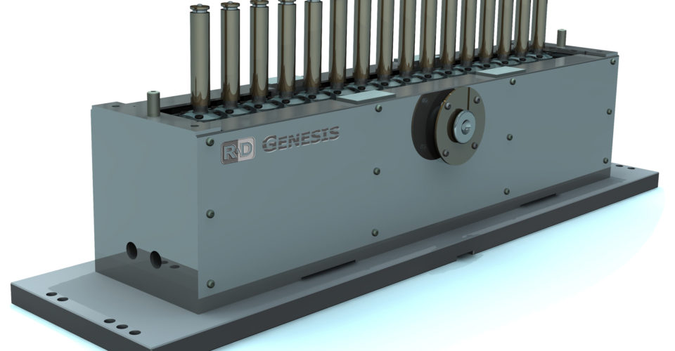

R&D Leverage is the world’s largest independent solution provider to the single-stage Injection Stretch Blow Moulding (ISBM) packaging market sector, offering the global plastic convertors and consumer product brand owners what Andy Phillips calls a “complete solution” for a range of ISBM machines.  Its tools are designed and manufactured using the highest quality materials. All tools are made in-house, on a vast array of the highest quality CNC machines: “The tools then go into our dedicated Product Solutions Laboratory (PSL) for testing, before we release them to customers.”
