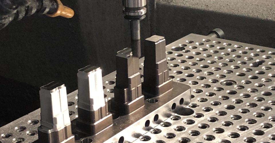

Production Director Mark Cole says some components are particularly time-consuming to set up traditionally on machines…and even simple parts mean the machines are idle during set up. But Kavia’s unusual use of the Hexagon CMM means the machines are cutting another job while the set up for the next one is being carried out.
“Hexagon customised the flexible PC-DMIS software which comes as standard on their measurement devices, to enable us to use it to find offsets at the beginning of the operation. Instead of having to put each part on the machine and then set it, we set it on the CMM which gives us the X, Y, Z, and U orientation. We only have to put the Zero Transfer Plate, which is micron-accurate, into position on the machine, and it knows exactly where the part is.”

The end result of using Merge with the Zero Transfer Fixture Plates created on the CMM is a CNC program which can machine several parts at a time without the need to use the machine as a set-up station, as all preparatory operations are carried out offline. “If we were setting up a component to be square, directly on the CNC machine tool without the CMM, we’d have to ensure it’s perfectly in line with the machine’s axis. Doing that for ten components considerably increases the risk of error, especially where there are overhangs. But setting them on the CMM means everything is automatically correct, because it tells the machine the angle of each part.
“To set up six fairly difficult components directly on the machine may take one day, during which time it’s not running. But it’ll only take about an hour on the CMM, and we can be confident that they’ll all be absolutely accurate.”
