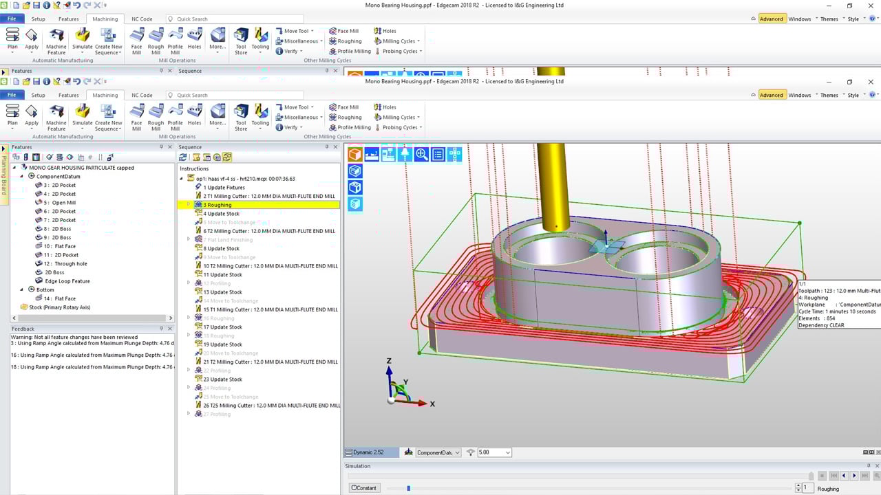

He says the software’s milling and turning modules ensure they can ship between 600 and 700 components each month, normally on a three to four week lead time. “EDGECAM is so simple to use. The customer sends us a STEP or IGES file, or any other CAD file, which we import into EDGECAM and create the fixtures and fittings, identify the CNC machine we’ll be using, and the stock. Then we run Feature Finder to identify all the features of the parts, and generate toolpaths.”
He adds that machining processes are considerably more stable now than under their previous CAD/CAM package. “With our old software, when the cutter was coming into a corner you could see the machine loads spiking, which we don’t get with EDGECAM – we can run programs overnight, rein the stepovers back and know the tooling will last for the entire production run.”

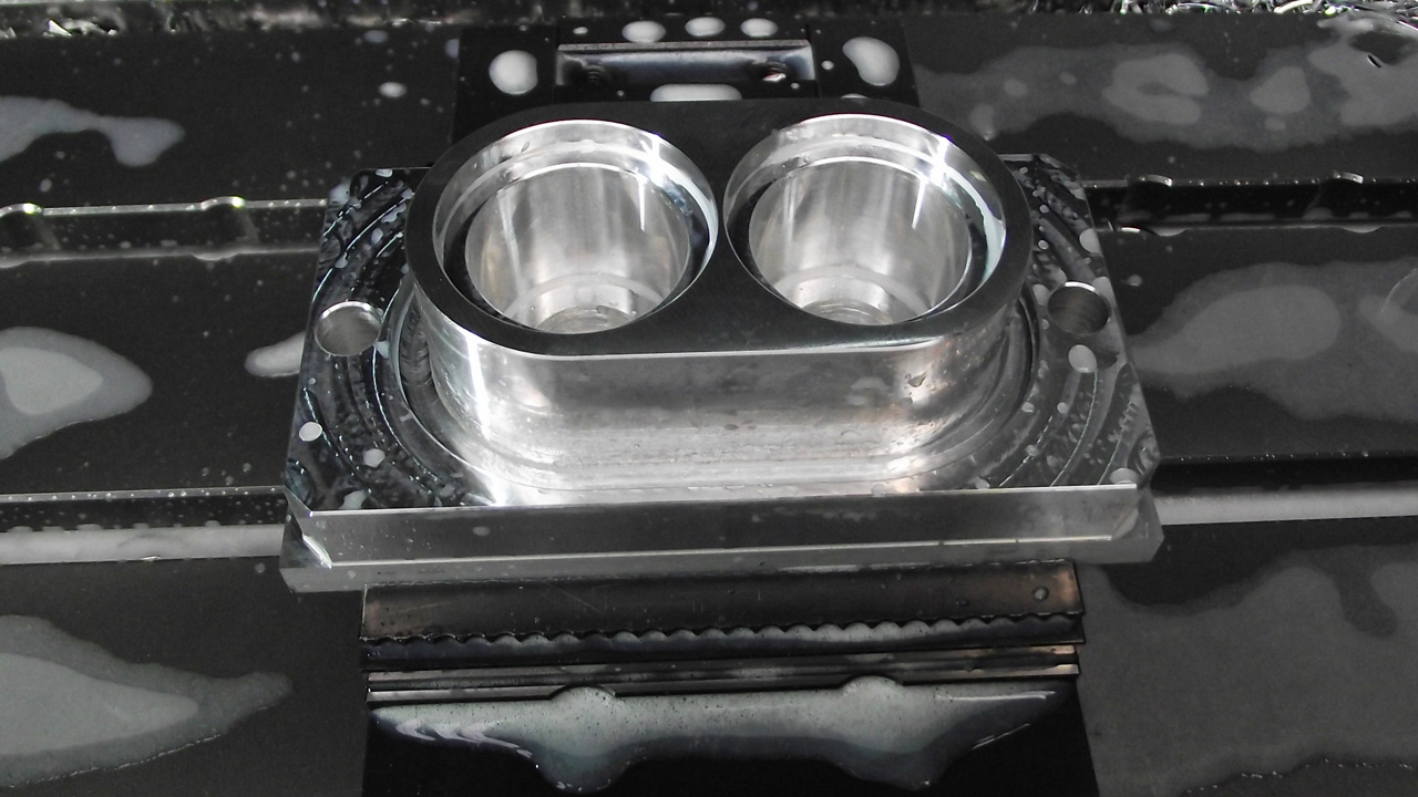

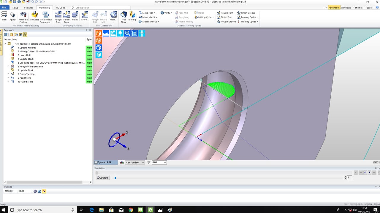

And he describes EDGECAM’s powerful game-changing Waveform Roughing capability as “massive” for the company’s growth plans, in terms of driving down cycle times and increasing capacity, enabling them to take on additional work. “We do a lot of 3D milling of features such as pockets, and we used to machine the roughing cycles in the traditional way, often just stepping down 1mm at a time. But EDGECAM allows us to step down up to 10 or 15mm at a time. Then as we pocket out to those depths we can profile back and come out of the pockets. So it saves considerable time.
“At first, when those programs were coming in from Seco Tooling, we were concerned that the increased feeds and speeds would break the tools. But then we saw how well they worked, and it now gives us the opportunity to push the machines to their limits.”
He cites a project where Waveform slashed the roughing cycle from 30 minutes to ten minutes, and helped reduce the overall machining time by half. “We manufacture a particular component for the atomising industry, which is used to turn metal into a powder for hard surfacing materials. Traditionally it was a turning job. But Waveform means we can now mill the grooves. This was a huge revelation, and made us think of doing jobs in a completely different way.”
