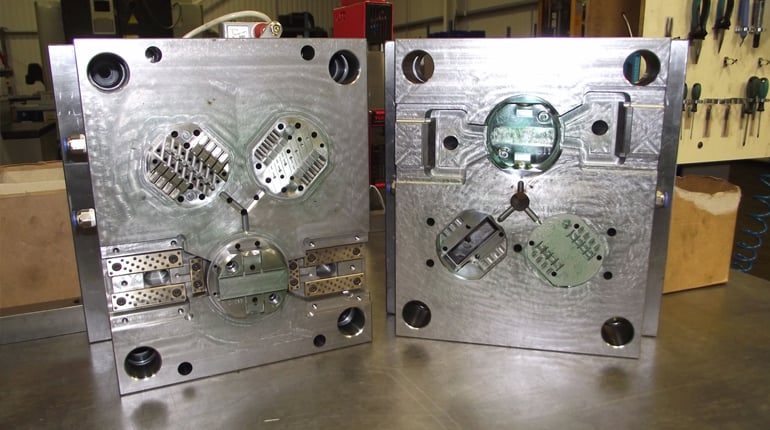

Working out of 9000 square foot premises in Burnley, with 15 employees, the company produces around 80 mould tools a year for plastic injection moulders, ranging in size from small tools of 156 mm x 156 mm, anywhere up to 2-tonnes.

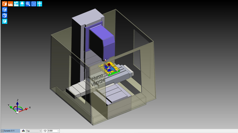

Edgecam drives seven high-speed CNC mills with spindle speeds varying from 12,000 to 30,000 rpm, and Sodick EDM machining, but Production Director Mark Cole says it’s no ordinary machining process. “Edgecam have customised the software to create a system for us which we call Merge. It means we can put several components on the machines at once, and the Edgecam CNC code for them all is merged into one large program, along with the datums to set the parts on.”

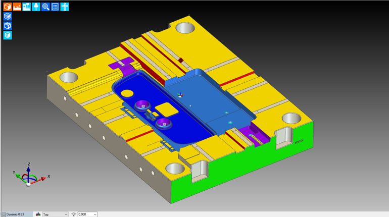

He cites a recent example when they were working on two cavity plates on one side of the machine, and four inserts on the other. “We put the individual Edgecam CNC programs for each component together into one file, and it all went to the machine as one large program.”
It also keeps the cutting tools to a minimum, by looking at information such as duplication, length and quality of the tools in all the programs. “For example, if there were two repeating cuttings tools in the individually merged programs, it selects the best one for the manufacturing process. It goes through every single NC program and rearranges all the tools accordingly.
“If we have ten components that can all fit on the machine, Merge puts the tool information for all ten programs together, the datum setting information, part setting information, the pre-setter …everything. So as far as the machining’s concerned, it’s just one big product.”

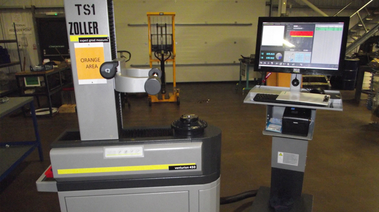

Edgecam engineers also worked with Kavia Tooling on customising the software further, to set tooling data for the CNC programs offline by utilising data from their Zoller tool pre-setter system. Previously, the operator had to manually set all the tools for each job run, with the same costs and risks associated with datum setting. “Now Zoller captures the required tool information for all the programs, and Edgecam merges it all into the final CNC file. It used to be a skilled job…now a first year apprentice does it.”
