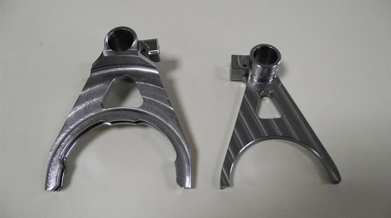

On a gearbox selector fork, for example, the cycle time was slashed from one hour five minutes down to just 38 minutes, and when tooling costs were also taken into consideration, the savings on that component were “considerable.”  And with a larger fork, his methods with Edgecam saved around half an hour on each individual item. Forecasts show that over a 12 month period the Edgecam changes will also lead to considerable savings on every type of gearbox fork they manufacture. “It all means we can offer farm more competitive prices to our customers.”

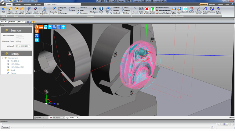

Those changes include bringing in solid models for programming and generating the features from the model. “We also use profile features, either generated from the Features Find function, or generated manually. When I came to the company the system was to input the values manually, which was time-consuming and prone to error. Now, the code is generated by associating the toolpaths to the features, so whenever the component is upgraded to the next version and the model manipulated – such as a particular diameter being changed from 32mm to 45mm – we just regenerate the feature and the toolpath changes automatically.”
But he says the biggest game-changer was introducing Edgecam’s powerful Waveform roughing strategy to Hewland, both for their milling and turning cells. “It’s now used for all our face grooves, groove turning, and full rad inserts, which has reduced cycle times dramatically.”
Previously, when milling their range of gear selector forks, a high feed method was used, with multiple face cutters for one component. “Those step cutters only lasted for three parts before having to be replaced.” He changed the manufacturing process to incorporate Waveform, machining 2.8 metres a minute at 4,200 rpm with a ten per cent stepover, which has reduced the number of tools required to cut the component. “We’ve reduced the cycle time by 20 minutes on stage one machining, and eight and a half minutes on stage two machining…which means we’ve saved around half an hour on each fork. And we cut around 23 billets per carbide, instead of three.”
Many of Hewland’s shopfloor workers were a little wary of Edgecam’s Waveform strategy at first, worrying that the ramped up feeds and speeds would break the cutting tools. “They’d never seen anything like it. I introduced it slowly, starting with a low revolution, then gradually increased it, until we got to a ten per cent stepover, and 2.2 metre feed. That was on EN 36 case hardening steel…so the team very quickly realised exactly what Waveform could do. I know we can push the machine even more, but this is perfect for our needs. It means the operator can leave the machine running while he goes on to work on another one.”
And those same operators now want Waveform to be the default machining strategy. “We have what we call legacy components, that were originally programmed a long time ago. The shopfloor are asking us to change the programming to Waveform, telling us they find it more reliable, reduces load on the spindle and wear on the tool.”
He says another Edgecam benefit is its ease of use. “We load the STEP file, and if it’s not a raw casting we generate stock through Edgecam’s stock library. Then we load a chuck if it’s turning component, or vice if it’s a turning part.” After that, comes what he calls the real power behind Edgecam – generating the features on the model before they start the programming sequence; loading the machine, and generating the toolkit, which in turn creates the set-up sheet that they use as their live job report. “We have everything within Edgecam; the stock, the model, chuck, machine, and toolkit. We simply couldn’t run our shop without it.”
