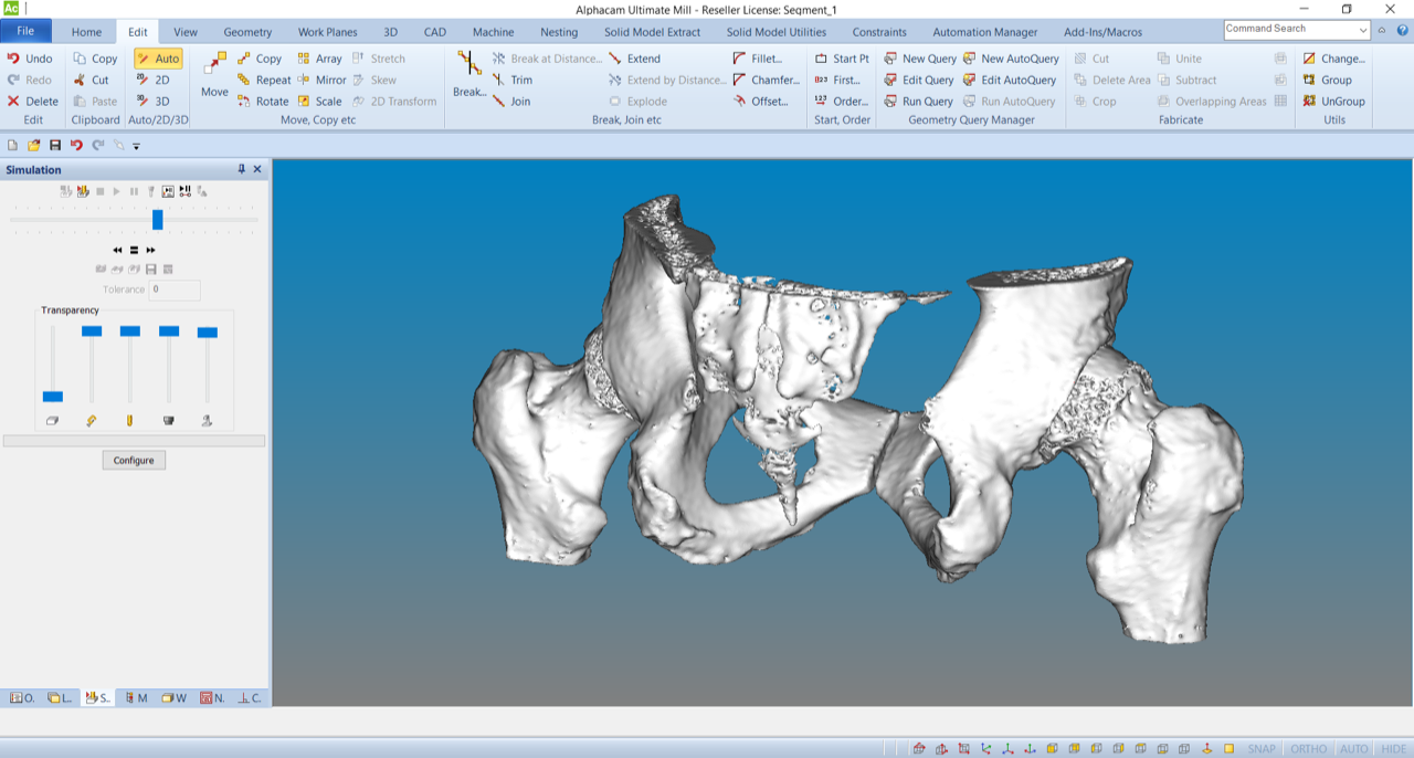

Generating custom implants at Jointmedica begins the moment they receive the patient’s CT scan, which allows them to start modelling the bespoke product.  They use two CAD systems to design the solid models – mainly Creo, and occasionally SolidWorks. The files are usually sent as an XT file, STEP file, or as a DXF file for the turning cycle in the lathe software.

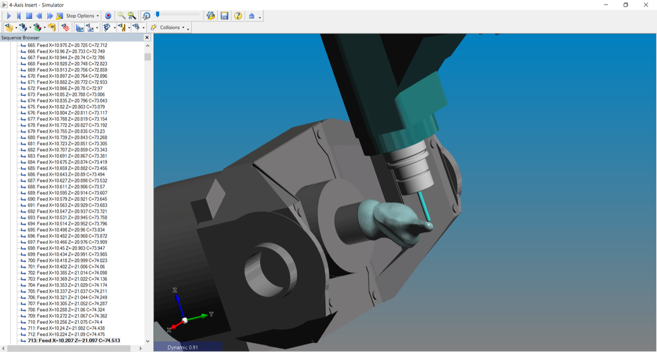

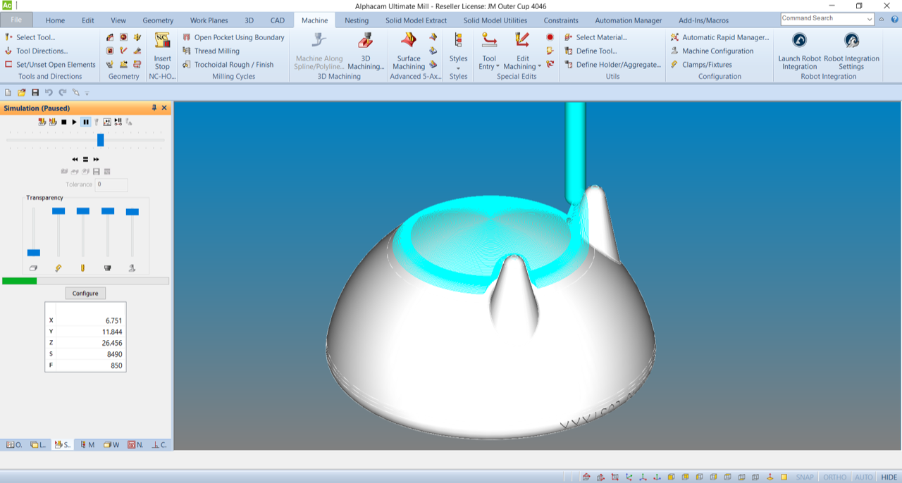

The company uses ALPHACAM Ultimate Mill and Standard Lathe to machine the finished product with the Brother capable of both turning and milling. Oliver Clayton, Manufacturing Engineer at Jointmedica explains: “I take ALPHACAM’s 3+2 system and incorporate it into some of the bespoke custom devices, and then an easier 3-axis and turning program definition on the cutting paths for a simpler, axisymmetric product. In the turning program I mainly use the CAD side in drawing the geometry and applying the toolpath. That’s extremely useful because I can incorporate not only the model, but draw my own toolpaths in there with the geometry.”

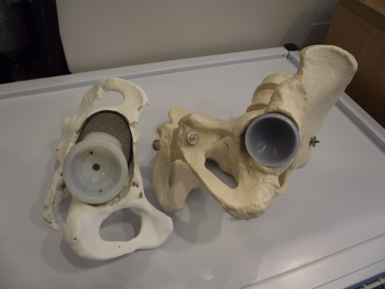

As an example, the materials for a ball and socket type of bearing, which work well when implanted in the body as a Hip Replacement, can include ultra-high molecular weight polyethylene of differing formulas, and a counter face of cobalt chrome, ceramic, or other material.
“Through accurate machining driven by ALPHACAM, material wastage is kept to a minimum, and we can also ensure the final, bespoke product is suitable for the patient.”  Oliver says it’s of the utmost importance that the implants are of the highest precision. “When we come to CMM measurements they must be dimensionally correct, and ALPHACAM ensures we get the right results every time.  When considering our prototyping expectations, we are comfortably achieving the industry expected tolerances, and a bearing surface finish of 0.8 Roughness Average for one-offs. We know that future production capability will significantly exceed these figures, and we are confident in the solution afforded by the Brother CNC driven by ALPHACAM.”

For Jointmedica, a particular challenge facing the manufacturing process was manipulating the toolpath to get the quickest machining time for a particular part. ALPHACAM’s ability to define the best cutting tools and toolpaths allow these to be manipulated to set the quickest timescale with the best path for the device to be manufactured accurately. Oliver concludes: “When I refer to accuracy, I don’t just mean the speed and accuracy of a geometric toolpath I put over a CAD model that’s come into ALPHACAM; I mean combining a number of different types of operations – the accuracy and ease of ALPHACAM coming in and picking up at a point that I’ve designated on the software, at a later stage on the product with an alternative type of machining method.  It picks up accurately, as verified with our CMM equipment, and it is always within the specified critical dimensions. This is a huge benefit.”
