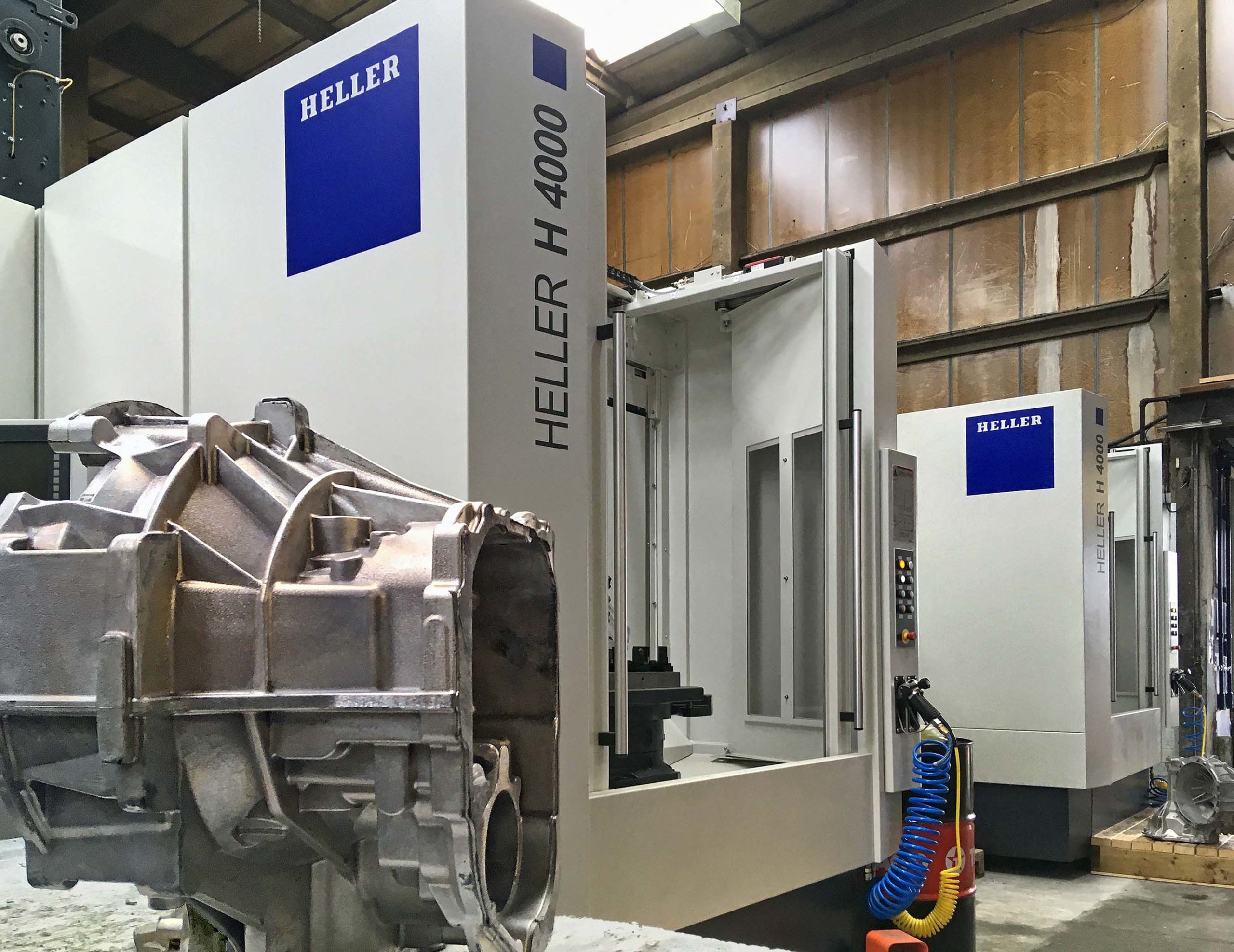

To cope with the extra demand, the subcontract casting and machining specialist is building a second die casting cell in Ashford, Kent, which is due to be operational in early 2020. Additionally, in September 2019 the company bought a second pair of Heller horizontal-spindle, twin-pallet production centres to machine the increasing quantity of components.

He added that the first models were Heller MCI16s with an 800 x 630 x 630 mm machining envelope, whereas the two latest models, H4000s, have a larger 800 mm cube working volume and are manufactured in Redditch, a fact that guarantees after-sales support of the highest level.

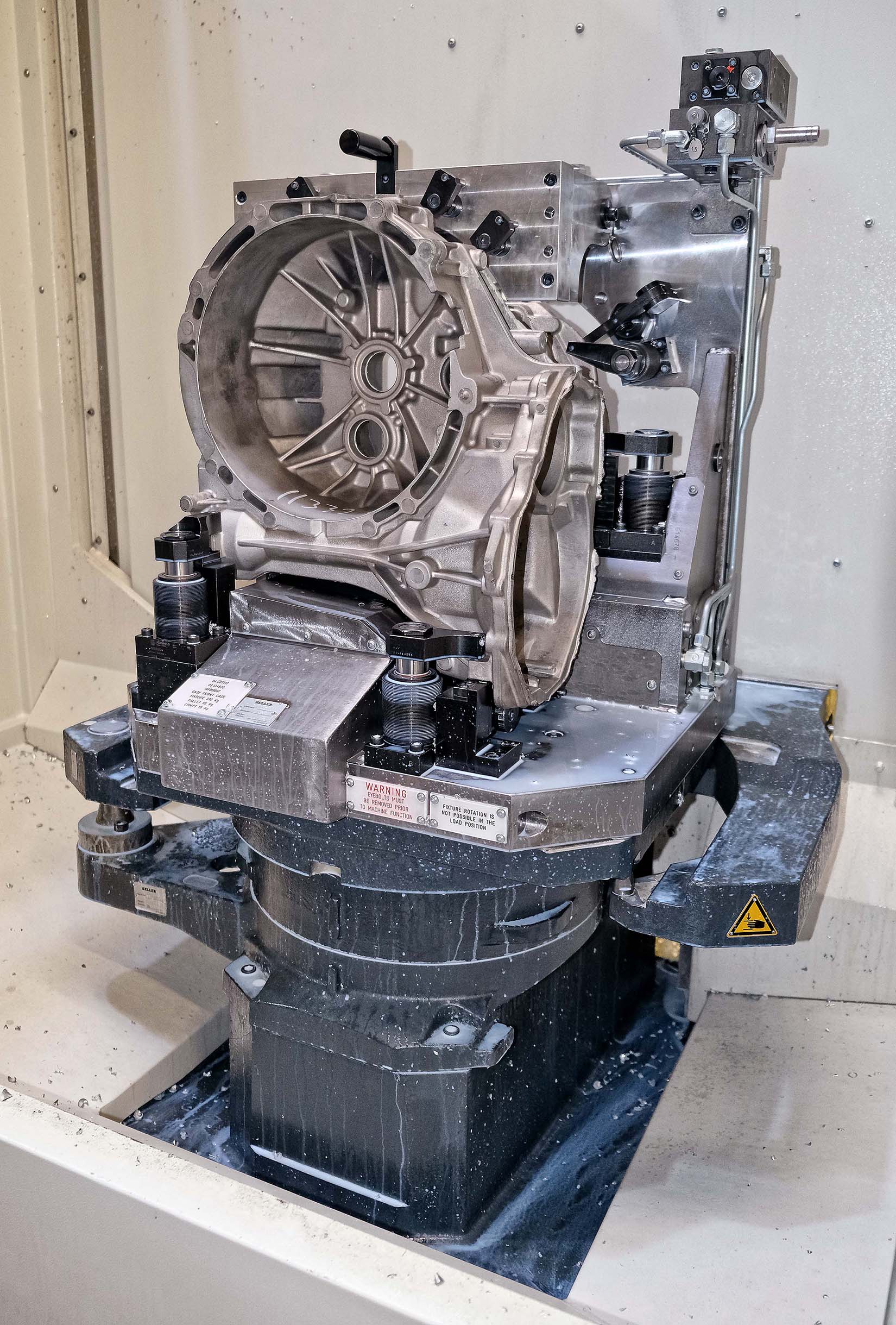

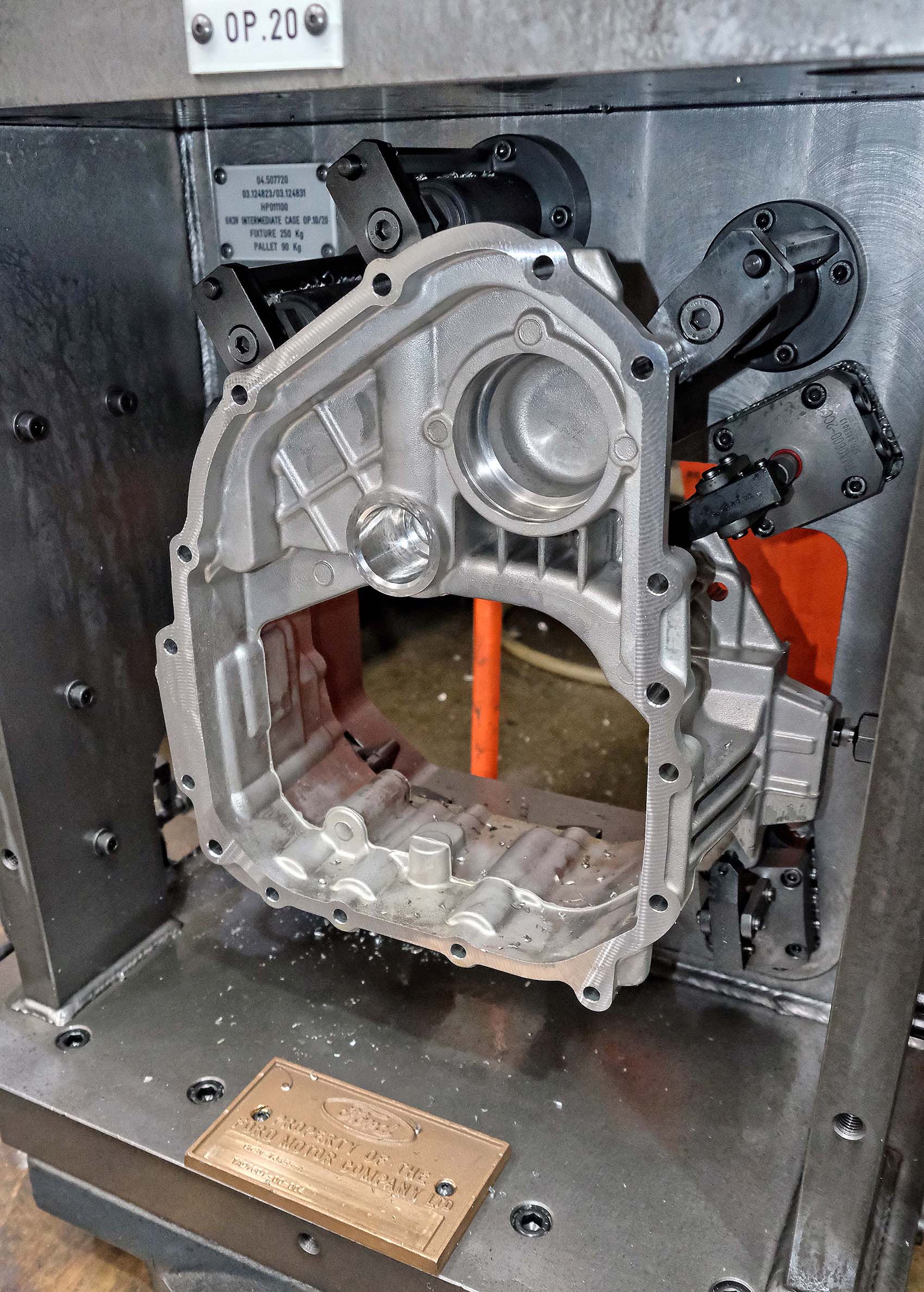

Installed in a space in MJ Allen’s 18,000 sq ft machine shop previously occupied by test equipment that was relocated to a new, 2,000 sq ft extension, the H4000s mirror the duties of the MCI16s. One of each pair is devoted to producing the transmission’s main case in three operations, the longest cycle being one hour. The other two are able to machine both the intermediate and cover castings four at a time per pallet in two operations apiece, as the cycle times are shorter.
Dedicated hydraulic fixtures, which are freely interchangeable between all four machines, secure the workpieces. Similarly, all programs run in any of the Siemens 840D controls. Accuracies down to ± 10 microns are achieved, which is the drawing tolerance for gear centres.
