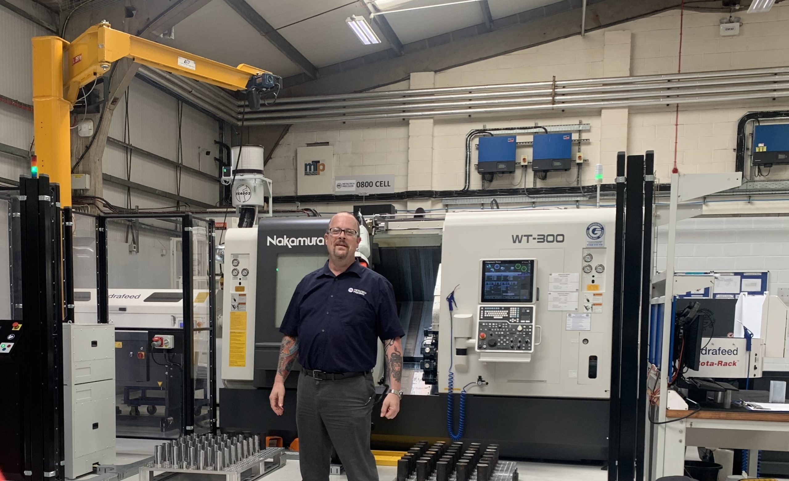

Discussing the acquisition of its latest machine tool, the Nakamura-Tome WT-300, Steven Ward from ISO: 14001, ISO: 45001 and AS: 9100 certified Metaltech says: “We purchased the machine last September and it was installed by ETG along with support and ancillary equipment from Hydrafeed.”

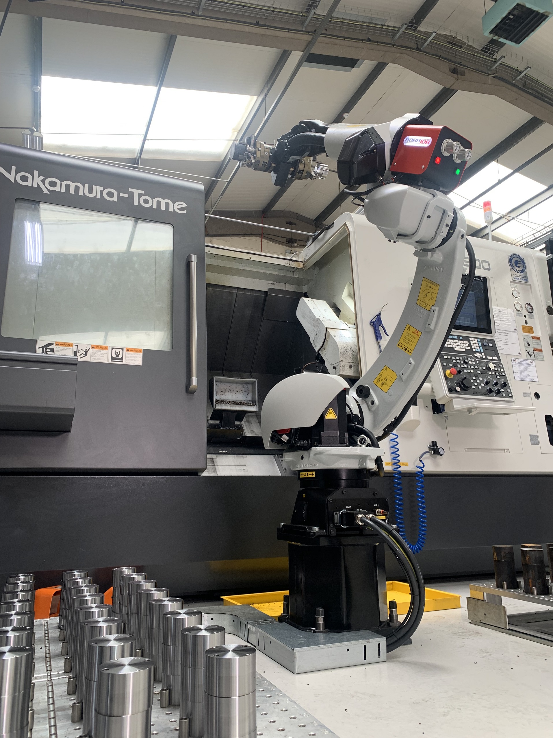

Alluding to why the company needed the machine, Steven continues: “A customer approached us with a substantial contract. We identified the requirement to machine a significant number of parts – in volume. Although we have existing fixed head and sliding head turning centres, we are conscious of how we utilise our personnel and the hours available to us in a normal working week. The Nakamura solution allows us to operate well outside our normal operating window. The cell works on the basis that the Nakamura with its performance monitoring along with the Hydrafeed Robojob system allows us to palletise either billets or we can bar feed the machine. That enables us to extend our running for lights-out machining, as our normal operating window from 6am to 6pm leaves us with a 12-hour dead period. Within that 12-hour dead period, we are now able to continue manufacturing using the Nakamura-Tome WT-300 and Hydrafeed Robojob system that we have purchased.”

Discussing if the automation route is the only way to remain competitive, Steven adds: “I think businesses must consider in general. You have two expensive assets in the business, one is your machinery and the other is your personnel. You have to consider how you best utilise both of those assets. Considering the skill set of staff, you have to understand and ask if they are better utilised on more complex tasks that are maybe smaller batch volumes or 1 and 2-offs. In essence, do you need them to stand there and do a 1000-off, putting a cherry on the cake.” It is this consideration for its staff that sees Metaltech having BS OHSAS 180001 Occupational Health & Safety certification, priding itself on its ‘Investment in People’ culture.
Highlighting how the staff are utilised with the Nakamura-Tome WT-300 automation cell, Steven says: “We have several people in the machining section trained to come up to check and monitor the machine. The machine itself has a very stringent monitoring facility within it, so even the slightest problem and the machine will alarm out. We are also able to operate outside normal working hours because we have remote access to the machine via its software. So, we can actually see what is going on via the axes loading technology and deal with any issues from there.”
