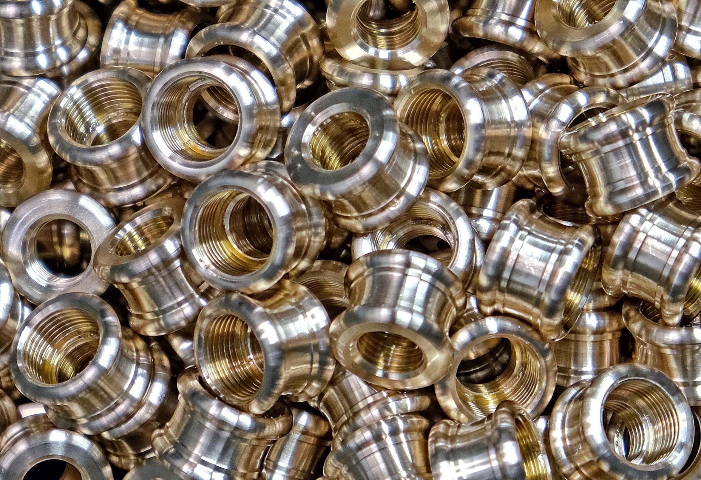

Two are Miyano BNA42-MSY fixed-head turning centres of 42 mm capacity installed in 2017 and 2021, while the other four are Cincom sliding-head models (sliders), two for turning, milling and drilling 32 mm bar and two for processing 20 mm stock. Interestingly, to achieve the high speed of production for which outdated cam technology is renowned and couple it with the inherent advantages of CNC technology, namely unattended running and rapid changeover for smaller economical batch sizes, the company operates the sliding-head machines almost exclusively without the guide bush in place.
The reason S Lilley & Son Ltd is able to do this is that most components for the light fittings it makes are shorter than 3.5 times their diameter (3.5D). Normally a ratio of 2.5D is approximately the limit when stock is not supported in a bushing (or by another means such as a tailstock or sub spindle), otherwise the protruding length of bar deflects under pressure from the tool, causing inaccuracy during machining. However, the relatively open tolerances of the lampholder parts produced in Birmingham allows the company to push the limit higher, lowering the cost of manufacturing parts up to 40 percent longer by taking advantage of higher speed production without the guide bush.

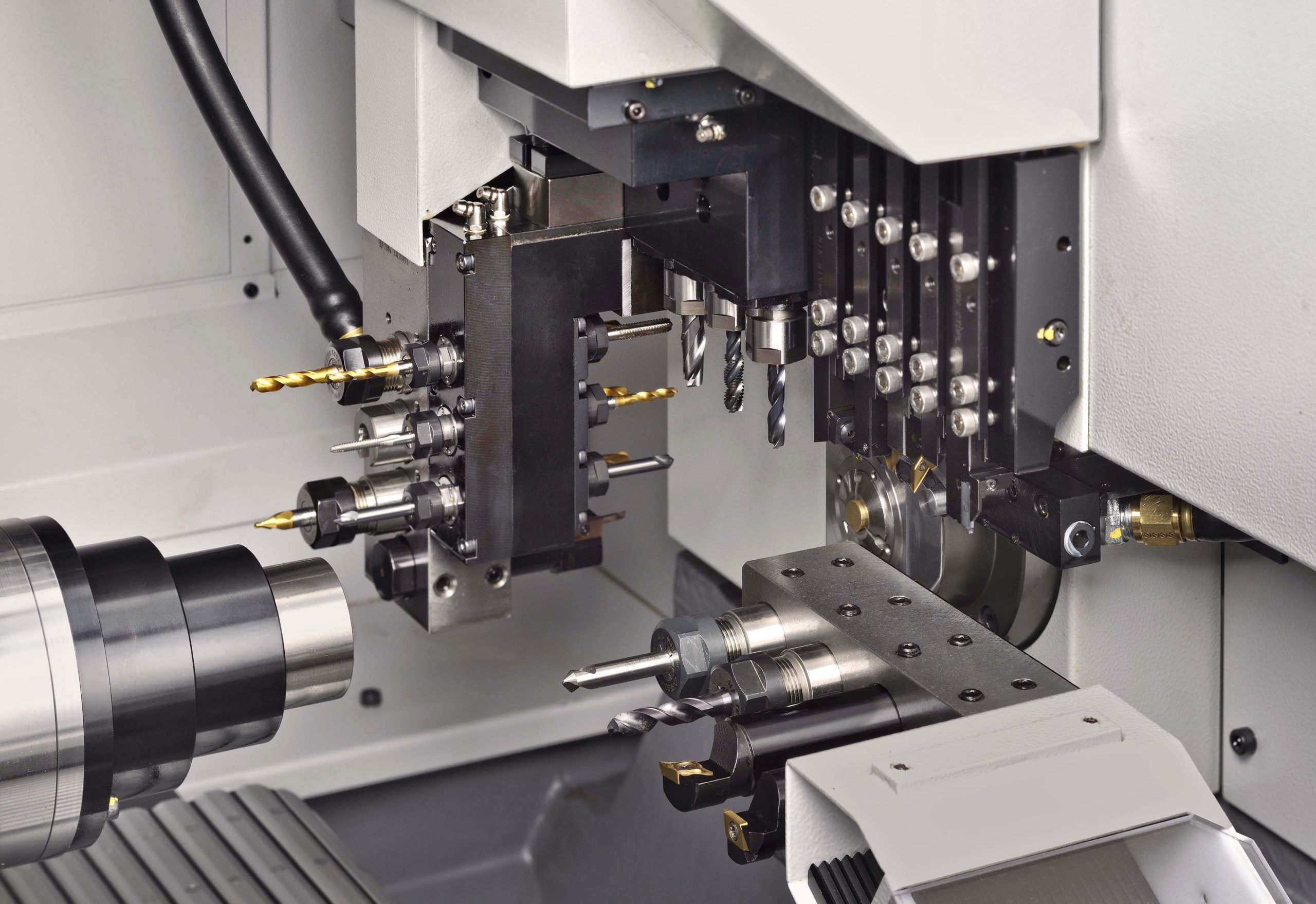

The rationale for investing in sliding-head lathes and choosing to operate them without the guide bush for most of the time, rather than buying a fixed-head lathe, is due to the sheer speed of production that is possible using the in-line ganged cutters typically found in a sliding-head machine. It allows the linear cross slide to effect very fast tool changes between cuts. Cycles times are considerably shorter and sometimes even halved compared with using a fixed-head turning centre, in which the tool carrier is generally a revolving turret that takes longer to index the next cutter into position.
Due to the bar being clamped by a collet closer to the spindle nose on a slider when it is used without the guide bush, Z-axis stroke is restricted to around one quarter of what is possible when stock slides through a bushing. It is because the whole spindle head rather than just the bar moves in and out of the working area to present the part to platen-mounted tools that can only move in X and Y. However, the shorter Z-axis travel is unimportant in the Birmingham factory, as most components are less than 3.5D.
As the collet grips the bar much nearer the work than in classical sliding-head turning, the more rigid clamping allows deeper cuts to be taken without chatter, resulting in further efficiency gains as well as better surface finishes, even when machining demanding materials.

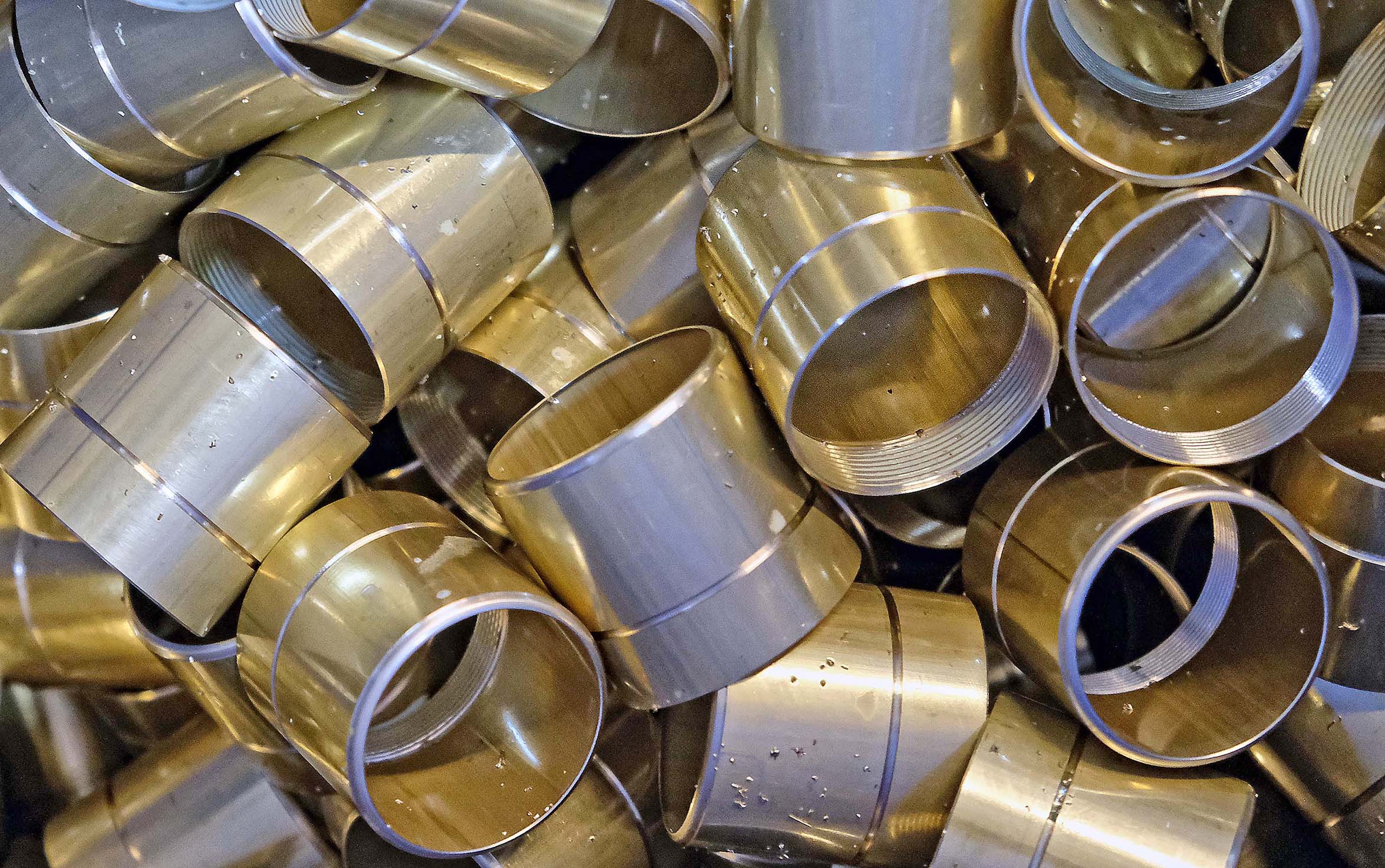

More than 95 percent of the Birmingham firm’s turned parts are made from free-machining brass bar, but lately there has been an increase in demand from its customer base for aluminium parts up to 32 mm diameter and for plastic components such as acrylic LED lenses and acetal grommets. About a quarter of the company’s throughput is contract machining of such special components for luminaire manufacturers already buying Lilley brass lampholders and lighting accessories.

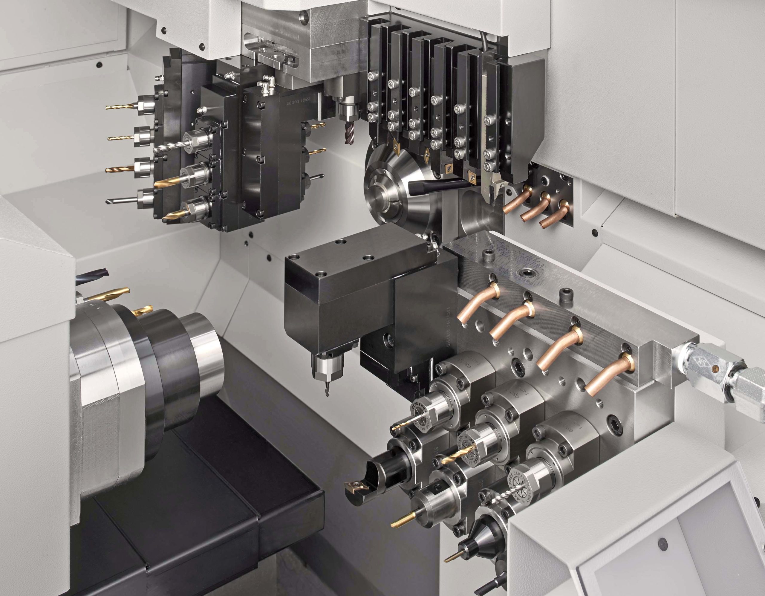

“LFV repeatedly oscillates the tool clear of the bar surface for a fraction of a second, fragmenting the swarf into manageable chip sizes. There is no longer a need to stop the machine to clear swarf tangled around the tool and component, so production output is maintained.
“By the simple insertion of G-codes, the function can be programmed to cut in and out during a cycle. It is turned off automatically when it is not needed for chip breaking, so the slight reduction in material removal rate during LFV machining is minimised. It really could not be more flexible.”
