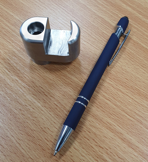

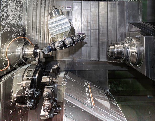

Now at the heart of Hollingworth Design’s sub-contract capability are two Index bar-fed mill-turning centres, a G200-2 and a C100 machine, The capability of these machines, especially the G200-2 with its powerful B-axis and capability of simultaneous cutting with up to four tools opened up many possibilities. “Any job that can be machined from bar is classed as a turning job, and goes on these machines, even if there is no actual turning involved,” says Paul Hollingworth. Applying this philosophy allows cycle times to be drastically reduced, with help from cutting tool supplier Ceratizit UK & Ireland. One particular component destined for use on superyachts in particular benefitted from Ceratizit’s input. Initially a four-flute 6 mm diameter milling cutter was being used on these 303 stainless teel components (see image below), with a recommendation from Ceratizit Technical Sales Engineer Matt Darbyshire this was changed to a five flute Silverline solid carbide high-performance cutter from Ceratizit’s standard range. Running this cutter at 6250 revs/min (120m/min) and 0.1 mm/rev feed rate with a 1.5 mm step down every rev, this cutter completed the entire batch of 4000 components without being changed. “The performance of this cutter simply blew me away, we achieved a cycle time of 3.5 minutes per component, running the machine 24/7 and meeting all of our customer’s expectations.” This is a typical example of the approach that Hollingworth Design takes, to look at every aspect of the job and engineer a process to make things better. To maximise the benefit for customers Hollingworth design looks at batch quantities from 500 upwards, recently completing a single order for 72,000 components.  Machining these volumes demands support from Ceratizit in the form of regular visits from Matt along with daily management of tooling through use of a Ceratizit TOM 840 tool vending system.
