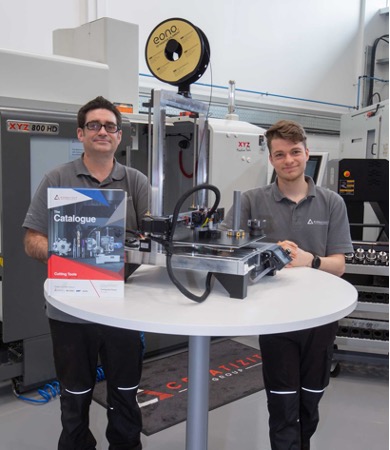

Ceratizit UK & Ireland’s investment in apprentice training is paying off with Stephen Pennington completing his Manufacturing Technology apprenticeship and final year Industrial Project by designing and manufacturing a feature rich custom cartesian 3D printer. This printer will now be used in the new Ceratizit Technology Centre in Sheffield to rapidly prototype special tooling prior to their manufacture within the group, as well as other workshop applications.
Stephen, who is now a Projects Sales Engineer working in the Ceratizit Technology Centre, was given full creative control of the project, which involved carrying out a review of existing desktop 3D printing systems and identifying the best features of each, then incorporating them into his design. The result was a printer featuring a fully custom aluminium frame, linear rail technology to move each axis, 32bit mainboard for control, an auto bed levelling sensor, direct drive extrusion and a touchscreen user interface to name a few. In total, 150 hours were spent on the project, which included 50 hours of machining components on the XYZ 800 HD vertical machining centre located within Ceratizit UK & Ireland’s Technology Centre and the writing of a 7000-word dissertation.
