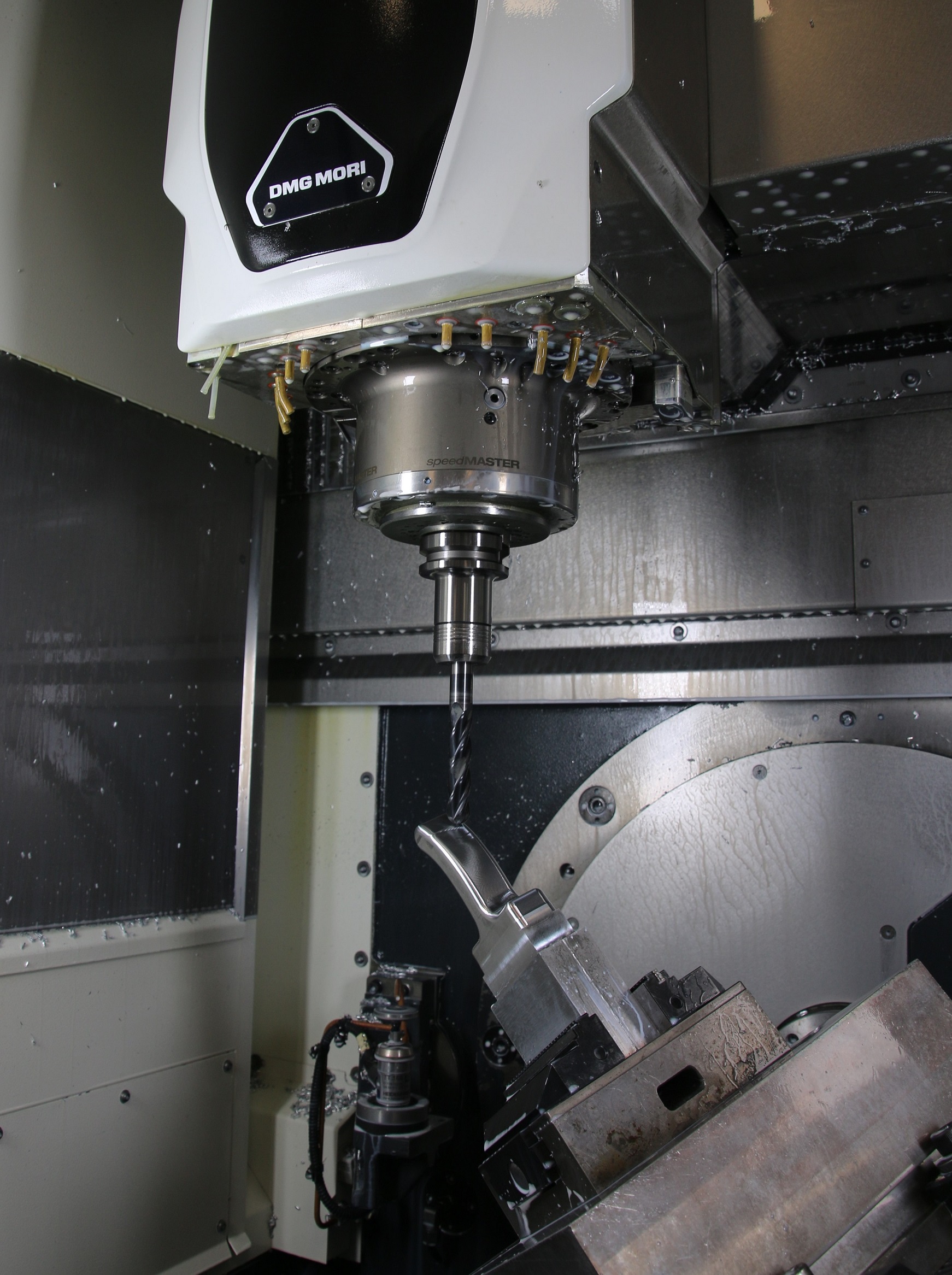

Whilst batch runs can extend into the thousands, NPE is typically producing up to 10 different types of parts in a day – all with different batch sizes. This makes the programming speed of the CAM system critical for getting jobs through the shop as quickly as possible. Discussing this, Konrad says: “Producing lots of different parts, we needed a CAM system that fits with our business and can compress our programming times. We have default tool positions set up in each of our machining centres with some special tools in the remaining tool positions in the automatic tool carousels. Likewise, we have a corresponding tool library set up in Fusion 360 with default tool positions in each tool pot of the machines’ tooling carousels. Within the Fusion 360 tool library, we also have default speed and feed settings for each tool. When this is all set up, Fusion makes it as easy as selecting the appropriate face mill or end mill and hitting the ‘OK’ button.”
NPE now has three seats of Fusion 360 with two seats also incorporating the Machining Extension. Alluding to this, Konrad adds: “Each machinist programs and runs their jobs from start to finish, programming the jobs with Fusion 360 at the machine. This gives every machinist a completely rounded skill set and avoids the potential bottleneck of having just one programmer in the office – it also instils a sense of ownership and pride when a machinist follows the job from drawing to delivery.”
“When we first receive a drawing or model from a customer, we input that straight into Fusion 360 and the machinists program the parts and make any necessary amendments at the machine.”
