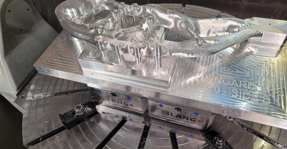

After finding a prototype design that met Lightning’s requirements, Simpson and Markovic began proving it out at Autodesk’s Birmingham Technology Center. Their feasibility studies focused on determining what kinds of jigs and fixtures Lightning would need to produce these parts through CNC milling.
At the conclusion of the feasibility studies, Autodesk will hand off the prototype to Lightning Motorcycles to enable Lightning to make tweaks for commercial production viability.
