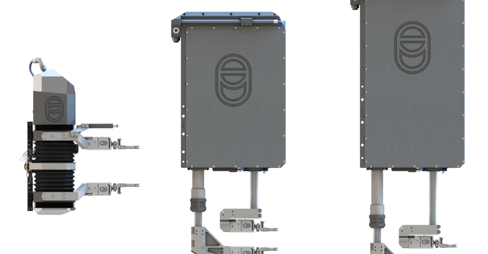

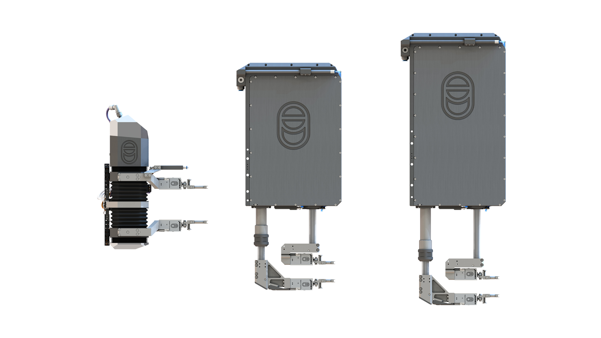

In-process gauging is an ancillary system that can measure the part while it is being ground and, in real-time, automatically control the in-feed of the grinding wheel so that every part produced by the machine is in tolerance according to the manufacturing specifications (see the picture below). It provides a 100% production validation check that can even automatically compensate for wear on the grinding wheel. Due to the harsh machining environment found in the grinding process, the gauging operation is performed with the gauge’s fingers in physical contact with the workpiece; it is the only way to get a reliable diameter measurement in such conditions. Over the decades this solution has increased in reliability and robustness, and today a few vendors, such as Balance Systems, are recognised as offering great solutions.
