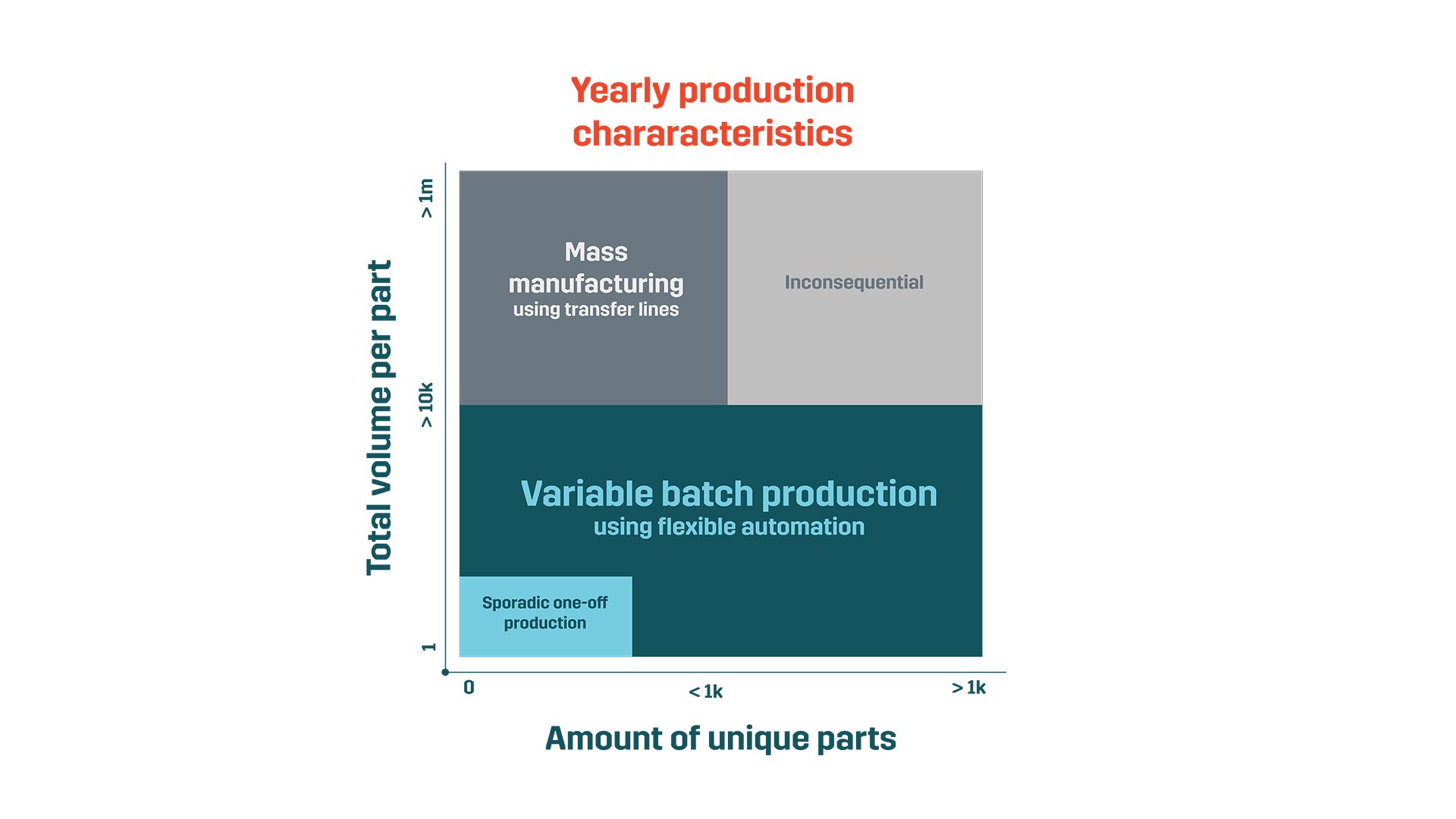

Below you can see an illustration of the above categories and how they are linked with suitable automation solutions. The matrix consists of two dimensions: workpiece variance and volume.
The vast majority of production within industrial machine building happens in the blue category, that can be characterized as make-to-order (MTO) manufacturing of batches. Oftentimes there is medium-to-high variability in workpieces, thus the name high-mix-low-volume (HMLV). A classical example is a machine job operating as a subcontractor in industrial machine building, like Kempf CNC Technik or a product-owner like Allmatic requiring much production flexibility. This kind of production is typically automated using flexible automation solutions.
In mass manufacturing, workpieces don’t vary, cycle times are typically short and production rarely faces unexpected changes like urgent orders needing to pass the queues. This is the category e.g. where auto-industry part manufacturing happens most of the time. The production is typically handled with ‘transfer-line’ automation that enables very efficient manufacturing processes in stable environment.
From the perspective of automation, the third category (sporadic one-offs) can be out of scope but that needs to be defined case by case. The biggest factors defining the automation case are the total volumes of all workpieces, their variability in physical dimensions as well as quality and lead time requirements. This category can include e.g. special spare part manufacturing or special workpieces for R&D or testing purposes.
The category of ‘high-mix-high-volume’ is inconsequential as if the individual workpiece volumes get high enough, the production is handled with dedicated automation lines and if not, one is in the world of high-mix-medium-volume where flexible automation applies.

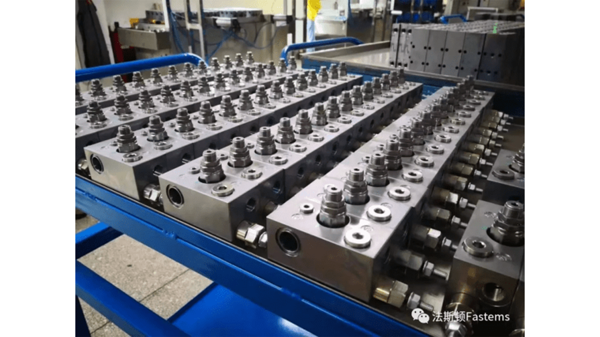

As an example, below you can see valve blocks manufactured in HMLV context by Sant Hydraulic. Read more about how automation helped them here.

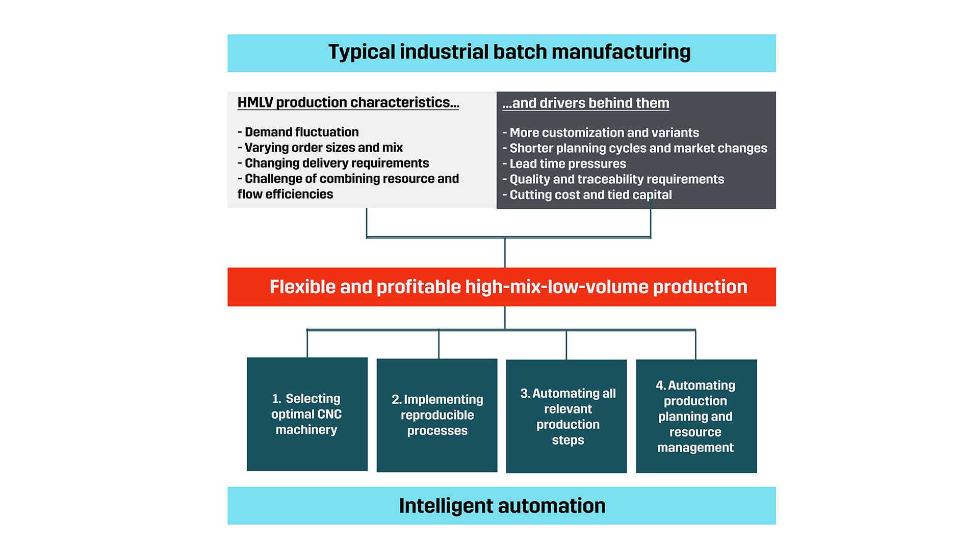

The below illustration, based on our four decades of automation experience, summarizes in principle how economic HMLV production can be achieved and also describes the factors that are creating the demand for it. It’s important to consider the whole manufacturing portfolio, not just a single or few workpieces and try to optimize their flow as that certainly won’t fix factory level issues. That is to say, high-mix-low-volume production needs more of total than individual workpiece level solutions.
FOUR STEPS ON HOW TO AUTOMATE HIGH MIX LOW VOLUME BATCH PRODUCTION:
  1. Selecting the optimal CNC machinery by grouping together part families that need similar machining operations and investing in fewer universal machines to handle them. For example one 4-axis milling machine can work out the jobs of three 3-axis machine tools with the right kind of fixturing design.
  2. Creating reproducible and high quality manufacturing processes with focus on always adding-value to the part. This means also minimizing unnecessary moving of the parts.
  3. Automating all applicable production steps to create flow. The possible steps to automate you can read more here but they would include the main machining processes and supportive ones like deburring, finishing, marking and so on. Sometimes automating tool management can bring huge benefits.
  4. Automating also the complexities of production planning and resource management with intelligent software such as Fastems MMS, capable of providing a constantly-updating production plan and proactively checking for production resources to enable longer autonomous production periods.
As end result, flexible automation enables in HMLV context what LEAN philosophy calls flow and order-driven production: batch sizes, work-in-progress and stock decrease, lead times speed up and the whole production is more accurately be based on current demand vs e.g. trying to optimize set-up times by manufacturing over-sized batches to stock.
