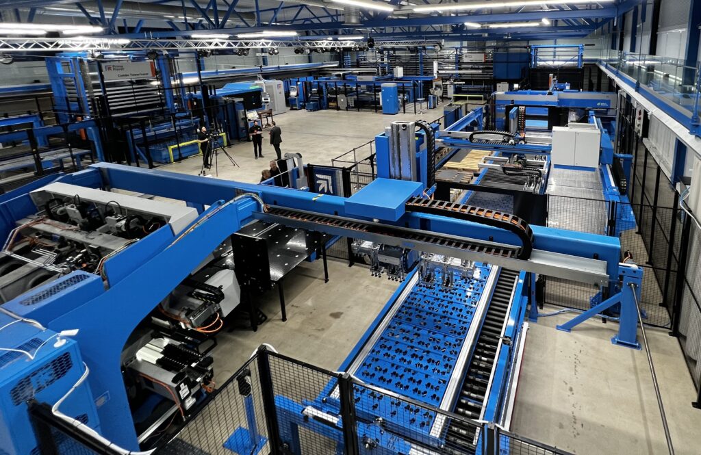

As the centrepiece of the state-of-the-art Seinäjoki facility, the 7000m2 centre demonstrates a complete armoury of solutions. During our visit, this included the Laser Genius+1530 with the PSR (Picking and Stacking Robot) and the new EBe 2720 servo-electric driven panel bender that demonstrates the company’s latest API technology. The EBe 2720 panel bender in the facility forms part of a complete PSBB (Punch, Shear, Buffer and Bend) automation solution in the Tech Centre. At one end, this colossus automation system that stretches some 40m, has the Combi Genius CG1530 laser and punching machine that is fed by the Night Train Genius automation system that has more than 60 storage cassettes – each able to hold 3 tons of sheet steel.
Completely configurable to the demands of the end user, the impressive Night Train has the CG1530 at one end and at the other, a PSBB line including a Shear Brilliance 1530. Sheets fed to the Shear Brilliance 1530 are then transferred to a buffering station where sheets and parts can be removed, added or flipped over for transfer to the final station, the EBe 2720 panel bender. During our visit, the exceptional level of flexibility and automation was demonstrated with a complete kit of parts being manufactured for an office furniture assembly.

Upstream from the EBe2720, is a buffering in balancing station. Here, parts can be removed, added or flipped over before processing on the EBe2720. This balancing station is necessary for the technical centre, as upstream from the EBe2720 is the Shear Brilliance SB1530 – a punching and shearing machine that can churn through the work with a strike rate of 1300 holes per minute.
Launched at the Euroblech exhibition last year, the Shear Brilliance machine in the tech centre has 30 turret stations, 30-tonne punching force and a staggering 210m/min axis speed. As Barry adds: “Both the Shear Brilliance and Shear Genius are machines that are so quick, they are typically embedded with our automation solutions. You have to have automation for the high number of parts that can be produced in such a short time – otherwise, customers would be continually loading and unloading material, so the machines are designed and optimised for an automated environment.”
“As our high-performance machine, the Shear Brilliance can punch 1300hpm at a 1mm pitch and has a 30 station turret. This exceeds the 16 and 20 stations on the Shear Genius machines. On 16-station turrets, a large index tool and/or multi-tool can be allocated to each position whereas on the 20-station turret, only every other position can accept an indexable multitool. However, on the 30-station turret on the Shear Brilliance, we do things differently. We have a larger number of stations and every other position will be up to size D indexable multitool and the smaller positions accommodate single tools, however, as with the 20 stations on the other machines, we can put multi-tools in the small positions.”
“We can hit the correct tool as the intelligent RAM will work with the multitool to select the correct punch inside it. The intelligent RAM and an indexing multi-tool will work together to optimise positioning and maximise productivity. A fixed non-indexable station can also accommodate a multitool – you may not be able to turn the tool, but you can turn the RAM and this will select whichever tool it needs. The overriding aim is to create optimal flexibility for all scenarios, thereby eliminating tool changeovers except for sharpening. On many of our competitor’s machines, they don’t have this flexibility so they need to frequently change tools. Some machines rely on tool changing, or tool changers to create the capacity – on our machines, the tooling is in the turret at all times and ready for use. This means we can sit with customers and work out what their production requirements will be and set up the turret around the customer.”
