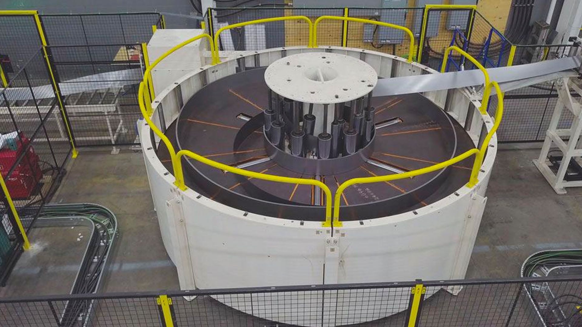

Accumulator. A coil coming off an uncoiler goes into an accumulator, where it is fed into the roll former. When the entire coil is in the accumulator, the coil can be changed without stopping the roll forming process. Once the coil is replaced, the material runs into the accumulator again. This automation can save 10 to 15 minutes per coil change.

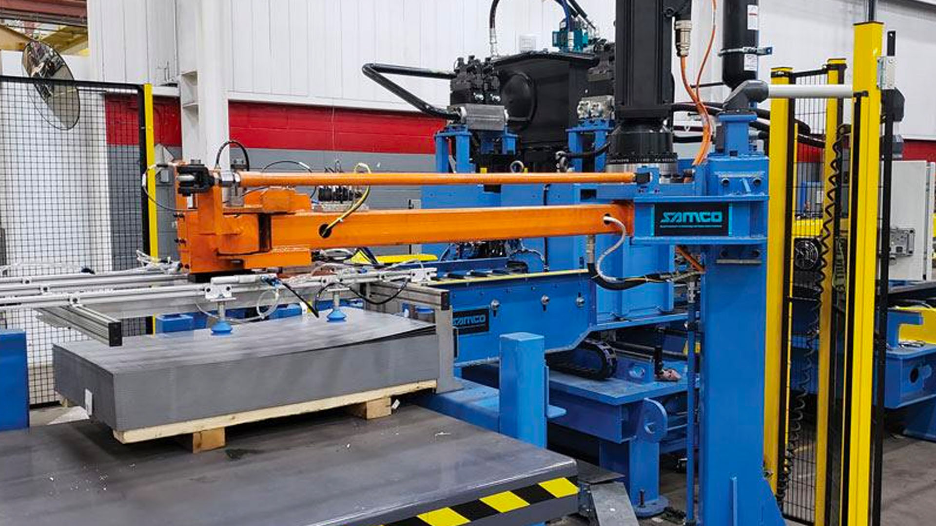

Pick-and-place System. Rather than manually feeding one blank at a time, this system picks and places precut materials on a powered conveyor. It can select right- and left-handed parts appropriately and orient parts properly for post-processes like bending or punching.

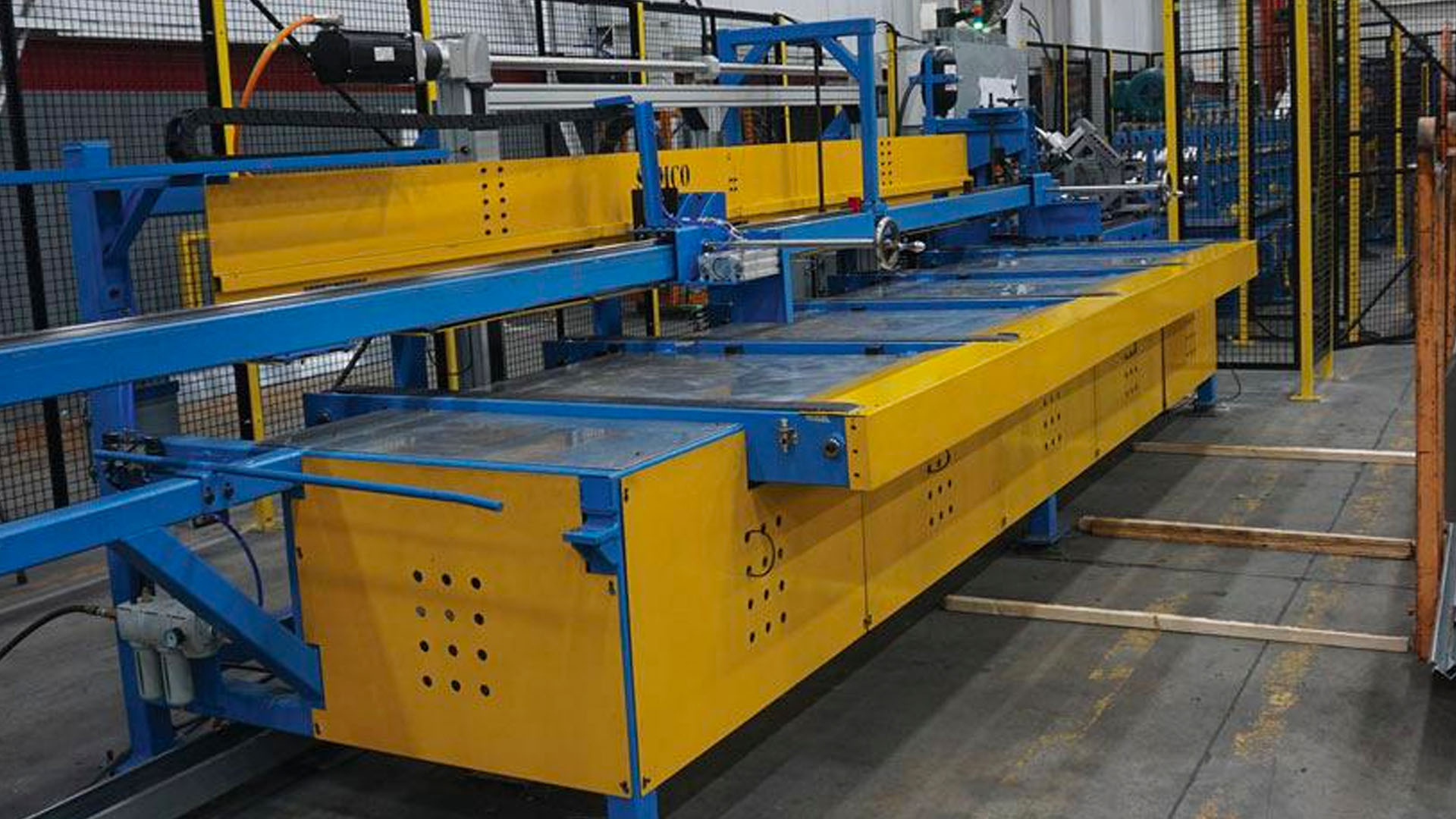

Nester. A nester is used as finished product comes off the line at high line speeds, upwards of 500 ft./min. It collects and nests a group or bundle of finish products, usually for the stud and track industry, to be moved to packing and shipping. Nesters eliminate the need for multiple workers at the end of the roll forming line.
Stacker. This material handling system stacks finished parts at the end of the roll forming line. It is programmed to move the stack at a predetermined number of parts per stack to an area for pickup by a forklift.

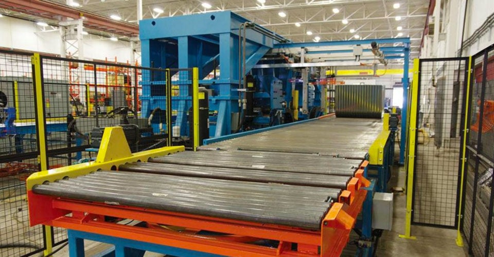

Bundler. After parts come off the roll former they are nested into mini-bundles. Bundlers automate the handling of mini-bundles and automatically build pre-programmed master bundles that are ready to be shipped based on part orders and batches. A master bundle lift table rises to receive the first layer of product from the machine and lowers as the stacks build up. They are then strapped together into one unit for shipment. Once that master bundle is complete, the lift table drops all the way down and feeds the completed bundle to the final exit-end roller conveyor.
This material handling system eliminates manual lifting of packed bundles and reduce injuries due to lifting and turning of heavy, grouped parts.
