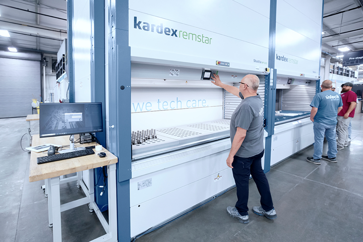

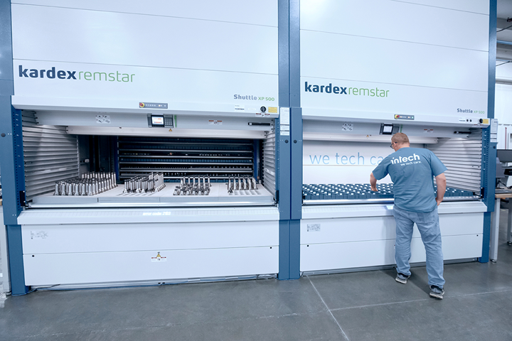

As Intech expanded its services globally, serving hundreds of customers, the complexity of its inventory grew. With more cutting tools, collets, and components than ever before, their traditional inventory management system proved inefficient. This led to the adoption of innovative solutions, including vertical lift modules (VLMs) from Kardex Remstar, tool vending machines from SupplyPro, and tool management software from ZOLLER.

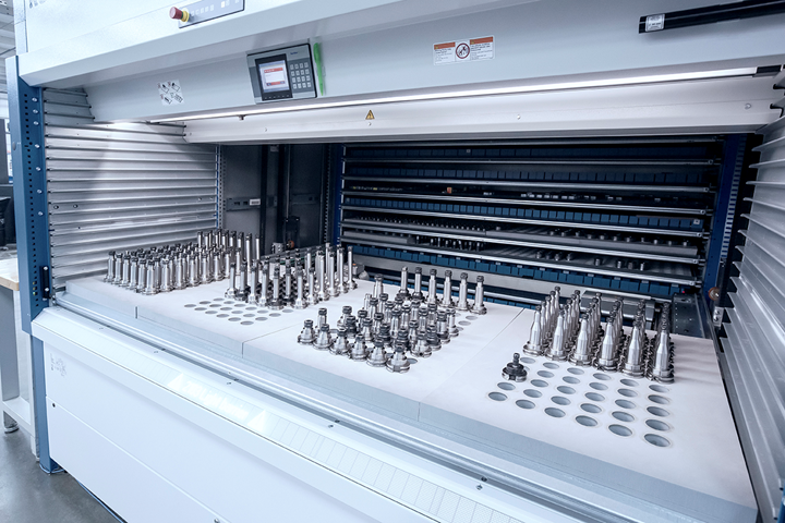

The implementation of this new tooling management system, featuring Kardex Shuttle VLMs, not only streamlined inventory but also freed up substantial space, allowing for the incorporation of two additional CNC machines. The software provided by ZOLLER enables accurate tracking of tool life and usage, offering valuable insights into tooling decisions.

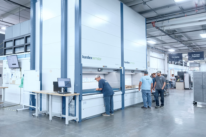

To cope with the growing complexity of its tooling inventory, Intech categorized tools into consignment, burn, and stock. The ZOLLER TMS software facilitated the cataloging of $1.3 million worth of items in just one year. The integration of Kardex Shuttles and ZOLLER TMS software significantly enhanced efficiency, particularly in pre-staging jobs. Operators can now easily retrieve required tools from the Kardex Shuttles, with the system directing the process based on job numbers entered into the ZOLLER TMS software.
This streamlined approach has drastically improved efficiency, with the pre-stage team easily handling production jobs for 70 machinists. The visibility into tooling inventory also revealed redundancies and overlaps, leading to a more cost-effective approach. Intech saved $100,000 on tooling costs, despite an increase in work.
