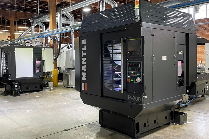

However, a novel approach to creating cores and cavities has emerged and is now fully available in the market, courtesy of the California-based startup Mantle. Dubbed the “TrueShape” system, this innovative method still utilizes a modified CNC machining center but introduces a unique twist: it begins with steel in paste form and leverages 3D printing technology.
Here’s how it works: Mantle’s proprietary metal paste is 3D printed and CNC machined in a single operation. Through controlled sintering, the paste transforms into a fully dense steel mold core or cavity, equivalent in material quality to H13 or P20. This streamlined process eliminates rough milling, EDM, and drilling of cooling lines, which can now be 3D printed conformal to the tool geometry.
The performance of tools created through the TrueShape process matches that of traditionally made molds, with one molder, Tessy Plastics, successfully exceeding 1.65 million cycles with a TrueShape mold. The key difference lies in the significantly accelerated pace: printing and sintering a core and cavity takes a mere two to three days, compared to the several weeks typically required for conventional injection molds.
