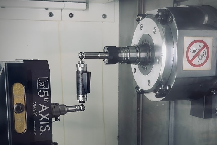

To decide between refurbishing and buying new, start by assessing the health of the machine in question. Focus on three main areas: the spindle, the axes, and the overall condition of the machine and its components.
For the spindle, inspect for any signs of wear or damage, such as fretting, rust, or taper imperfections. Testing the draw bar strength is crucial, as it affects cutting performance and tool balance. Check the spindle’s rotation with a test bar and indicator to assess bearing condition. If needed, the spindle can often be reground or have the draw bar replaced without major disassembly.
For the machine’s axes, use tools like a qualified square, a ball bar, and laser measurements to assess geometry and performance. These tools can identify issues like misalignment or backlash, which may require recalibration or adjustments.
Lastly, evaluate the overall condition of the machine and its supporting systems. Make note of any components that need repair or replacement, such as coolant pumps or safety features.
