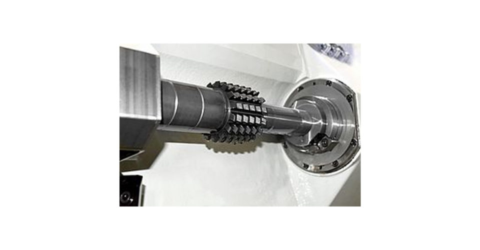

The R 300 vertical hobbing machine from EMAG Richardon has been running at HKS since March 2019. Throughout this time, there has been a tremendous increase in performance when compared to the previously used technology: the operation time has been drastically reduced from up to three hours to about 30 minutes, when machining very large gearings. At the same time, the tool life of the hob used has increased by approximately 30 percent. This means that tool costs are decreasing at HKS. To sum it up, the vertical hobbing machine is able to machine module 3 external gearings from 90 to 350 millimeters (4 – 14 in) in width. The pistons generally range from 200 to 500 millimeters (8 – 20 in) in length and weigh between 2 to 200 kilograms (4 – 441 lbs). “This broad range of components is directly linked to a particular strength of EMAG Richardon’s technology—exceptionally generous fundamental design principles,” explains Michael Ossot from EMAG Sales. “We value the large machining area with long travel paths, as well as the wide range of speeds and performance capabilities, which allows us to machine components of all different sizes.” The machine also stands out because of a variety of details in its design: the base of the machine is made of high-quality cast iron, which reduces vibrations. The machine is also very thermostable. The workpiece table with torque motor is another important aspect, since its direct drive is free of wear, backlash, and maintenance, and very precise in its movements. This benefits precision during the machining process. The double V guideways on all axes are another distinctive mark of quality.
In 2017, the EMAG Group acquired Richardon and gained their extensive experience in gear cutting for large components. It was important to HKS that this transition did not lead to any technological changes to the design of the machines, as confirmed by the Head of Operations, Mario Vogt: “We have had a great experience with this technology and obviously wanted to establish the same efficiency and flexibility at our Neukirch site—without any change in mechanical engineering. EMAG was able to guarantee this. We’re continuing to see the benefits of our investment decision. The machine allows us to produce significantly larger unit volumes in a comparable time period. Considering that rotary actuators are continuing to be implemented in a growing number of application areas and the market for this technology is growing, this is a key enabler of our success.”
