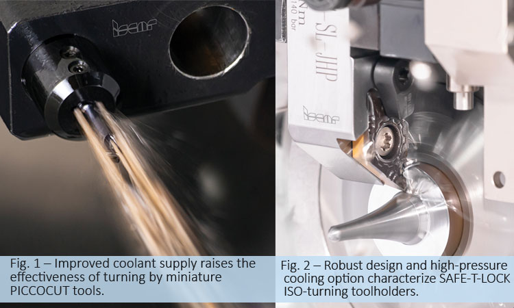

The influence of cutting tool design engineers on new tool developments is paramount, and the latest products from ISCAR contribute to understanding these factors. Specifically, the PICCOCUT line of miniature tools is highlighted, featuring a coolant-through-tool mechanism with pinpointed emulsion directed at the cutting edge, enhancing efficiency. The article also discusses double-sided holders with internal coolant channels and a user-friendly clamping mechanism, ensuring high stiffness clamping for improved cutting performance.
For machining orthopedic medical components, ISCAR introduces turning tools with ISO standard inserts for Swiss-type and CNC lathes, incorporating the SAFE-T-LOCK clamping mechanism for precise and extremely rigid insert mounting. The availability of a high-pressure cooling option enhances turning under challenging conditions, improving productivity and prolonging tool life.

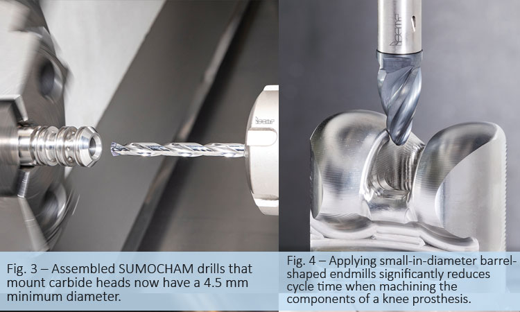

Small-sized solid carbide drills, commonly used for drilling orthopedic components, face challenges in miniaturization. ISCAR’s recent reduction in the lower limit of the diameter range for SUMOCHAM drills with interchangeable carbide heads to 4.5 mm represents a significant advancement in cost-efficient assembled drills for the medical industry.
The article discusses the theoretical aspects of ball-nose milling cutters for fine milling complex-shaped parts, highlighting the challenges of cycle time increase due to diminishing step size. It introduces barrel-shaped mills or “segment mills” as an effective solution, especially in five-axis profile machining of formed orthopedic components. ISCAR’s addition of high precision “cutting barrels” to its product range is aimed at semi-finishing and finishing titanium, superalloys, and austenitic stainless steel, common materials in the medical industry. Barrel-shaped mills provide a smoother surface, reduce the number of cuts, and decrease process time.

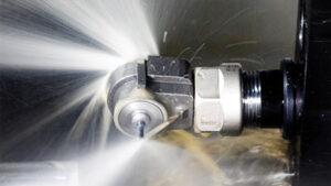

Small-size rotary tools for cutting operations, including milling, drilling, engraving, deburring, and others, demand substantial rotating velocity, especially in high-speed machining (HSM) strategies. ISCAR addresses this with its new high-pressure coolant-driven MICRO 90 spindles, enabling rotating velocities in the range of 35,000-53,000 rpm while the main machine spindle remains idle.
