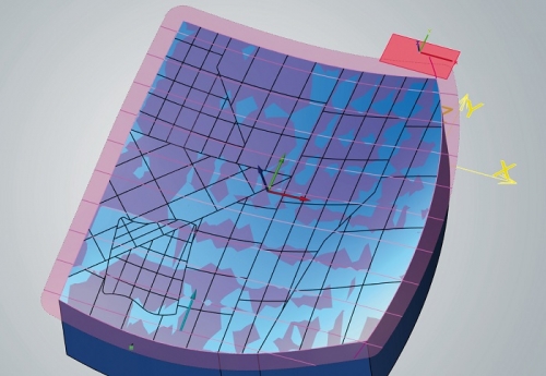

The new version 2019.2 of CAD / CAM hyper MILL ® includes innovations in many areas: from high – precision 3D finish tangential to the 5 – axis machining, turning , high – performance CAD CAM related technologies. OPEN MIND is integrating more and more functions, which were previously supplementary stages of CAD machining, directly into CAM strategies to further accelerate programming.
Already introduced in the latest version for finishing high precision profiles, hyper MILL ® 2019.2 now offers the finishing of 3D mold drawings: the option «High precision surface mode» allows to obtain surfaces with a smooth mirror finish with tolerances in the µm range This eliminates the need for polishing, especially in the manufacture of molds. The same effect is also achieved with the “Soft overlap” function for finishing 3D profiles. In the areas of transition between flat and inclined areas, overlaps can be defined to rectify the limits that would otherwise occur. Raising the tool slightly achieves a perfect and imperceptible transition to the attached surface.
CAD functions integrated directly into CAM
In the case of hyper MILL ® 2019.2, the “Global adjustment” function of hyper CAD ® -S, which is part of the 5-axis tangential machining, has been integrated directly into the CAM strategy. Thanks to this function it is possible to combine several surfaces into one with a defined ISO orientation. This principle of using CAD elements for CAM programming also applies, for example, to automatic surface extension. For example, to improve the milling result at the edges of the part, the perimeter of the milling surfaces selected during programming can be extended. The fact that it is no longer necessary to switch to the CAD system to make these adjustments greatly simplifies programming.
