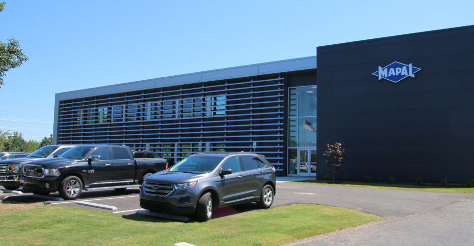

As a world leading cutting tool manufacturer and technology partner, the importance of the US market to MAPAL is something that was re-affirmed in 2013 with the opening of the company’s second US facility in Fountain Inn, SC. Complementing the existing headquarters in Port Huron, Michigan, one of MAPAL`s mottos is ‘Always close to the customer, worldwide.’ “MAPAL is dedicated to continuously meeting and exceeding customer expectations and the expansion has allowed us to better service customers in the South whilst also expanding our customer base,” emphasizes MAPAL Chief Operating Officer (COO), Mr René Kristensen.
The 40,000sq/ft state-of-the-art facility opened with just three staff members sweeping the floors of an empty building during the first few weeks of business. However, the tool grinding machines rapidly flew through the door soon after the company’s inception. As Production Manager, Mr John Schuck recalls: “In 2013, we were sweeping the floors and waiting for the first machines to arrive, one of which was a Vollmer QWD750H wire erosion machine with a 12-station tool loader. During the first couple of weeks, our small team went to MAPAL WWS in Pforzheim Germany, the world`s largest PCD manufacturing facility. The trip involved extended training courses and when we arrived back in the US, we were welcomed by a multitude of grinding centres and inspection equipment.”
Identifying why the global manufacturer opted for the Fountain Inn location, Mr Schuck says: “The location was an obvious choice for MAPAL, our parent company has well established long-term relationships with Global suppliers for the automotive industry like Bosch Rexroth, ZF, Alupress, Continental Teves, KSM, Bosch and many more that all have manufacturing plants close to our facility. Many of these companies had such trust in MAPAL that for many years, they were sending some of their re-grind/re-tip tooling back to Germany for servicing and new product development did have extended lead-times from our German plant – as MAPAL Germany supports customers worldwide. By locating in South Carolina, we now have PCD and solid carbide manufacturing, new tool design, an Aerospace Test Center as well as service and re-grinding right by our customers.
With MAPAL having an uncompromising reputation in the automotive industry and the Port Huron facility located in Michigan and near Ohio, the two automotive epicentres of the US; the existing and potential customer base needed a complementary manufacturing facility and additional capacity – the Fountain Inn location now provides both.
The new facility in Fountain Inn has given MAPAL the ability to work with new and existing customers to develop and trial new products, which has been invaluable for developing new business with prominent Tier 1 and OEM customers. Supporting the growth from day one has been tool grinding and erosion experts, Vollmer. As the company has evolved, so has its investment in Vollmer technology, as John Schuck recalls: “Globally, MAPAL is a big advocate of the technology from Vollmer, so our first two machines in 2013 were the QWD750H with auto loaders for processing PCD tools. Our immediate growth noted an additional two QWD750H machines arriving in Spring 2015.”
