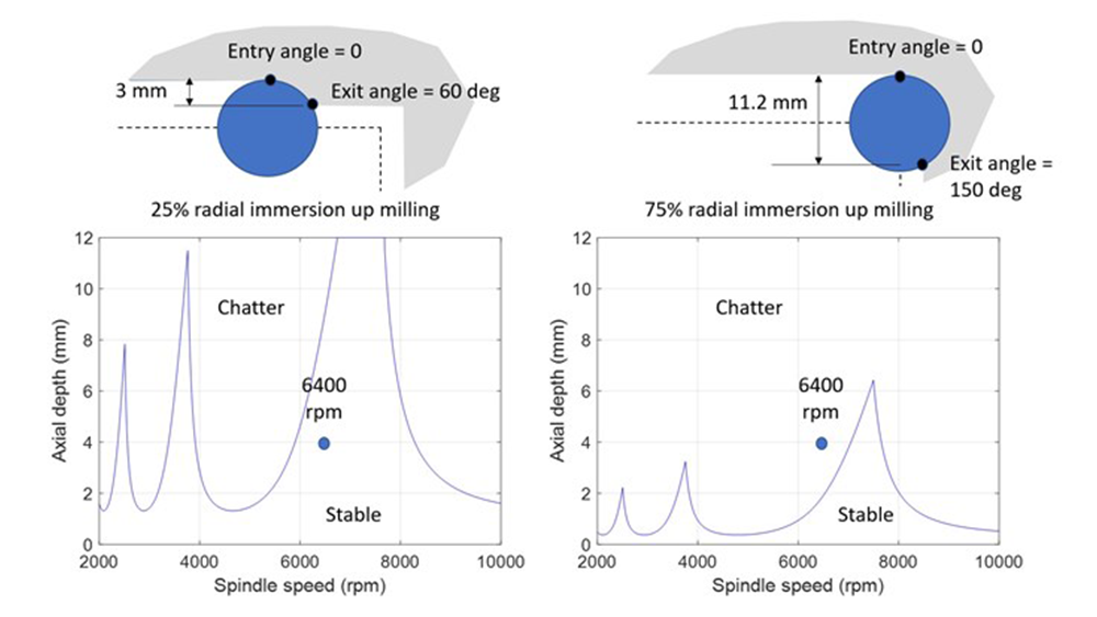

To mitigate chatter and ensure stable machining conditions, it’s essential to consider the tool tip frequency response function and radial depth of cut from the tool path. Stability maps, derived from these parameters, aid in identifying spindle speed-axial depth combinations conducive to stable machining. By integrating vibration considerations into CAM milling parameters, manufacturers can streamline the process planning stage, minimizing trial-and-error iterations and optimizing machining efficiency.
