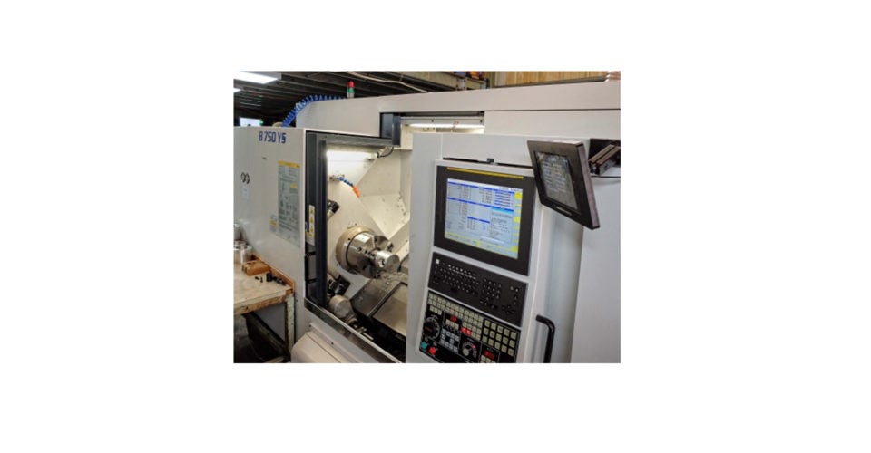

Above this diameter batch sizes are lower, but recently the manufacturer’s US distributor started to request bigger products in higher quantities, which put pressure on the company’s single large-capacity turning machine. Positive experience with the first two Biglias pointed Mr Hibberd in the direction of Whitehouse again, which in April 2019 supplied the largest-capacity version of a twin-spindle Biglia 750-YS 8-inch chucker with Y-axis and C-axis.
It is capable of turning components up to 552 mm diameter by 765 mm long, far larger than needed. More pertinently for Headline Filters, it is possible to use a bar puller in the turret or alternatively the counter spindle to feed stock up to 100 mm diameter through the bore of the main spindle into the working area to simulate the advantages of having a bar feeder. A 38 kW main motor and powerful 17.5 kW driven tools in the 16-station turret capable of rotational speeds up to 10,000 rpm plus the availability of high pressure coolant promote high productivity machining.
An early example of time advantage using this machine involved the production of a ‘380’ aluminium filter head in one operation in a cycle time of 15 minutes 50 seconds. Previously, using the other large lathe which is of single-spindle design without driven tools, the part had to undergo two operations and then be transferred to a machining centre for milling and drilling. The three operations took 21 minutes 15 seconds plus handling between machines.
