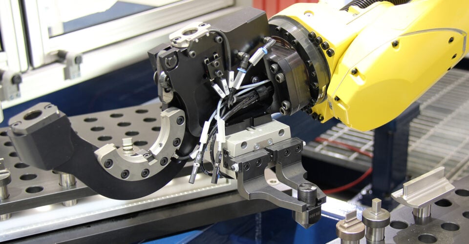

Unlike traditional punch grinding machines limited to the outer form with a single wheel, the TX7 Linear introduces a new realm of capabilities. Featuring two-wheel packs, and leveraging the company’s TXcell robot with nine to 24-wheel packs, this machine enables a diverse range of operations in a single setup. Beyond wheel pack changes, the TXcell robot facilitates automated tool loading, enabling unattended shifts for enhanced operational efficiency.
