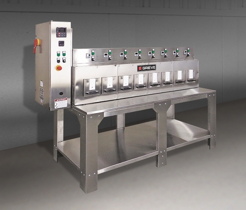

350°F BENCH OVEN with EIGHT (8) DRAWERS FROM GRIEVE
No. 1047 is a 350°F (177°C), bench oven from Grieve, currently used for curing plugs on the ends of cords at the customer’s facility. This bench oven has eight (8) drawers with dimensions of 6” W x 13” D x 6” H with removable insert to close around cord. 2 KW are installed in Incoloy sheathed tubular heating elements, while a 300 CFM, 1/3-HP recirculating blower provides horizontal airflow to the workload.
This Grieve bench oven features 2” insulated walls, Type 304, 2B finish stainless steel interior and stainless steel exterior with #4 brushed finish. Features include eight (8) digital batch timers with common alarm; one timer positioned above each drawer to individually time process in each drawer. Additional features include an integral leg stand.
Controls on the No. 1047 include a digital indicating temperature controller, manual reset excess temperature interlock with separate contactors and recirculating blower airflow safety switch. Additional controls include a circuit breaker disconnect switch and SCR power controller.
