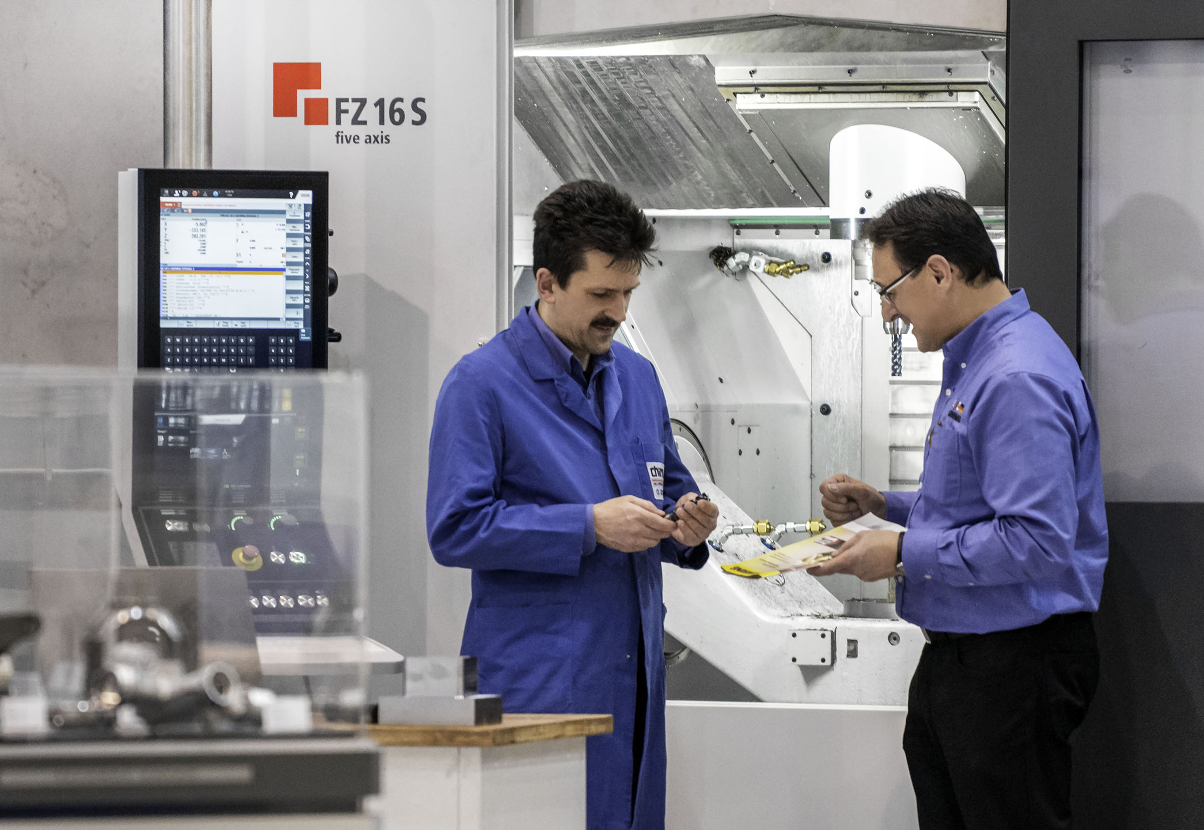

This all culminates to provide perfect conditions for the FZ 16 S five-axis single-spindle machine from Chiron. This machining centre is designed for the particular demands of accuracy when it comes to 5-axis machining. At the same time, it really stands out with its optimum dynamics, ensuring high productivity. The right tool is essential here.
Michael Eble, Head of Machine Development at Chiron, says: “We have significantly increased the drive power as well as the dynamics and cutting performance of the 16 series. But the real fun begins when the tool manufacturer is then obliged to deliver an even more efficient tool because the machine can do even more. That’s when you know you’ve done things right.”
