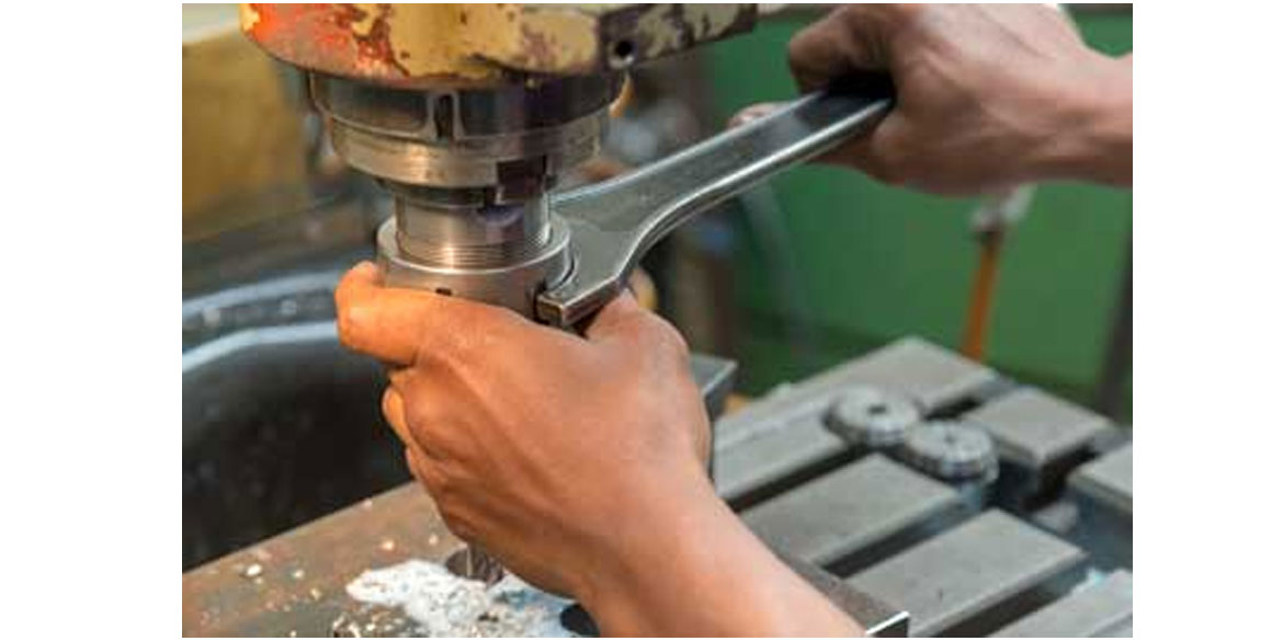

No matter how built-out your in-house repair department is — how well-equipped or how well-staffed — there will be times when you need to outsource certain services, and source replacement parts. That’s a simple fact. Even union facilities, which mandate in-house repairs, need to outsource certain things they can’t do themselves, due to lack of either equipment or specific expertise.
That’s the nature of the modern manufacturing workspace. You simply can’t do it all. And frankly, you shouldn’t strive to.
Are You Really Solving the Problem?
One of the most commonly seen issues at facilities with in-house programs is that components on failed spindles are simply swapped out, without addressing the root cause of failure. This leads to repeat failure, quickly, and possibly more extensive damage.
Take a bearing. If one fails and you simply replace it, and never learn the reason it failed, your setting yourself up for more failure and headaches. The cause could be a worn, or undersized, bearing journal, that will continue to cause bearings to fail. Until you rework the journal to specification, you’re just throwing good money after bad, as the saying goes.
It’s like putting air in a tire that’s on a bent rim. You can fill that tire as many times as you want, or even replace the tire, but until you replace or repair the rim — until you address the underlying cause — your tire is going to keep getting flat.
