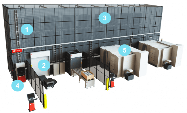

As we understand the principal concept and drivers behind flexible manufacturing, it’s time to look at what an actual FMS consists of. Below we illustrate the typical parts of a solution designed to move larger  – 400mm or above – pallets. Other scenarios will be discussed in coming blog posts:
  1. Rail guided pallet transportation vehicle or robot
  2. Setup Station (and possible material station on the right side of it)
  3. Buffer storage
  4. Control System
  5. Integrated machine tool(s)
Let’s take a closer look on each item:
  1. The rail guided pallet transportation vehicle (or industrial robot) is responsible for handling workpiece logistics between machine tools, setup stations and buffer storage. The device is typically capable of stacking the pallets in several levels, creating benefits in terms of floorspace usage.
  2. Loading station(s) for system input and output. As they’re separate from actual machine tools, loading stations can improve the ergonomics of the operator i.e. tilt the pallet for easier and faster access of heavy workpieces.
  3. Buffer storage organizes the pre-configured pallet / fixture setups to enable efficient small batch size manufacturing. It also enables unattended manufacturing. Moreover, integrated material management in which the system takes care of both blanks and ready workpiece logistics is possible.
  4. The control system plans, visualizes and executes production. It’s the brains of the entire system because of how it takes care of all resource and data management, and gives the user the opportunity to optimize the manufacturing process. At Fastems, we think control software is the most important part of a modern FMS system.
  5. Integrated Machining Center(s) of choice. It’s also possible to have different sizes of milling machines within the same automation system. For turning machines, our Agile Manufacturing Cell (AMC) is an adoption of FMS principles in a world where pallets are not utilized, such as direct turning machine tending.
