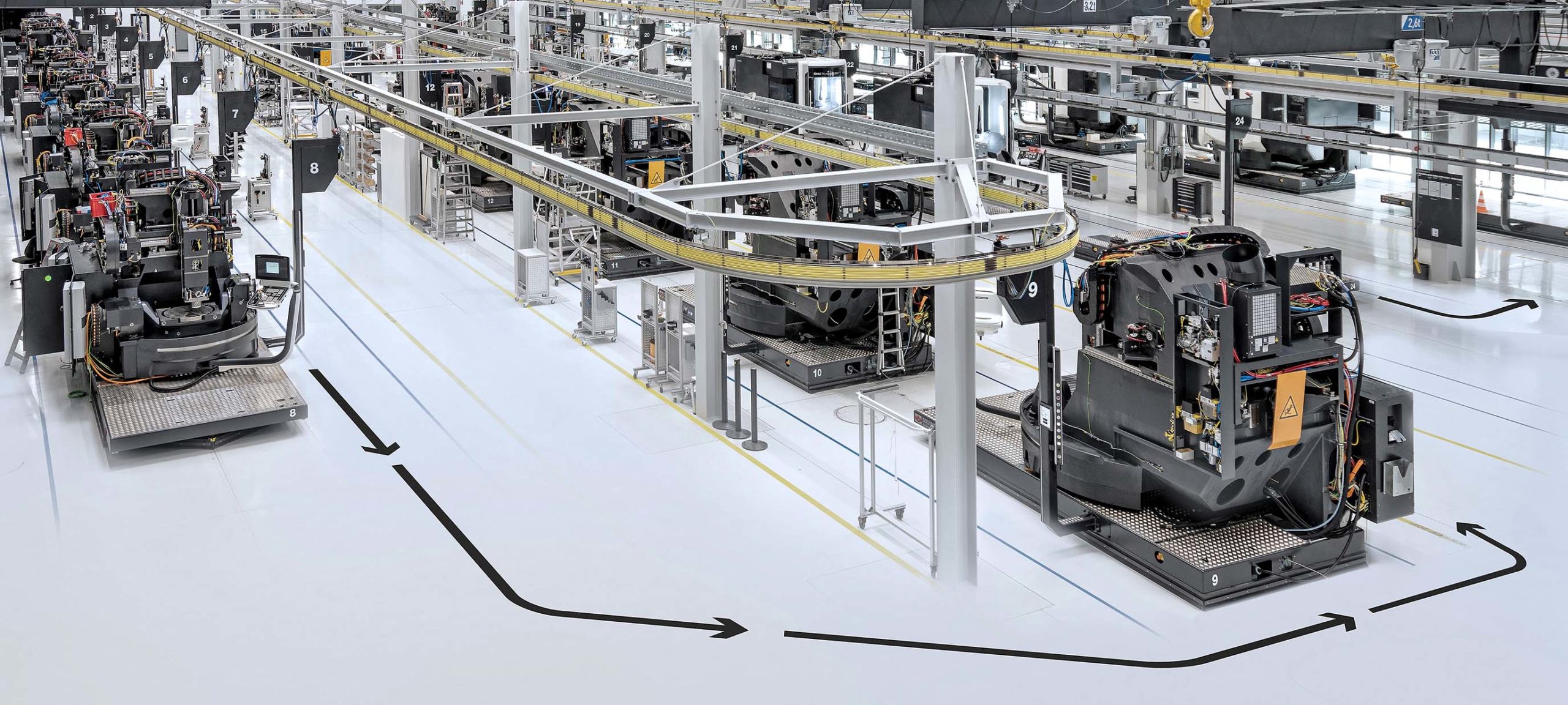

The heart of production in the new factory is an AGV transport system. By optical navigation using the latest laser scanning technology, it moves the machines continuously and autonomously through the assembly stations at a speed of 45 mm/minute. As of now, the complete model mix of the monoBLOCK series including all models with a pallet changer (DMC) and with a turn-mill table (FD) is built in a flow line in 34 cycles, starting with basic assembly and finishing with final inspection.

“The driverless AGV transport system is perfectly integrated into the digital value chain of our production site. Compared to rail systems, AGVs are a much more flexible solution, hence optimising the production infrastructure.”
The AGVs can also be freely navigated via remote control. The flexible timing of the machines ensures an uninterrupted and trouble-free flow during the assembly process.
