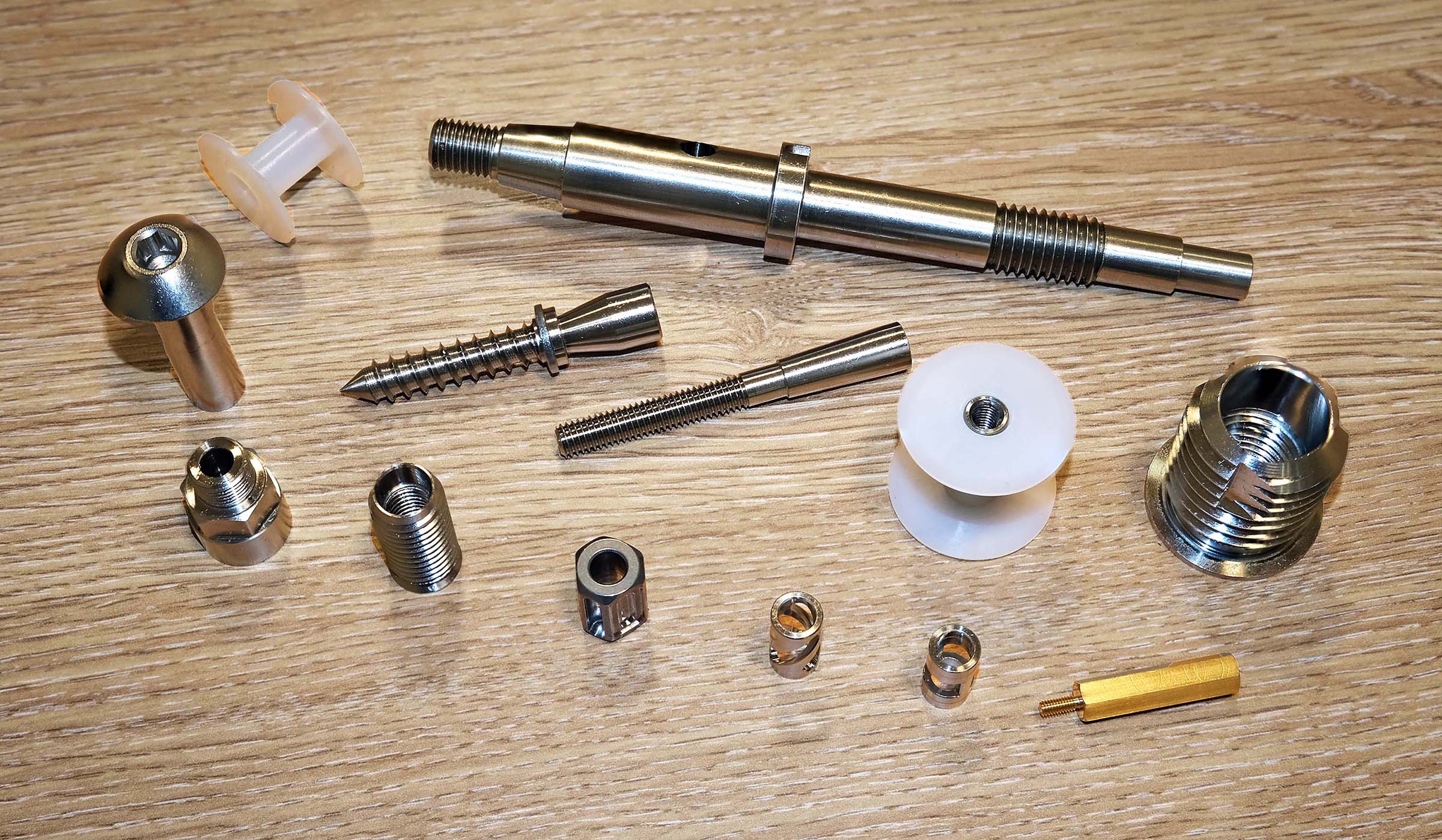

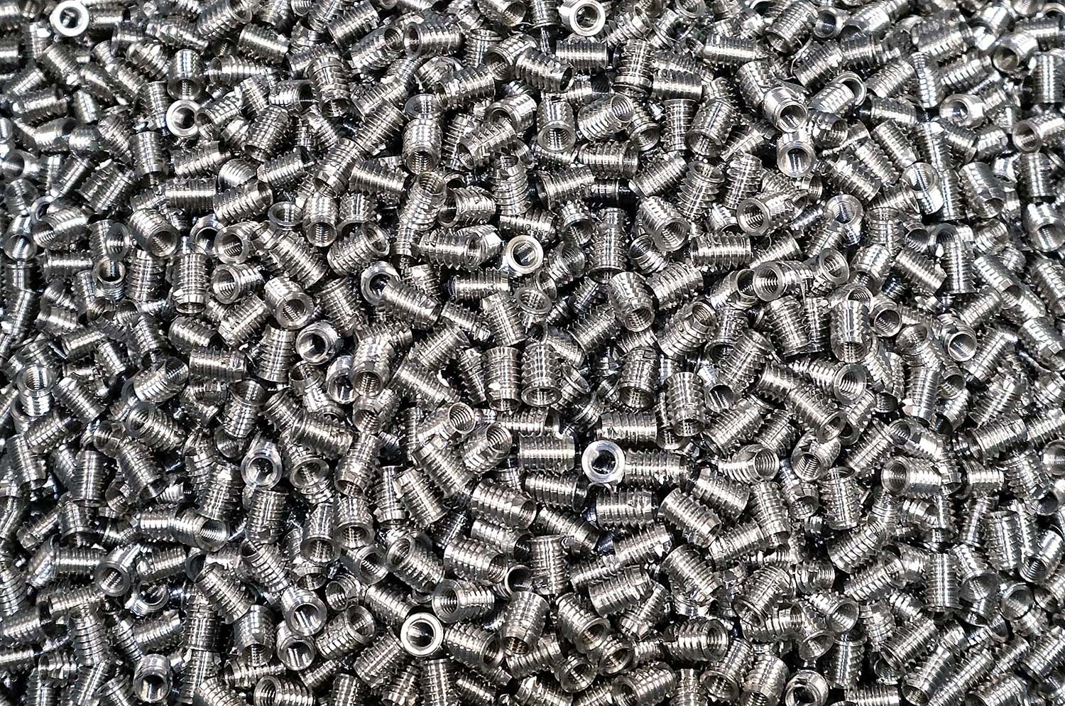

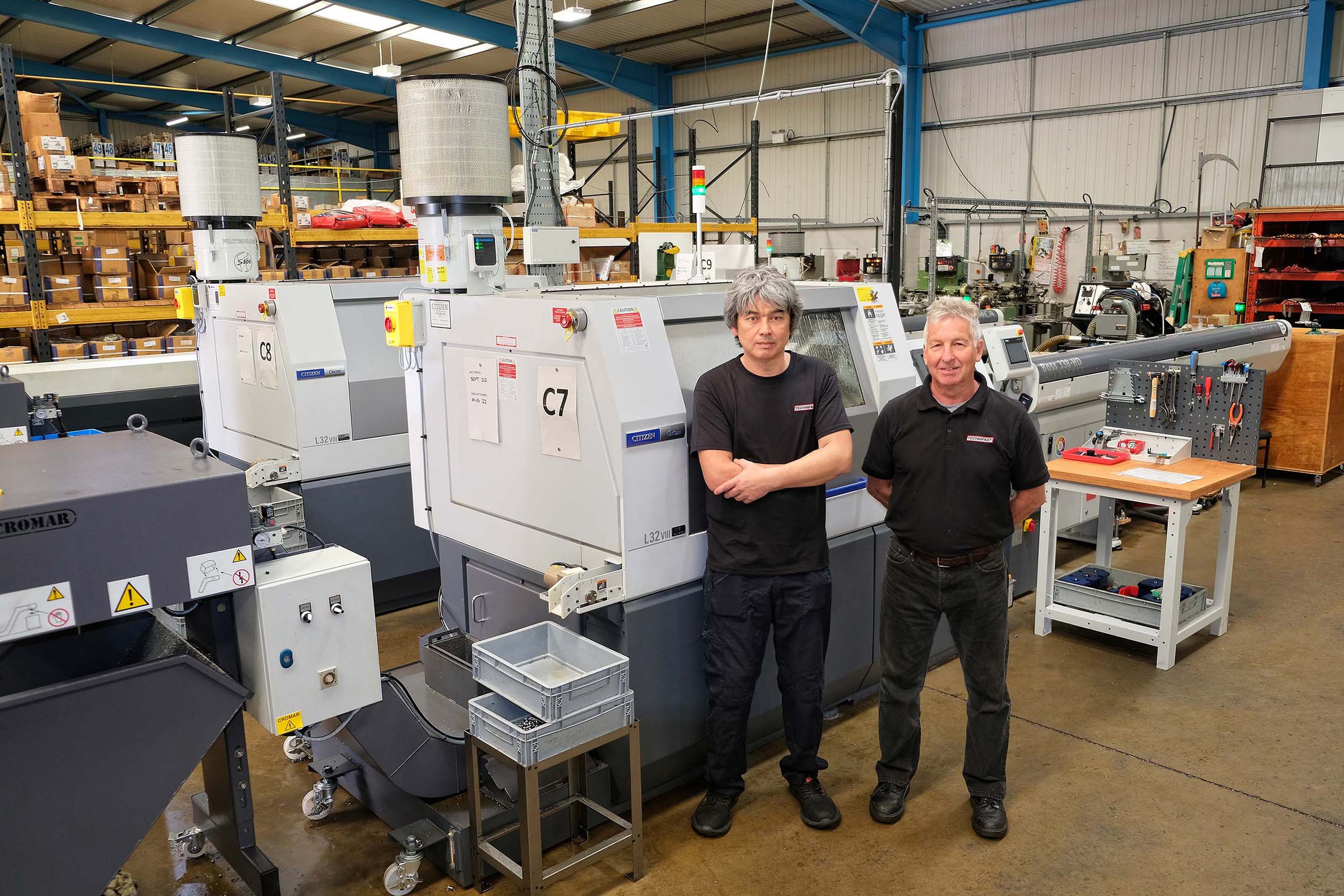

Fastener manufacturer and turned parts subcontractor Technifast has transformed its business over the past three years, doubling the turnover generated by production of parts at its Corby factory to £120,000 per month. That is despite the company employing two fewer people, now three including managing director Louis Speed, rather than five. Much of the increased business on the subcontract side, which accounts for half of turnover, comes from existing customers impressed at the high quality components produced on nine Citizen Cincom sliding-head turning centres.

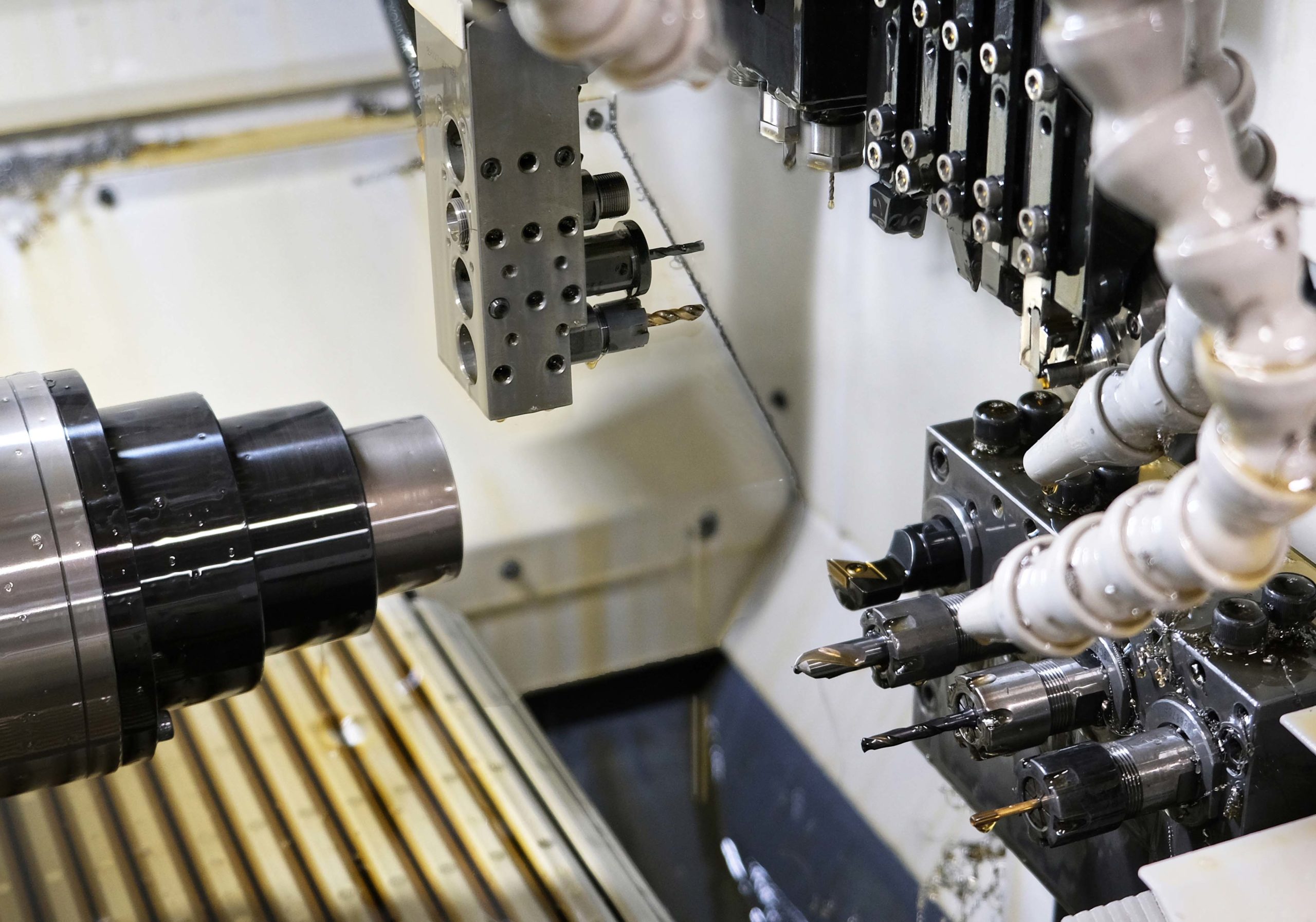

Not only is turnover up but profitability has also increased. It is largely down to lights-out running made possible by the latest, modern, 32 mm bar capacity Cincom lathes, two (soon to be three) of which are equipped with swarf conveyors and LFV (low frequency vibration) software. The latter allows reliable, uninterrupted, unattended running, as it is not necessary to stop the machines to clear away stringy swarf that can damage components and shorten tool life.

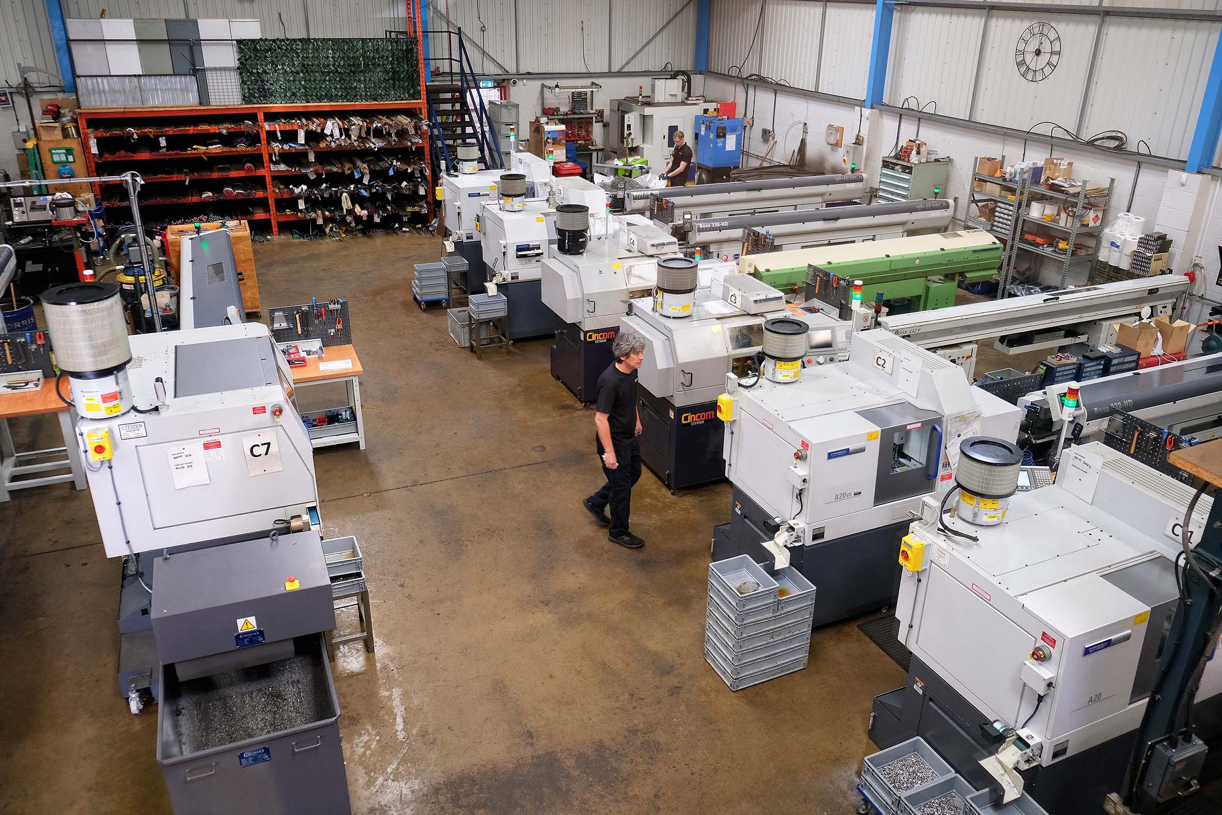

More efficient turning is only part of the story, however. Many other production aids have been introduced under Mr Speed’s ongoing initiative ‘to make one improvement to the operation every day’. The last three years has seen investment not only in six new Cincoms, the final one due to arrive in March 2023, but a host of other equipment as well.
It includes Keyence non-contact measurement for first-off inspection, a burnishing machine from Cogsdill, three extra Escomatic coil-fed lathes to bring the number on site to seven (mainly used for turning simple, tight-tolerance stainless steel pins), a Sharmic vibratory bowl finishing machine filled with maize for polishing components, and a workstation positioned by every Cincom on the shop floor. They keep in one place everything required to set the sliding-head lathes and inspect the parts coming off them.

Mr Speed said, “LFV is able to fragment long strands of swarf into shorter chips, avoiding entanglement in the cutting zone and preventing clogging of the working area. It is especially effective when turning, grooving, parting and drilling certain materials like stainless steel and plastics, which tend to generate stringy swarf.
“Even mild steel previously caused problems. For example, drilling spacers could not be left to run overnight due to difficulty with swarf accumulation. Now we have no problems with lights-out running. When producing parts requiring a short cycle time, the bar magazine has run out by the time we arrive the next morning.”
He added that when turning some simpler parts, such as dowel pins, LFV is not needed and is omitted from the program. It avoids the small reduction in productivity resulting from the short periods of air cutting when the tool oscillates away from the bar surface to break the chips. For the same reason, the function is turned off by G-code within a program if it is not needed for any particular operations.

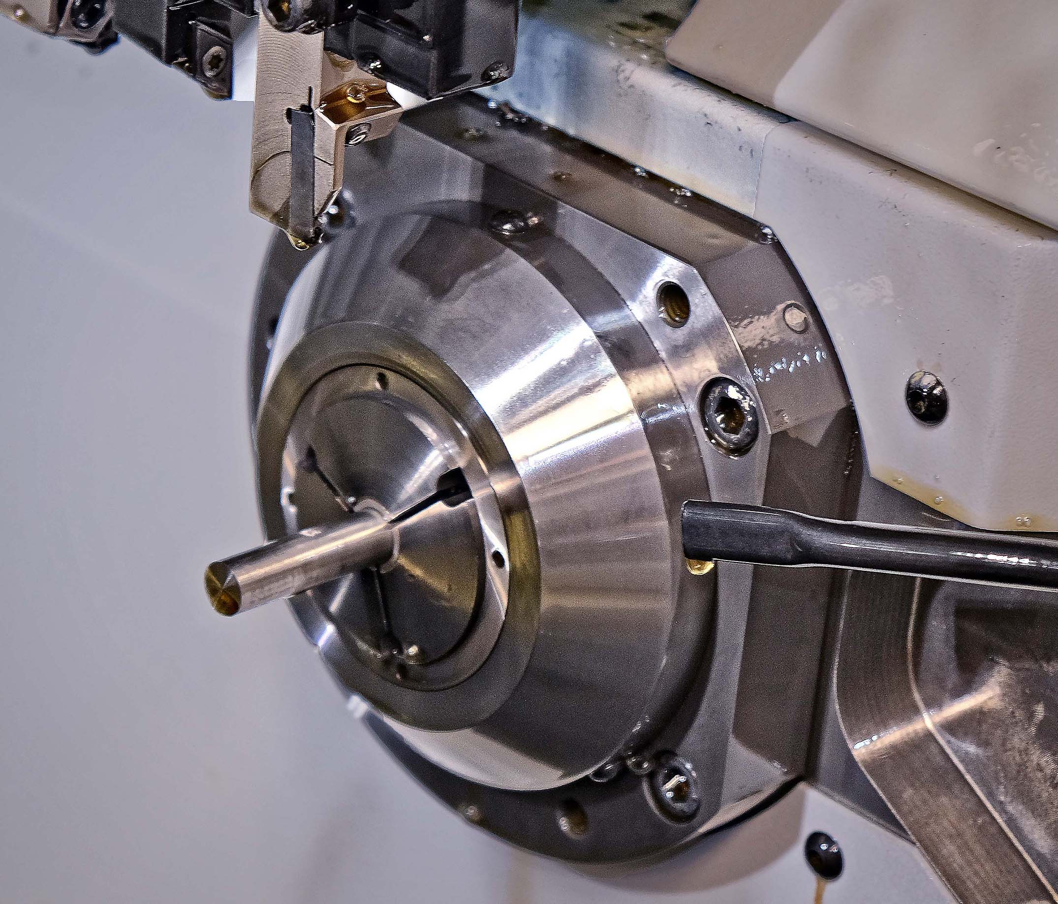

Guide bush-less (GBL) operation for economical production of shorter parts
The first thing Mr Speed noticed about the new generation of L32s is, as with the 20 mm lathes, how much quicker they are to set than the model he bought second-hand in 2007, which was built in 1999. A further advantage is that the Iemca Boss bar magazine feeding the latest lathes can comfortably handle stock down to 6 mm diameter with the requisite guide channel, whereas with the earlier L32 it was not feasible to process bar of even double that diameter.

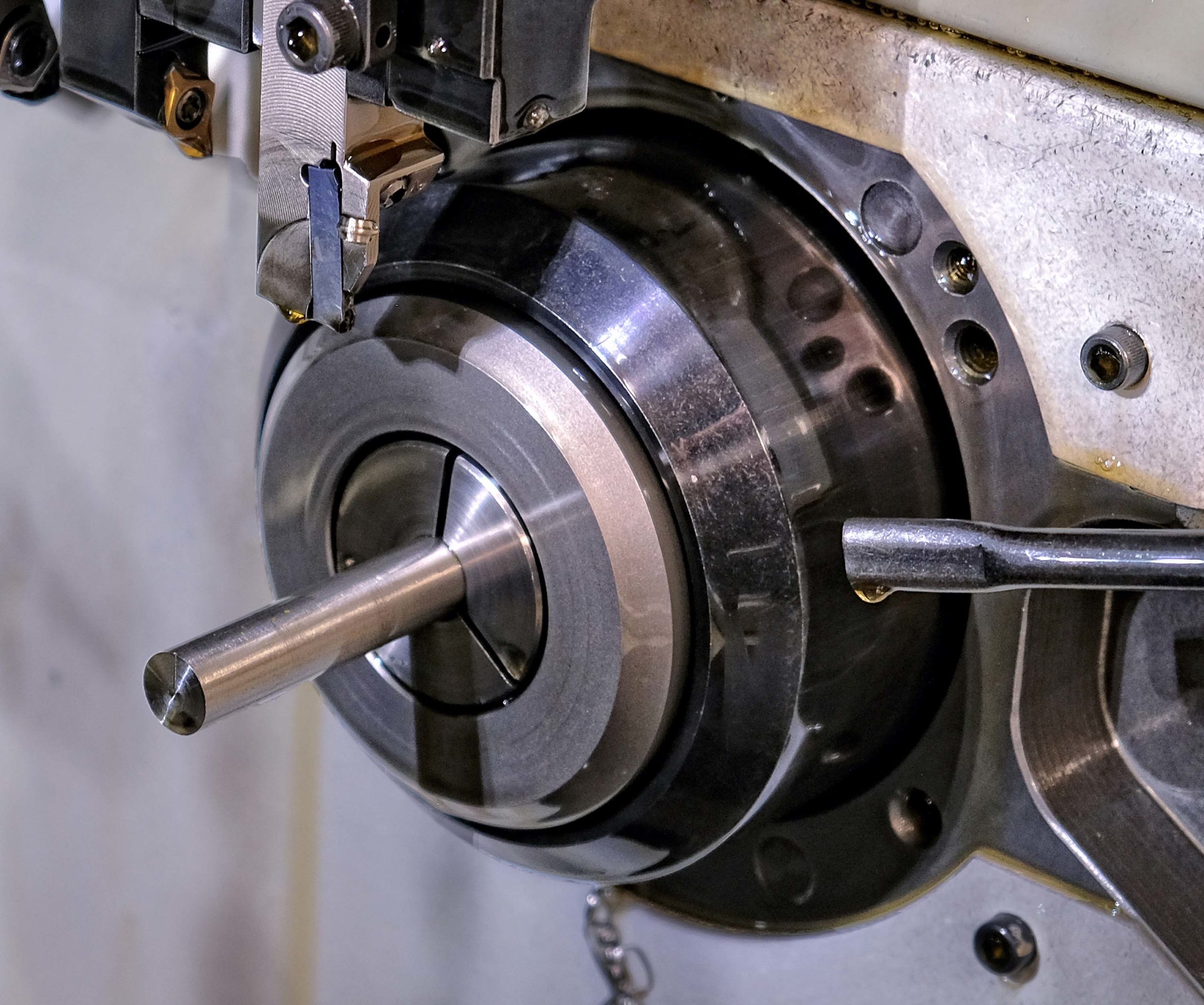

The second aspect of the new design that he exploited straight away was the ability to remove the guide bush for more economical production of parts with short length-to-diameter ratios up to approximately 2.5 to 1. In fact, after the first new L32-VIIILFV arrived, he swapped the guide bush in and out a couple of times in the first six months, then took it out permanently. One benefit is that the quality and dimension of the bar are not so important, as it is gripped in a collet while the headstock moves in and out of the machining area, rather than the bar sliding through the guide bush insert.
It means that the expense of buying various bush inserts to accommodate different stock diameters is avoided, and less expensive bar can be purchased. The cost of having a standard insert sparked out if a bar delivery is oversize is also saved, which Mr Speed says typically costs an extra £150 for a 20 mm capacity slider and £250 for a 32 mm machine. A further financial gain is that the remnant length when GBL turning is three to four times shorter than when sliding-head turning, so less bar is wasted.
As this L32-VIIILFV had become a permanent GBL lathe, the second model installed adjacent to it has its guide bush kept in place all the time for sliding-head turning of shaft-type components. The first machine was supplied with an expansion kit to enable the nominal 32 mm bar size to be increased to 38 mm in fixed-head mode, providing greater versatility. It was unnecessary to order the second lathe with the bar conversion option, since it cannot be used for sliding-head turning.
