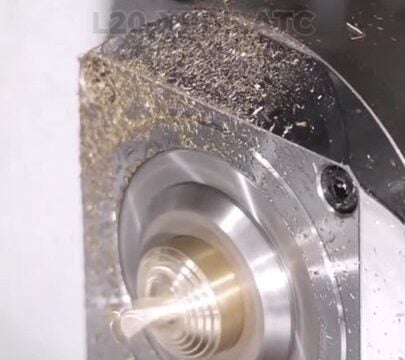

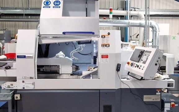

For machining parts from bar up to 20 mm in diameter (optionally 25 mm), a third generation of the Cincom L20-LFV series of sliding-head lathes with a considerably uprated specification has been launched by Citizen Machinery UK. Now offered in five variants, VIII, IX, X, XII and XIIB5, it is a best-selling model with platen tooling as well as front and rear tool posts, all stations having driven and static positions on the top three models, which also have additional Y-axis movement of the sub spindle.
Simultaneous 5-axis control for performing complex machining cycles is supported on the top two models, one of which has a B-axis tool post with optional ATC (automatic tool change) for tools up to 30 mm in diameter, chip-to-chip time being four seconds. Cutters are driven by a 2.2 kW motor at up to 12,000 rpm, so even small diameter mills are capable of productive metal removal rates. The additional programmable B-axis motion raises the total number of CNC axes to seven.
The Japanese manufacturer was the first to offer B-axis ATC on a sliding-head lathe to extend the machine’s versatility when executing angled cross working or end facing operations. The magazine accommodates 12 tools, while a 13th is fixed in the upper position on the live tool unit. While cutters are normally rotating for performing drilling, slitting, hobbing or multi-axis milling, either axially, radially or at a compound angle, magazine positions may be occupied by turning tools if expedient.

Access to the machining area has been improved, as the front door may now be fully opened and an extra door has been provided at the rear. Internally, units have been made as compact as possible and the coolant nozzles have been rearranged to improve efficiency during setup. Another improvement has been to upgrade the capability of the sub spindle, which is now rated at 3.7 kW / 10,000 rpm. Numerous robotic loading and unloading systems for automated storage and handling of raw material and finished workpieces are available.
