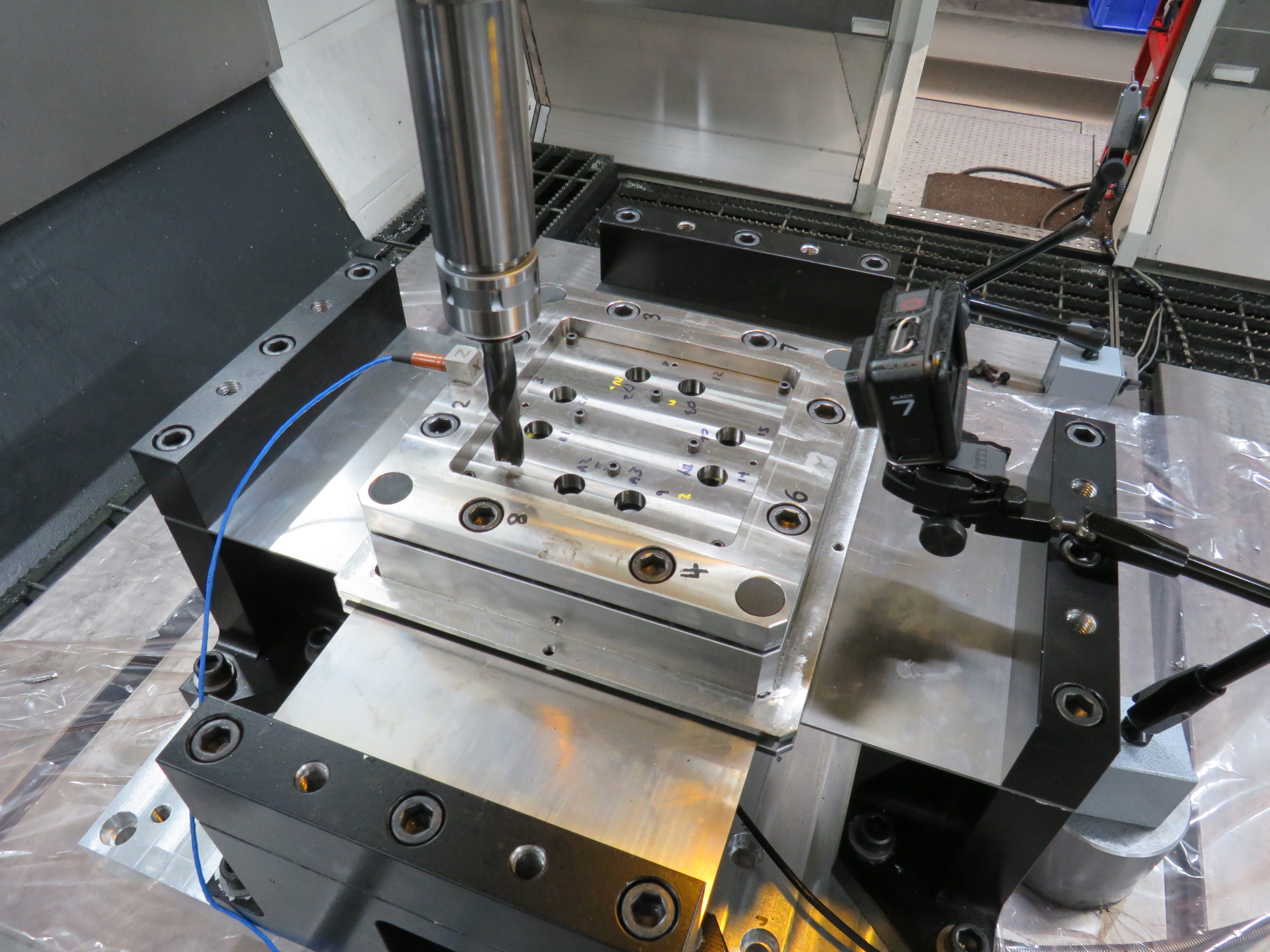

Following on from previous research undertaken by the OWA team, the latest OWAST project has a solid foundation block that sees some of the technology themes comparable for OWAST to commence at TRL3. The team has developed a prototype test rig that is currently being used in drilling trials and characterised for comparison against dynamic models and tap test data from aircraft assemblies. The next stage will be to demonstrate the ability to drill stacks on the aforementioned four industrially representative machine platforms with the rig dynamics adjusted to mimic dynamic behaviour of aerospace assemblies – like an aeroplane wing.
When the test rig is proven to comfortably replicate field conditions, the next stage will be to demonstrate in-cycle process monitoring feature extraction. The OWA team has already demonstrated its database and interrogation software architecture, and integrated process monitoring with the OWAST test rig (TRL2). To represent aero assemblies in a production environment, the dynamics of the rig have to be tuneable in terms of mass, stiffness and damping, requiring incorporation of multiple sensors to capture in process cutting forces, acoustic emissions and acceleration. Downstream from this, the team has to capture this data and establish a standardised inspection, analysis and reporting system.
