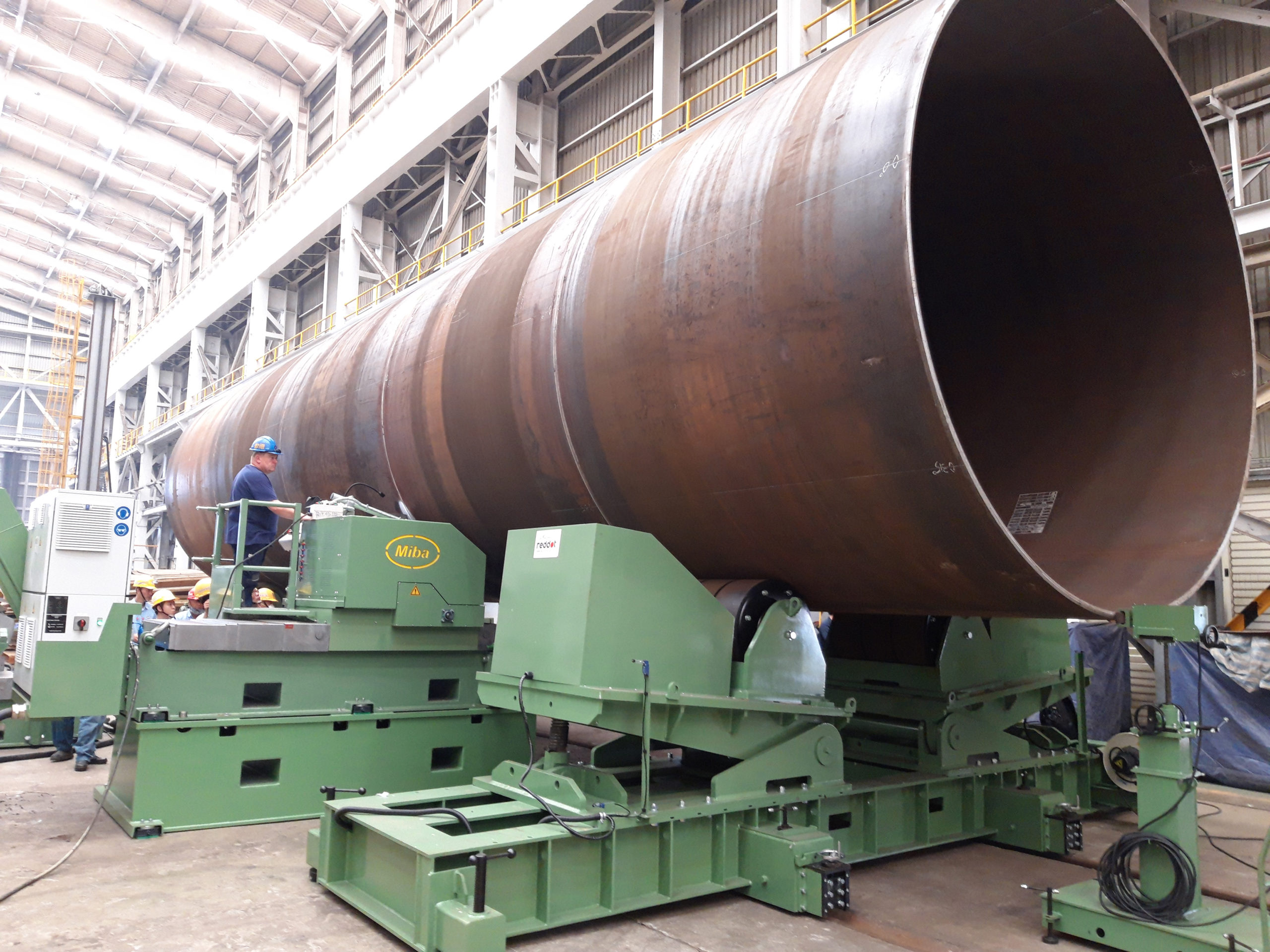

With the tube structure formed and seam milled, it is then transferred to the next station – the SAW triple arc welding process. The triple arc system has a deposition rate of 70kg/hour that is more than 80% faster at welding external diameters and 79% more efficient on internal diameters. This is a credit to a deposition rate that is 311% higher than tandem arc alternatives. This is once again credit to the Wave Form Control (WFC) of the Power Wave inverter technology, the multiple SAW process that can accommodate up to four long stick out effect arc welds simultaneously on one pipe section and the electrode feeding system. In synergy with electrode feeding is the continuous provision of a powder-protective shield for the arc weld process that permits exceptionally fast welding of deep cavities.
