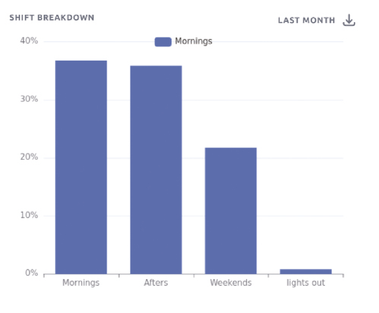

Availability is really easy to calculate, either by hand or with machine monitoring. It is even shown as ‘pride of place’ in a dashboard on a TrackMyMachines dashboard that I work with.

Instead, a less rigid approach is needed that considers the needs of the business and its engineering capabilities. Rather than just observing a simplistic metric, try to follow the manufacturing thread for a component or batch of components clocked into and out of each work order operation. Find out how much time that operation spent doing useful work (probing, cutting etc), semi-useful work (work setting, tool changing) and non-useful work (machine sitting idle). You might be surprised to find that during that 3-hour operation, the machine only spent 50 minutes doing useful work! Regardless of how your costs are calculated: either by person-hours, machine hours or a combination; There are savings to be made by investigating and improving this dead machine time.
It’s the closing of the loop between expected machining time and actual machining time that’s going to supercharge your growth as a business. Although this investigative work by hand is certainly possible, it really can be time-consuming. An automated machine monitoring system makes this information transparent and easy to build a clear picture of what is happening on your shop floor.
