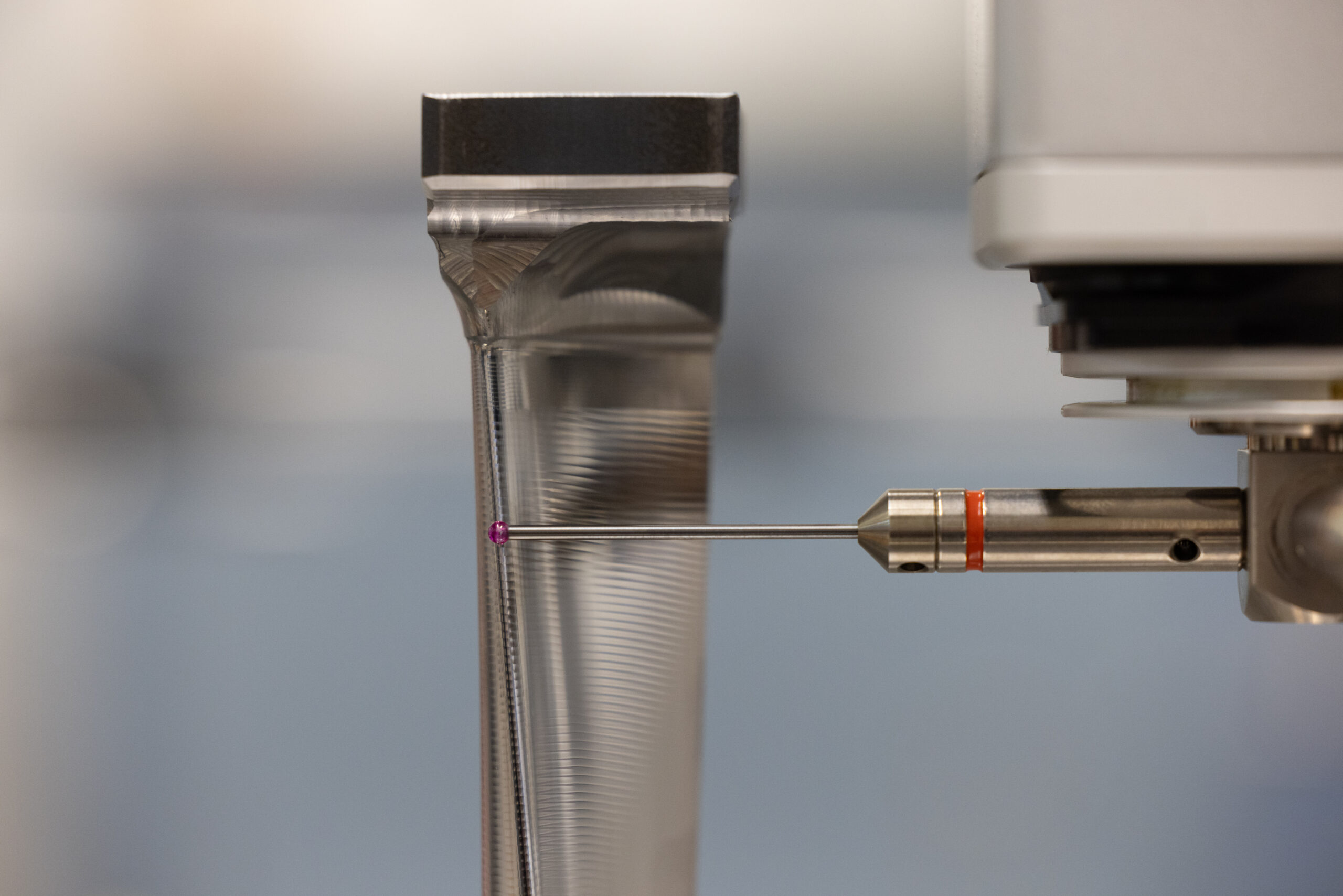

Roland Ziltener, who was Head of Quality Management at Starrag says: “We had a look at the machine and were immediately impressed.” To check whether the new development delivers the required precision despite the considerable optimisation of the measuring time, all turbine blades manufactured by Starrag on behalf of partner customers were measured with the ZEISS PRISMO fortis over 18 months. As the size, material and geometry of the turbine blades are different, the machine was “widely tested”, according to Ziltener. To evaluate the accuracy of the ZEISS PRISMO fortis, the measurement results were compared with reference values from the ZEISS PRISMO navigator.
During the pilot phase, Ziltener and Nytsch agreed that Starrag and ZEISS worked closely together. For example, the measurement data was discussed together in regular meetings. ZEISS used this information to optimise further the start-up and acceleration behaviour of the rotary table and the machine. ZEISS also simplified the usability of the machine and the creation of test plans during the pilot phase.
Turbine blades and blisks are not only subject to stringent requirements but also cost companies a lot of money. Experience has shown that quality assurance accounts for 20% of total production costs and 25% of total production time. The pilot project showed that productivity in the measurement of turbine blades can be significantly increased with ZEISS PRISMO fortis. The standard measurement, which took four minutes and 30 seconds at Starrag and delivered accurate and reproducible results, was reduced to 70 seconds during the pilot phase. This saves time, “which gives us greater flexibility in the selection of parameters and workpieces to be measured and helps us to optimise our production processes,” emphasises Ziltener.
