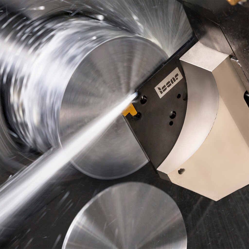

Fast Feed Turning Tools (Fig.1)
l High Feed Rates: These tools enable increased feed rates, thereby reducing machining cycle times.
l Durable Materials: Constructed from high-quality materials to withstand high-speed machining conditions.
l Precision Cutting: Engineered for accuracy, ensuring precise cuts with minimal tool wear.
l Versatility: Suitable for a variety of materials and applications, offering great flexibility.

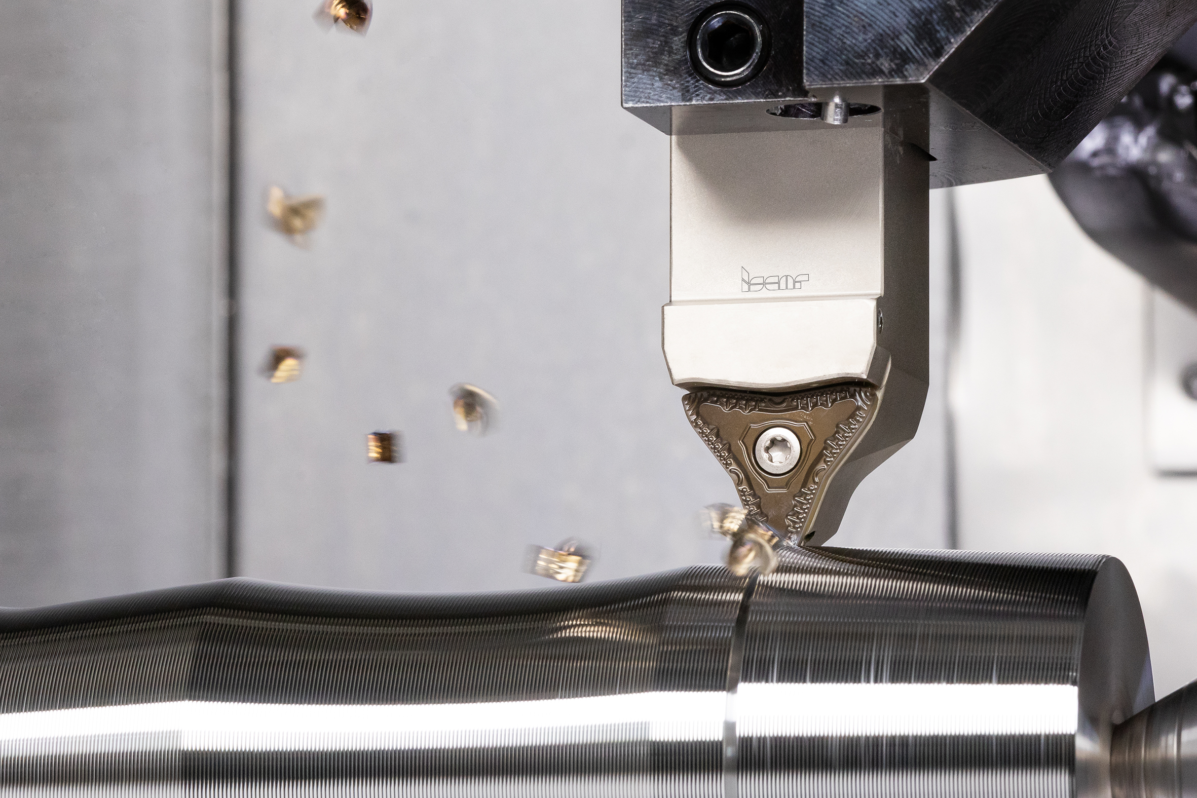

Fast Feed Grooving and Parting Tools (Fig.2)
l High-Speed Performance: Designed to perform at high speeds, improving the overall efficiency of grooving operations.
l Reduced Cycle Times: High feed capabilities allow for quicker material removal, reducing overall cycle times.
l Enhanced Tool Life: Made from durable materials that extend the life of the tool, even under demanding conditions.
l Consistent Quality: Ensures consistent performance and high-quality results in various grooving applications.

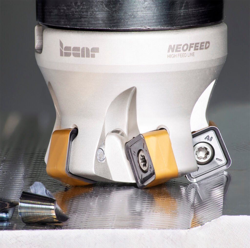

ISCAR also provides an extensive range of fast feed milling tools designed to significantly increase efficiency and productivity. These tools are specifically engineered to deliver high material removal rates and reduce cycle times in various milling operations. Fast feed (FF) milling cutters are a key factor in high feed milling (HFM) techniques. The cutter geometry, designed for efficient chip thinning, must ensure the correct distribution of the cutting force.
There are two principal geometrical approaches. The first design requires the cutting edge of an FF milling cutter to be an arc of a circle. Another concept is based on using one or two straight edges that are chords of the arc. In both cases, the small cutting edge angle (usually 9-17°) meets the requirements of chip thinning and decreasing the total bending load on a tool.
Ensuring the geometry of solid carbide fast feed endmills and replaceable milling heads demands the specific shape of a cutting edge, while in indexable milling, it may be provided by the appropriate location of an insert of even a simple profile.
Although the introduction of innovative grades and advances in chip forming rake faces have improved progress in FF milling cutters, the essential element, the geometry, remains constant. If the cutting edge of an FF milling cutter is the arc of a circle (or the chords that approximate the arc), the cutting edge angle of the cutter is not a constant value but varies depending on the axial depth of cut from 0 to the mentioned 9-17°. In milling, the chip thickness is a function of the tool’s cutting edge angle. Under the same conditions, the smaller the cutting edge angle, the thinner the chip. Therefore, the programmed feed should be increased correspondingly to produce chips of the required thickness.
Features of ISCAR Fast Feed Milling Tools (fig.3)
l High Feed Rates: These tools are designed to operate at high feed rates, allowing for faster machining processes and reduced cycle times.
l Durable Structure: Made from high-quality materials that ensure durability and long tool life, even under demanding conditions.
l Precision and Stability: It is engineered to provide precise and stable cuts, minimise tool wear, and improve the quality of the finished product.
l Versatile Applications: It is suitable for a wide range of materials and applications and offers great flexibility in use.
l Innovative Design: It incorporates advanced geometries and coatings to enhance performance and chip evacuation, reduce heat generation, and increase tool life.
Popular Product Families
l HELI-6-FEED: Known for its double-sided indexable inserts, offering high feed rates and excellent performance in various milling applications.
l NEOFEED: Specifically designed for high feed milling, these tools carry cost-beneficial double-sided square inserts with 8 indexable cutting edges, providing outstanding material removal rates.
l MULTI-MASTER: This modular system with interchangeable heads allows for quick and easy tool changes, enhancing productivity and reducing downtime.
