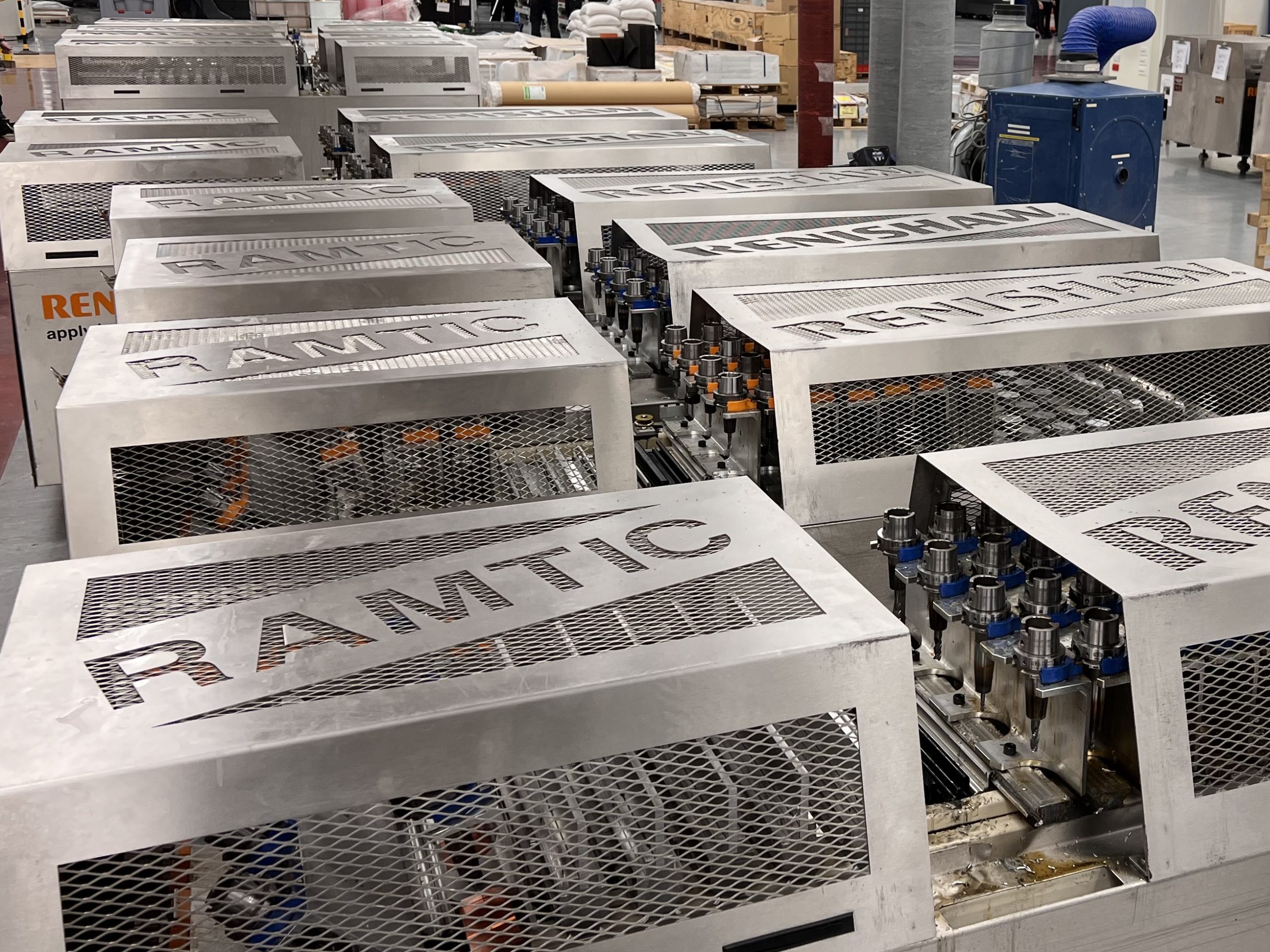

RAMTIC is a unique automation system developed specially by Renishaw for their own production needs. The creative solution enables Renishaw staff to firstly pre-set all the cutting tools and raw materials for a product ‘kit’ into fixtures away from the machining centres. The tools and fixtures are loaded onto a unique mobile pallet system called a carousel. This is then transported to an available machining centre and docked in position. Once connected and information loaded into the machine there is no further manual intervention. We’ll look more at this fantastic innovation in more detail in a future issue.
Adding to this, Jonathan says: “We move the RAMTIC carousel to the machine once it’s been kitted offline with tools and material. Swapping these carousels over at the machine takes only half an hour, so we then machine in sequence, multiple part numbers or discrete operations using up to 50 pre-kitted fixtures, these product carousels run for between 15 to 30 hours. All the machine set up, tool set up, process control and verification are carried out without manual intervention, This not only enables significant lights-out machining but also smaller batch sizes matching assembly demand.”
