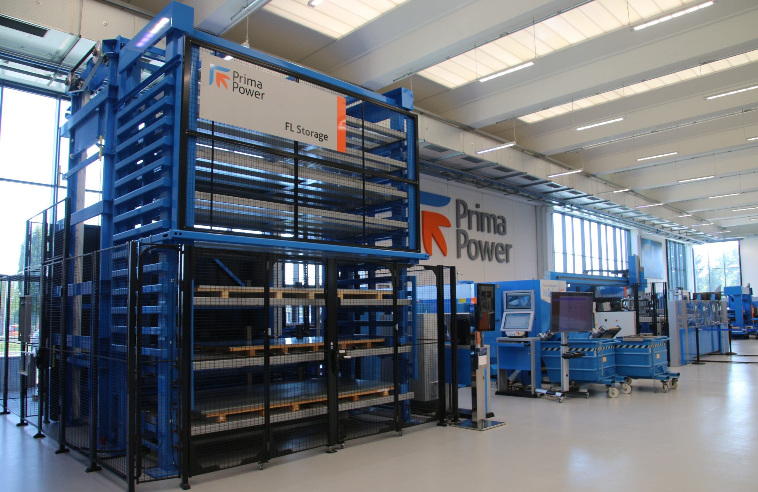

During our visit, we toured the HQTC – a facility that is home to the very latest technology the company has to offer. Not just a showroom, this innovation centre is also a test and demonstration facility where manufacturers from all sectors ‘prove-out’ and optimise their projects, finding the complete solution to their production issues. At the time of the trip, the HQTC presented a diverse range of technologies that included the Laser Next 2141 3D Fiber Laser, the Laser Genius+ 1530 2D Fiber Laser, the Print Sharp 150 powder bed fusion additive machine, the BCe Sharp Panel Bender, the eP-1030 Genius Press Brake and the jaw-dropping PSBB (Punch, Shear, Buffer, Bend). For engineers that cannot afford the time to make a trip to Turin, live video feeds of demonstrations and trials can be undertaken….although such an impressive facility is definitely worth the visit.

With so much to see, it is impossible to discuss the HQTC and the machines within in the detail they deserve – but thankfully you can watch the MTD videos online. Starting with the eP-1030 Genius Press Brake, the 3m 105-tonne machine is the epitome of bringing technology and automation to what has long been a manual process. The O-frame machine with dual-servos provides an even distribution of bend force whilst the Genius element provides tool storage and automatic tool changeovers that make set-ups and changeovers an extremely fast and efficient step. The tool carousel stores 32m of tools, something that can be connected to two machines to reduce floor area, improve automation and create production autonomy. With worldwide skills shortages, power consumption and environmental considerations at the forefront of most business concerns – the eP-1030 ticks all the boxes with its low energy, low maintenance and simplified operation.
Alongside the eP-1030 was the BCe Sharp Panel Bender, a step further into the world of automation with the facility to manually or automatically load/unload sheets. With a control that allows parts to be processed individually, in batches or as kits, the sophistication of the Prima Power TULUS software suite makes programming, simulation, scheduling and storage a breeze for operators of the latest machine in the range.
