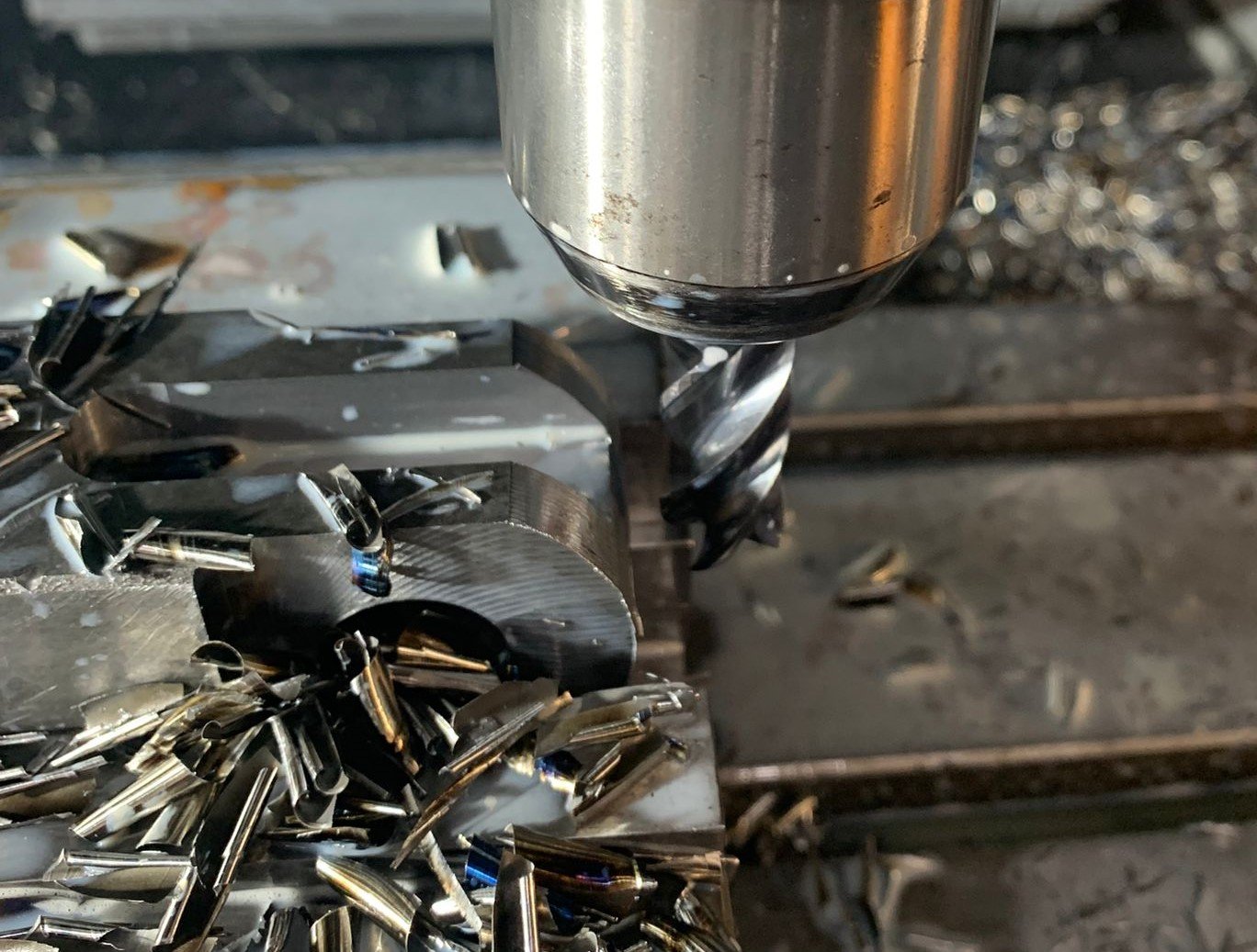

ITC proved its value when trialling tools on clevis connector components for the rail industry. The company machines over 1000 clevis components from EN8 steel each month on its large bed Hurco machining centre. With a cycle time of 30 minutes per part, ITC’s Chris Fairbrother initially introduced the Widia VariMill Xtreme solid carbide end mill for machining an 18mm wide slot. By combining the Widia VariMill Xtreme and BIG KAISER back-ends, the 45mm deep slot was machined in four passes with a DOC of 11.25mm at 175m/min spindle speed and 0.06mm feed per tooth. Producing two slots per part, the Widia VariMill Xtreme extended tool life from 40 parts to 120 parts whilst slashing cycle times from 30 minutes to 12 minutes.
