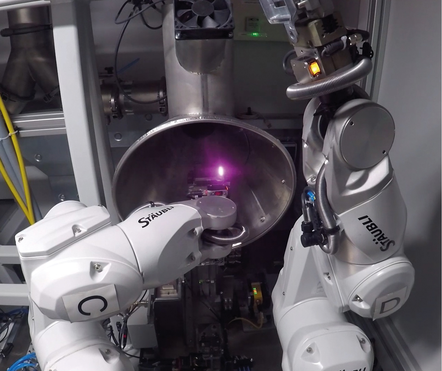

In this specific case, Hämmerl was responsible for implementing a new laser cleaning process that is intended to prepare die-cast surfaces for subsequent bonding to the electronics housing of a NOx exhaust gas sensor. The surface produced by laser, has an influence on the durability of the bonding, and 3D measurement technology should help to ensure the long-term function of the sensor in-vehicle operation. In the search for the right measuring method in this newly introduced process, it became apparent there were no suitable measurement methods known for use in production. Eventually, the company found what they were looking for in a Bruker Alicona 3D measuring device with its 3D depth measurement that offers a surface classification software to automatically distinguish between ‘OK’ and ‘not OK’ surfaces.

Even minimal fluctuations in laser processing lead to the smallest changes in the micro surface quality of a die-cast surface. These can have a critical influence on the durability of bonding. In the evaluation of various measuring devices, great importance was therefore attached to the ability to detect even very small differences in roughness. In this way, it can be verified whether specified tolerances are maintained even if process changes are made. Conventional profile-based methods could not sufficiently quantify the specific roughness of the die-cast surface, so Vitesco switched to optical metrology for this application and today uses Bruker Alicona’s technology in series production. The InfiniteFocusSL measuring system detects even the smallest differences in the roughness of the laser-treated die casting surface. Therefore, deviations in the laser cleaning process can be detected quickly and it is possible to react promptly with system parameter adjustments.
