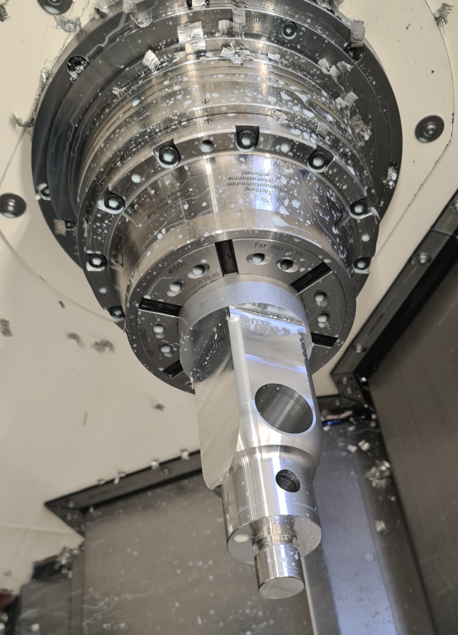

Reviewing the marketplace, the solution was to invest in a manufacturing cell with a DMG MORI CTX beta 1250TC turning centre at the heart of it. The cell with the DMG integrated Automation Station provides robot loading and unloading as well as a tray for storing billets and finished parts whilst a barfeed sits at the rear of the machine for parts that are suited to barfeeding. This immediately resolved the situation, taking the process from six operations to one.
Commenting up the purchase of the DMG MORI cell and the situation that instigated the purchase, Milturn’s Development Engineer, Mr Daniel Rushton says: “The long-term customer has a consistent order for the 60 Cine lens components per month, which is part of circa 2500 parts produced monthly for them. As a complex part with six operations on various machines, this extra demand was absorbing more of our capacity and time – we approached a number of machine tool vendors, but DMG MORI were the one that stepped up with the perfect solution. We supplied DMG MORI with billets, drawings and our requirements and they engineered a fully automated solution.”
The DMG MORI CTX beta 1250TC turning centre incorporates a powerful yet compact 20,000rpm HSK milling spindle, linear scales, an 80-tool carousel, liquid-cooled spindles and axes plus 1470mm between centres. The entire cell also incorporates the DMG MORI robotic loading and unloading station, a Hydrafeed barfeeding system and a 5S lean manufacturing environment from Hoffmann that completes the cell. For those of us less familiar with the acronyms and methodologies, 5S incorporates five core steps – sort, set in order, shine, standardise and sustain. Inside the work area resides a SMW chuck with gripper jaws on the main spindle for clamping billets. The DMG MORI robot transfers parts from op one on the main spindle to op two on the sub-spindle where a Hainbuch expanding mandrel clamps the internal diameter for finish machining. Milturn has even invested in the Hirt-Line series of coolant hoses from Floyd Automatic Tooling that are manufactured from stainless steel, proving extremely rigid and robust for ‘lights-out’ production.
The new cell has only been installed for a matter of months, but it has proven transformative for the Hinckley based business. In the first 8-weeks since the DMG MORI turn/mill solution arrived, Milturn had not changed its finishing inserts in its cutting tools. This was down to several factors. Firstly, Milturn had opted to change its cutting tool supplier to Hoffmann with the cutting tool integrator providing all cutting tools for the lens project. Secondly, the process stability of the DMG MORI machine with rigid toolholding set-ups provides the platform for improved machining performance.
Highlighting this, Daniel continues: “The DMG machine allows us to approach each process differently. For example, with a more stable set-up, we can threadmill the 30 holes that are either M1.6 or M2 in each lens part without breaking a tap. Previously, we would break a tap on every batch of parts and it was easier to scrap the part than spark EDM the broken tap from the part, re-set and re-machine it. From a general tooling perspective, we can only hit particular features of the lens part so hard, as much of the machining is around thin-wall areas. On finishing cycles the tool life has increased hugely – in fact, some of our finish turning inserts had not been turned around in the first couple of months of machining. Hoffmann has not only provided a complete suite of high-quality thread mills, drills, turning and milling tools – they also helped with the 5S system with storage solutions that makes every tool easily accessible for the operator.”
