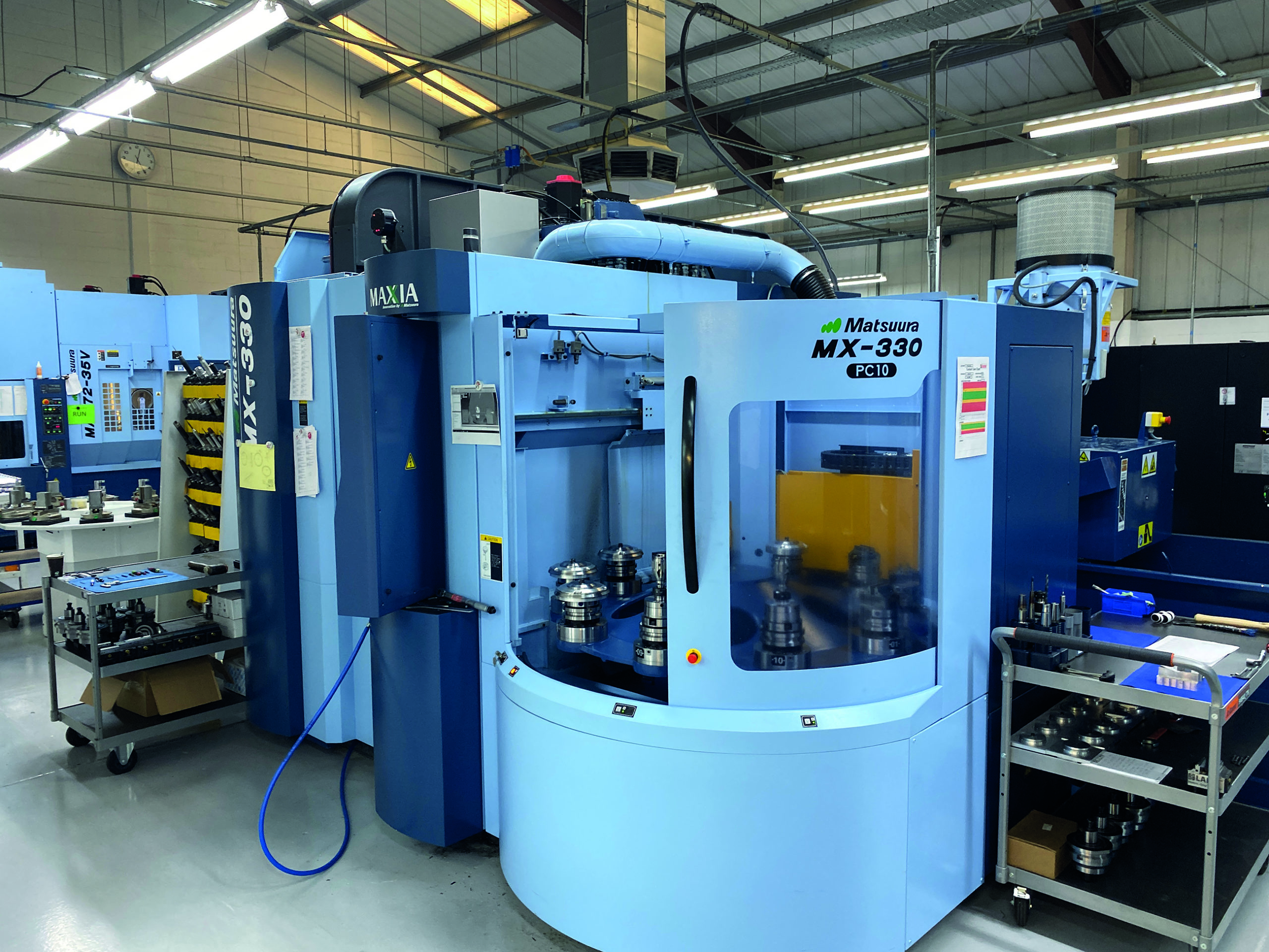

Why the MX330?
With the MAM72-35V machines being such a hit at MP Engineering, MTD magazine asked why the company opted for the MX330? Mr Poole continued: “The MX330 PC10 sits well within our business for our Formula One work. This is because with F1, we see much smaller batches than we do with aerospace work. The machine also has a much smaller footprint than the MAM72-35V, and we really are stretched for space.”
“The MX330 PC10 machines will run in the same fashion as the existing machines, we can even take a pallet from the MAM72-35V and drop it into one of the MX330’s. The machine has a smaller footprint and a lower price point, but you are not getting any less of a machine. The MX330 PC10 machines have the same intelligent software and systems that simplify around the clock running.”
Alluding to the ‘intelligence’ of the machines and the pallet selection process, MP Engineering’s, Ben Hayward told MTD: “We have a pallet manager on the CNC that identifies the pallet numbers and the schedule numbers, which allows you to change workflow. Finally, you have the option of the ‘reserve’ pallet whereby if you load a pallet, but you don’t want to run it at night, it will put it in reserve until you command otherwise. At the end of the working day, you can easily select the overnight running order of the pallets.”
When asked what would happen if a situation arose like a broken tool, Ben Hayward said: “This all depends on your individual set up. We have the machine set up, so if a tool breaks it stops the programme. You can configure it whereby if you get a broken tool, it will remove the pallet and put the next pallet in with the next job. The next job will subsequently run up to the point where it may need the broken tool. If subsequent jobs do not require that broken tool, then the parts will be completed.”
“There is also software that will monitor tool breakages, the ‘intelligence’ will tell the machine which tools are required for each pallet. From this, the machine will run pallets that do not require the broken tools.”
