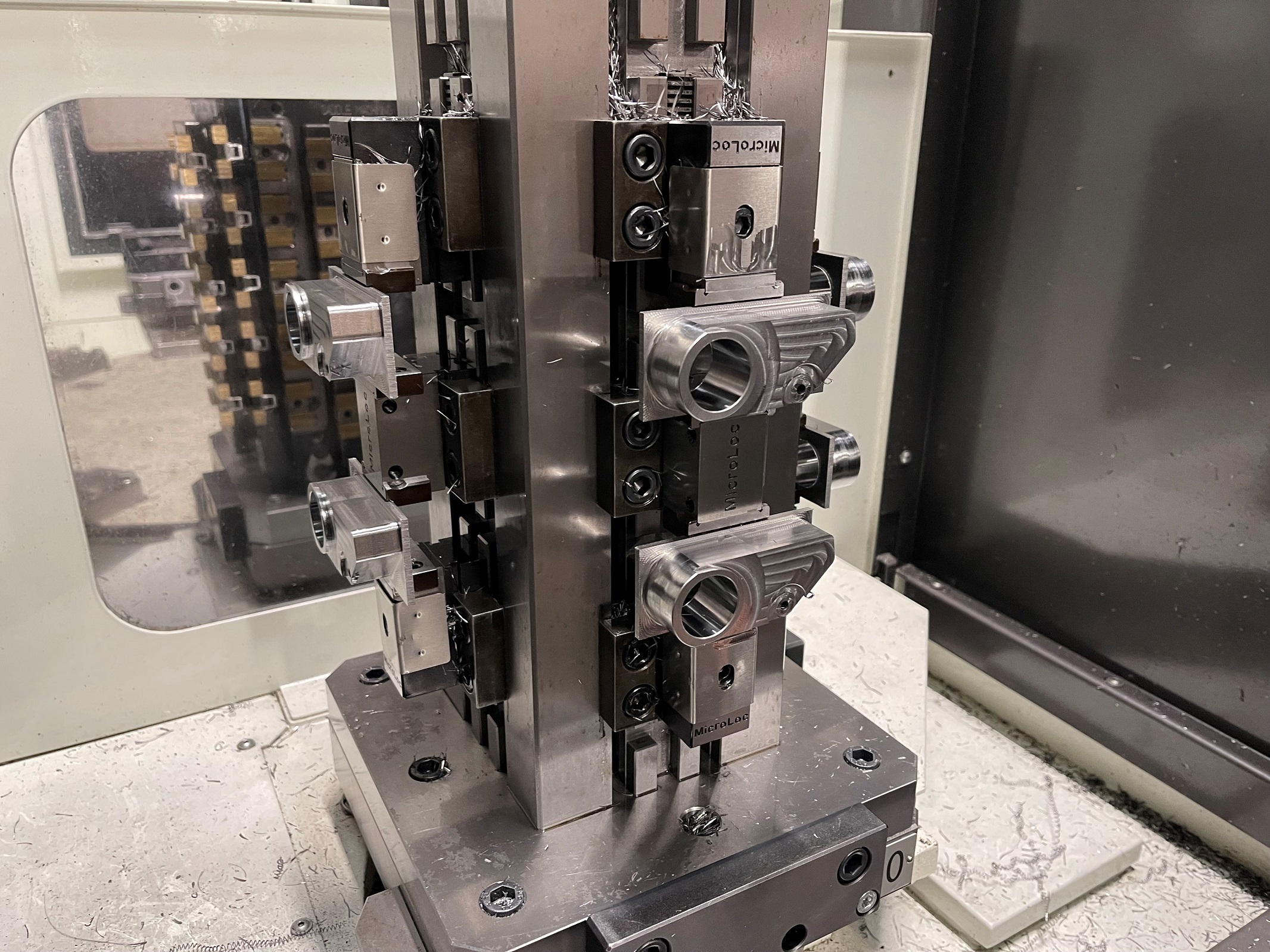

On a recent project to machine 400 mild steel latch components, Hi-Spec was having an issue holding a 9µm tolerance on a 26mm diameter bore that needed to be machined through a 25mm thick plate. Producing the parts on its 10-pallet Kitamura Mycenter HX250iG horizontal machining centre with a BT30 spindle taper from Dugard, the company was struggling to retain repeatability.
Hi-Spec Precision Engineering Ltd Managing Director, Mr Darren Grainger says: “We were having issues keeping tolerance. We tried two different brands of precision boring heads with a variety of cutting speeds and feeds, but the tolerance would deviate over a batch of eight parts on each tombstone. With a precise and robust workholding configuration on the Kitamura machine that is known to be the epitome of precision, we knew that the cutting tools and the tool set-up was the issue.”
The holemaking process included drilling the mild steel plates to 18mm diameter and then milling the bore to 24.9mm and subsequently applying a high-end boring head to achieve a diameter of 26mm that is tied to a 9µm tolerance.

“Steve visited our facility and checked the installation and proved out the speeds, feeds and accuracy. The first thing that stood out for us was the speeds and feeds of these tools. We are running the new Horn URMA system at 2200rpm with a surface speed of 180m/min and a feed rate of 2200mm/min. At these speeds, it is less than two seconds to ream and retract from the hole. The previous systems we tried was taking 18 seconds to feed in and out of the bore, so the Horn system is making an incredible cycle time saving for us.”
