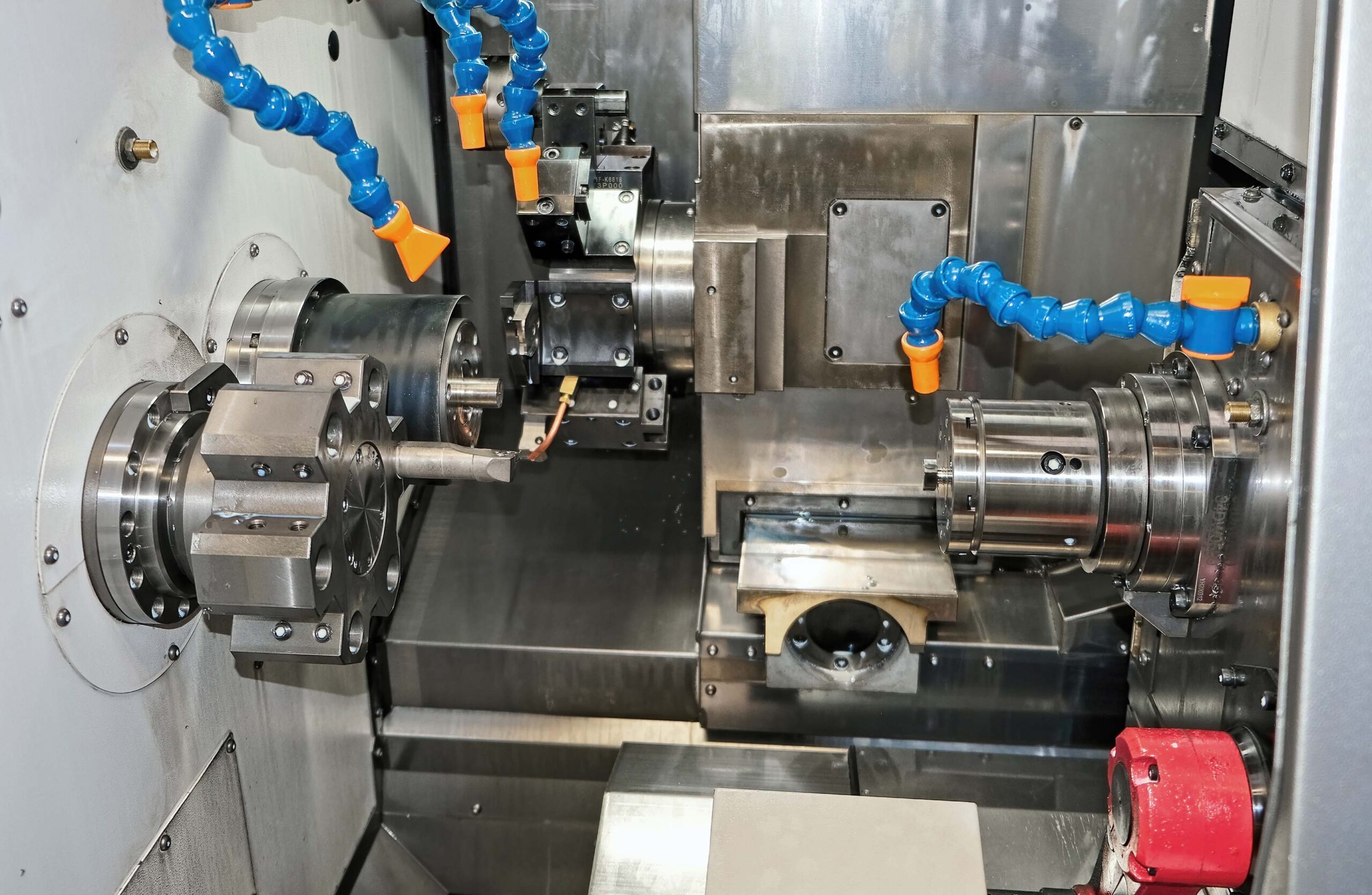

Two identical 7-axis Miyano BNA-42DHY twin-spindle, twin-turret, and bar-fed lathes were duly installed, the manufacturer’s first machines sourced from Citizen Machinery UK. The supplier was chosen after subcontractors within the fastener industry had been consulted, as well as Google, plus Citizen at one of its open houses. Demonstrations at the Brierley Hill Technical Centre, where faster than expected, one-hit cycles were shown to replace three or four separate operations successfully, clinched the deal.

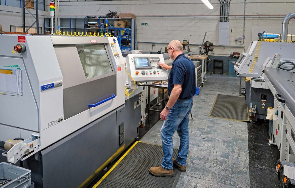

A few years later, SFC (Europe) was ready to revert to introducing sliding-head, bar-fed lathes. The Miyanos had performed so reliably in terms of uptime and accuracy that Mr Edmonds looked no further than Citizen for the supply of two Cincom L32-VIIILFV turn-mill centres. Delivered and commissioned in April 2024, they mainly fulfil orders for higher volumes of parts. As traceability is often essential, the ability to engrave them in-cycle on the fast, nimble machines saves a separate operation and contributes to maximising production output.
The nominally 32 mm bar capacity lathes can machine components from up to 38 mm bar with the guide bush removed, which saves material due to shorter remnant lengths. Accordingly, one L32 is permanently set up without the guide bush for producing parts up to about 2.5 times diameter, while the other has the guide bush in place for turning longer components.
